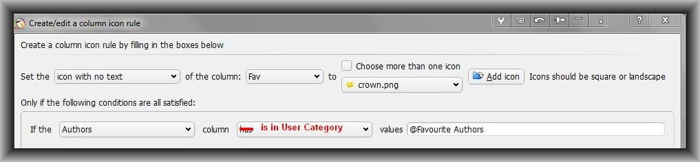

I have a problem:
I would like to add icons to show what I have in my user categories, but it's not possible at the moment. Do any of you have any ideas?
Thanks BR for the image:

I need some new help.
I would like to make a template (if you can) for adding an icon if there are more than 3 different fandoms connected to the same story.
I hope it's understandable.
Thanks
Old 09-13-2014, 08:36 AM   #85
Posts: 22,903
Karma: 34252744
I think the multi column icon feature may be what you want, I think it works something like this
in column whatever display if fandom contains Christmas,
in column whatever display if fandom contains Idea,
in column whatever display if fandom contains I am a fool
You would get displayed in whatever if all three were true,
You would displayed in whatever if only Christmas and I am a Fool were true.
But see Multi icon column selector - broken ? for Catch-22

Join Date: Jan 2014
I have seen your post. I'm waiting for someone to correct it Do you know if I can make a custom column based on a user category?
Old 09-13-2014, 09:21 AM   #87
Posts: 22,903
Karma: 34252744
What's wrong with my post? Did I use a banned word
That harks back to this problem
Seems that apart from thee and me no one had any ideas
I suspect both multi column icons and user categories are lesser used calibre features, hence integrating the two is not something many people would want to do.
