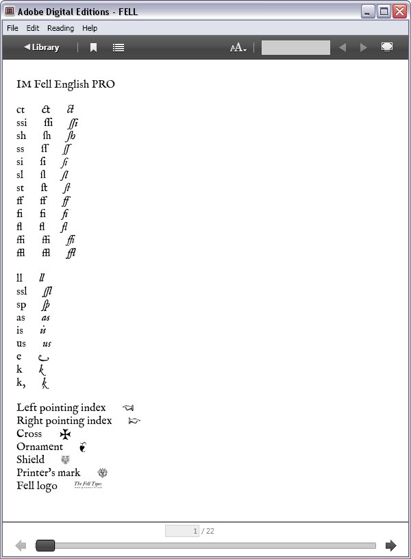

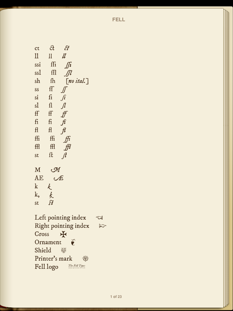

Well, I'll be damned. I forget which font I'd used in those previous screenshots, but in re-doing this I did so with that "English" font (which not only is the one that I think suits my text the best, but also has some nicer ligs/alts).
And, lo and behold, not only do all the various characters come out just fine in iBooks, but in ADE, too! Check out the screenshots here -- awesome! ))
Name:	Fell test - ADE.jpg
ID:	114601   Click image for larger version
Name:	Fell test - iBooks.png

Those shown in ADE are the ones defined by Unicode. If you could get the OpenType features to work in iBooks, I guess in ADE you'd see the same ligatures you see now, but not the other additional ones, and by not seeing I mean you'd see "ct" instead of the ct ligature, but not "Ã" or whatever. Surely that would be a more acceptable downgrade.
Well, you have me thinking/wondering... in those screenshots that I just loaded up, for each line I said what the ligature was supposed to represent, followed by the roman/italic versions of the actual ligature.
However, if I put in "ct" (as two letters, not a lig), then if what you say was actually working, shouldn't all those double-character combos (in the first "column") have been automatically changed to the ligature??? They don't, though, they stay as the two characters.
What I expect you can get is a single version, that works as you want in iBooks (and maybe others), and just okay in ADE.
Well, it would appear that I can do both, if I use that "English" font! I'm stunned -- and pleasantly, elatedly so -- that it apparently works just fine in ADE, including all the ligs!

I wish I could do the exact same thing with my "olde" text, but it doesn't seem that I can! The problem, I can only assume, is that none of the longer, "problematic" words simply aren't in the built-in English dictionary (for example, "diſſapoyntmends", etc.), and the software just has no idea where/how to break the words -- and so it doesn't.
One alternative that I did try -- instead of allowing hyphenation on certain words -- is to use the ­ method, but that doesn't seem to work either (neither in iBooks nor ADE), it's just simply ignored.
Anyone have another solution, for either selectively allowing hyphenation on certain words, or else to insert something similar to ­ within the words?
