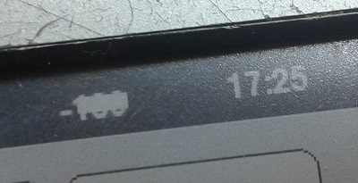

Hello!
Thanks eureka for your great work, that's exactly what I wanted!
I have a kindle Touch running FW 5.1.2 (as this is the last one that supports enabling TTS via JBPatch for all books)
But with this firmware the Current is displayed over the battery symbol (that somehow misses the white border??) I attached an example
I tried to play around with _batteryCurrentEl.style.paddingRight = "3pt"; in battery_current_indicator.sh that shifted the text somewhere, but not where I wanted it to be..
How can I move it to the left (or chage the colour to some sort of grey)?

Originally Posted by nick-tech View Post
hasn't anyone an idea how to fix this?
You're on the right track, just keep experimenting with _batteryCurrentEl.style properties. Google for css reference and javascript style object and try to add/use various combinations of properties and theirs' values. Also reference to files in /usr/share/webkit-1.0/pillow for original HTML and CSS defining status bar view. It will take time, but (generally speaking) that's how I did it
