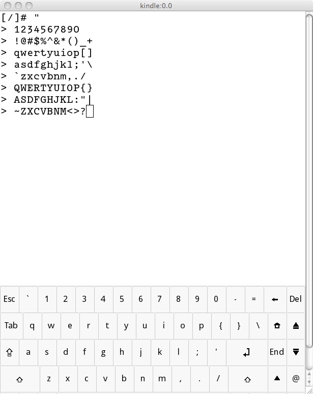

Okay. so easy test:
Type 1234567890 and qwertyuiop[]#';lkjhgfdsa`zxcvbnm,./
With and Without SHIFT down...
Pictured....
I did similar test: x11vnc on kindle, Chicken VNC client. Everything works ok. I don't think it is a kterm issue. Something goes wrong on the way. Anyway you have already found a solution.
