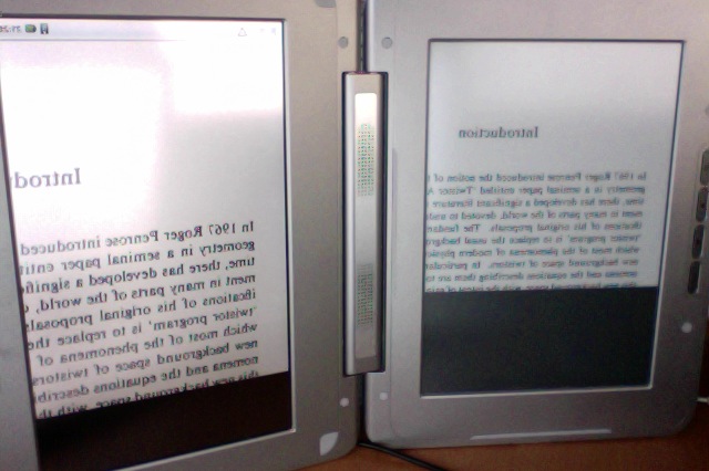

unfortunately it does not yet seem to work, for what it is worth here is the result on a pdf page (even after a couple of page turns) the result is the same on djvu pages. sorry about that.

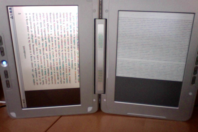

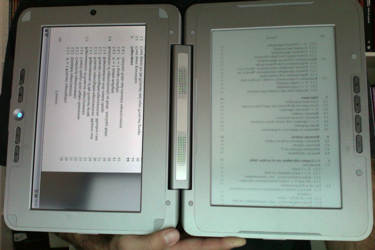

test6: initially it is scrambled in both modes, after a couple of page turns it is no longer scrambled in portrait mode (but it does not fill the entire page, see picture) whereas it stays always scrambled in landscape mode (but does not seem to turn with the lcd side, see picture).

still the same result as before, could the scrambled version be related to the fact that the landscape mode does not use the geometry of (both) screens correctly ?
