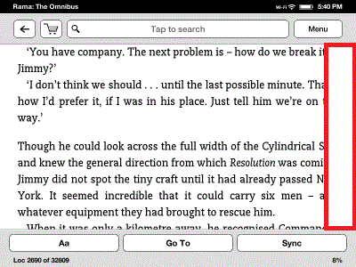

Hey,
I updated the Launcher to 1.0.1, but the previous problem has stayed.
What shall I do?
Pink Floyd is offline   Reply With Quote

That's not launcher problem, it's Kindle software that's bugged.
I suppose this poor landscape support is the reason why Amazon guys hide it from the standard menu in the first place.
As for the fix... Either wait for local genius who can fix native binaries or wait for Amazon update that would fix that.

@Pink Floyd, dchae85
Originally Posted by Pink Floyd View Post
Hey,
What shall I do?
Here's the solution to the problem:
Originally Posted by igich View Post
KT I have version 5.0.1 jailbreaked (kt-jailbreak-503) and installed KindleLouncher-1.0.1, usbnet-1.1. After the software update from version 5.0.1 to 5.0.3 I get a problem when opening of mobi format in ladnscape mode. The page is shifted to the left and the last syllable from the end of the sentence does not read. Fortunately I had kept /opt/amazon/ebook/lib directory from version 5.0.1 and I replaced MobiReader-impl.jar and everything works well.
you can get the MobiReader-impl.jar at the thread. Please remember to backup your original MobiReader-impl.jar in case you want to revert the change.
