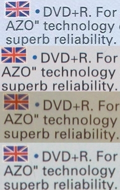

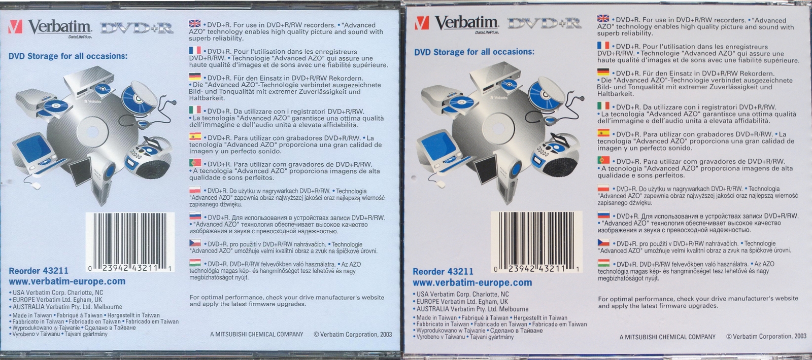

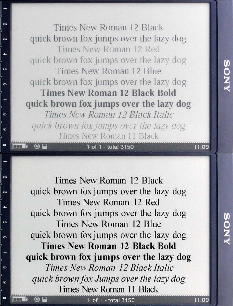

Old 10-14-2007, 05:06 PM   #77
ereszet
ereszet has a complete set of Star Wars action figures.ereszet has a complete set of Star Wars action figures.ereszet has a complete set of Star Wars action figures.ereszet has a complete set of Star Wars action figures.
ereszet's Avatar
Posts: 118
Karma: 306
Join Date: Sep 2007
Device: Sony PRS-500 Archos 704 wifi
The proof is in the pudding

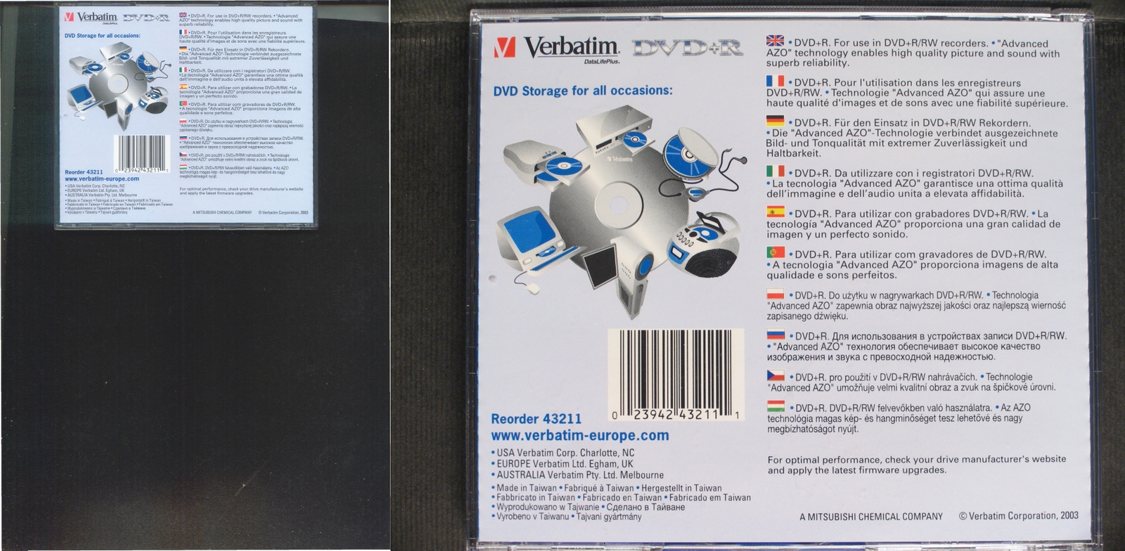

It is time to present some comparison results scanner vs. camera.
The scanner is hp scanjet 2300c at 300 dpi color.
The camera setup is Canon Powershot Pro 1 on a tripod, v-cradle put on a box to bring it closer to the lens, a home 50 watt lamp with halogen mini bulb - about 1.5 meters over the cradle, a diffusor for dissipation of light - about 40 centimeters below the bulb (see my first posts in this thread).
Neither the scanner nor the photo setup are top quality devices/arrangements. It is just what I have at hand in my temporary residence away from home.
The scanning took a lot of time (between 30 and 60 seconds if not more - I didn't look at my watch).
The photo took a split second plus a dozen or so seconds to download the image to my computer. All camera parameters apart from zoom and white balance were automatic. White balance was set to "tungsten". No attempt was made to set the custom white balance, based on a Kodak gray card (or a white sheet of paper).
The object to scan and photo was a DVD plastic reflective case with a sleeve cover underneath and miniscule text in 10 languages. See the attached picture "original scan and photo.jpg" (lefthand image is scan, righthand image is photo).
The black margins from both the scan and the photo were removed manually. See the attached picture "images with black margines removed.jpg" (lefthand image is scan, righthand image is photo). The colors are not true neither in scan (too blueish) nor in photo (too greyish). The white is more white in the scan (possibly can be made better in the photo with custom white balance settings or with postprocessing). The photo shows a small barrel distortion due to the object being close to the lens. My camera would not allow me to zoom from a further distance (automatic focus would not work; I have not tried to use the manual focus since it is awkard and cumbersome to use in Powershot Pro 1 - despite a nice ultrasonic ring that can be rotated manually, one needs to push some buttons at the same time, which requires three hands).
The quality of images can be seen in detail in the attache picture "scanner and photo detail.jpg" (top image is scan, bottom image is photo). Amazingly, the photo renders the fonts much better than the scan.

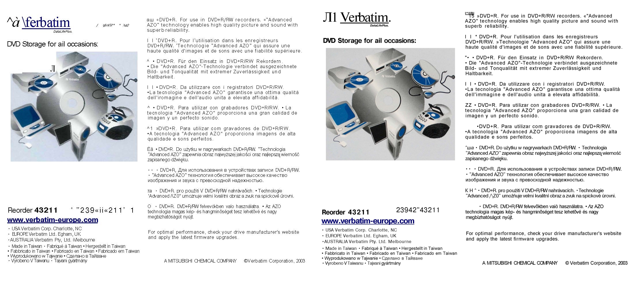

The OCR results with Finereader 8 are (out of 10 languages, two were not installed in my recognition engine):
scan - uncertain characters 82, total characters 2130; error rate 4%
photo - uncertain characters 44; total characters 2093; error rate 2%
To make the OCR results visible, I saved the results as text and image. See the attached "text and image picture" (lefthand image is scan, righthand image is photo - both after OCR). Usually, I save text under image, which preserves picture true copy of the original.
What arrangement wins? In my opinion, both for speed and quality the camera is better. But you can draw your own conclusions.
As a bonus, I include an example of OCRed photo of text on a Scan Reader screen (original at the top, OCRed "text over image" at the bottom of the picture). That the result is perfect is just accidental. You can expect some OCR errors with other texts.
Name:	original scan and photo.jpg
ID:	6314   Click image for larger version
Name:	images with black margines removed.jpg
ID:	6315   Click image for larger version
Name:	scanner and photo detail.jpg
ID:	6316   Click image for larger version
Name:	text and image.jpg
ID:	6317   Click image for larger version
Name:	sony reader.jpg

Old 10-14-2007, 08:35 PM   #78
user
user began at the beginning.
Posts: 78
Join Date: Oct 2007
Device: Benq P51
thank you very much for this!
the results are astonishing to me, camera way wins hands down, far superior to scanner way
however, I think Canon Powershot Pro 1, as a professional SLR camera, even if the megapixels seem low for todays standards (8MP), it is better than some of todays compact/ultracompact 12MP cameras, do you get the same results with your compact casio?
here you can see why SLR cameras are superior to compact cameras and why 8MP is not the same for all cameras
so, it would be interesting to estimate the optimum camera that would do the job and that anything more would be an overkill
in "original scan and photo.jpg" the scanned image is at the left? why its so small?
user is offline   Reply With Quote
Old 10-15-2007, 04:26 AM   #79
ereszet
ereszet's Avatar
Posts: 118
Karma: 306
Join Date: Sep 2007
The object in the original scan is placed in an A4 scanner so it looks small. The object in the original photo is taken with the maximum zoom allowed by the camera (while retaining focus) to get as large the picture in the frame as possible.
The scanner set at 300 dpi will make 300 dpi scans no matter what is the size of the object, be it an A4 document or a 1" stamp. The camera can zoom to get the object in the frame with little or no background, so the dpi equivalent is greater for smaller object (same Mpixels for smaller size). It is a kind of self-adjusting dpi.
One can say that it is unfair to compare a set dpi in a scanner with a self-adjusting dpi equivalent in a camera, which can much exceed the scanner setting. But my comparison is not about fairness but about practicalities. I will not even try to waste my time waiting for the scanner to take a color scan at 600 dpi or higher resolution. It would take ages.
As for my camera, Powershot Pro 1, despite the name, is not a professional SLR. It is an old "prosumer" camera belonging to the same class as Canon G-series cameras (the sensor is much smaller than the one in SLRs). Later today, I will conduct some tests with the same object and my compact cameras.
ereszet is offline   Reply With Quote

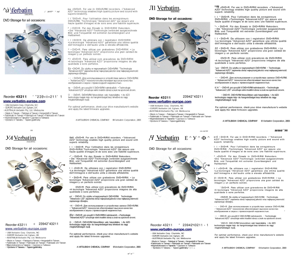

Old 10-15-2007, 10:34 AM   #81
ereszet
ereszet's Avatar
Posts: 118
Karma: 306
Join Date: Sep 2007
Scanner vs compact cameras

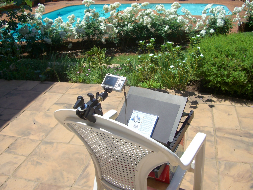

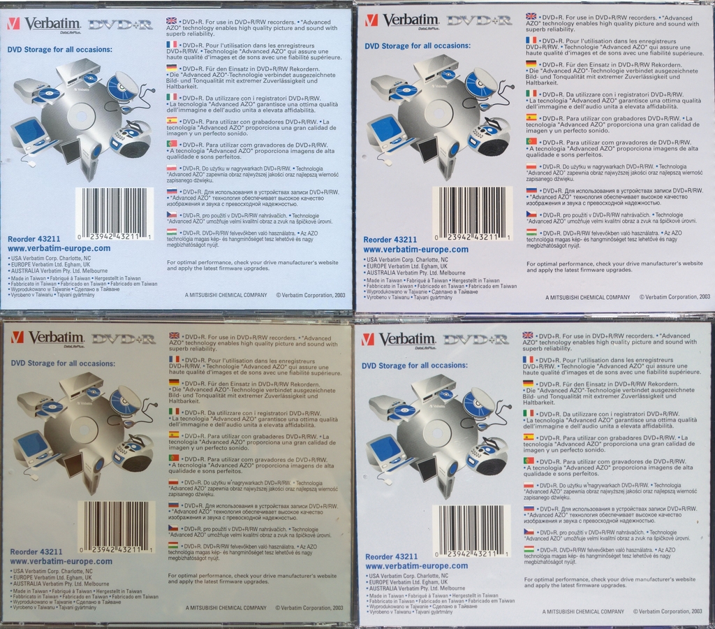

Following my earlier post, below are further test results including two models of compact Casio cameras.
Setup: since I do not touch my tripod and Canon Powershot Pro 1 anymore to avoid lengthy angles adjustment afterwords, for testing Casio I used a superclamp with a headball, attached to the back of a chair and my v-cradle put on the seat of the chair over a cardboard box. I took the photos outdoors (picture attached).
The settings:
1. HP scanjet 2300c 300 dpi color
2. Canon Powershot Pro 1, 8 Mpixels, resolution 3264 x 2448, sensor ccd 2/3" (8.80 x 6.60 mm), indoors with halogen 50 watt lamp, white balance set to tungsten, other settings automatic
3. Casio Ex-Z1000, 10.1 Mpixels, resolution 3648x2736, sensor ccd 1/1.8 " (7.18 x 5.32 mm), outdoors in shadow, white balance set to custom based on white sheet of paper, other settings automatic
4. Casio Ex-Z850, 8.1 Mpixels, resolution 3264 x 2448, sensor the same as Ex-Z1000, outdoors in sunlight, automatic white balance, other settings automatic.
The picture attached (margins trimmed.jpg) shows in the top row images from the scanner and the Canon, and in the bottom row images from Ex-Z1000 and Ex-Z850. Apparently my custom white balance setting for Ex-Z1000 was wrong (I used a white sheet of paper instead of Kodak gray card. However a white sheet works for me indoors) .
The details in the attached picture "detail.jpg" show that rendering of fonts with camera photos was in all cases better than in the scan (download and see the picture full screen). The images are in sequence 1 to 4 from top to bottom.
OCR results with Finereader 8 (no preprocessing of pictures)
1. scan - uncertain characters 82, total characters 2130; error rate 4%
2. Canon - uncertain characters 44; total characters 2093; error rate 2%
3. Ex-Z1000 - uncertain characters 52; total characters 2100; error rate 2%
4. Ex-Z850 - uncertain characters 80; total characters 2133; error rate 4%
The pdfs saved as text and images are attached in the last picture.
Conclusions:
- The results from a compact Ex-Z850 camera are comparable to those from the 300 dpi scan.
- Canon (8 Mpixels) gives better results than Ex-1000 (10.1 Mpixels) because of a larger sensor.
- The higher resolution (10.1 Mpixels) Casio gave better results than 8.1 Mpixels Casio, despite the same sensor size (however, it is not as good as 8.1 Mpixels Casio when focusing under dim condtions).
BTW. I have no time to deal with RAW, so I save pictures as the biggest size jpgs (compressed in the camera). Typical sizes are 2 to 4 MB.
ID:	6341   Click image for larger version
Name:	margins trimmed.JPG
ID:	6342   Click image for larger version
ID:	6343   Click image for larger version
Name:	pdf saved as text and picture.JPG

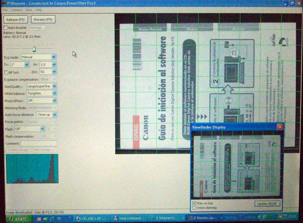

Useful features
Do not take my ad hoc tests as a scientific proof. The results may vary from shot to shot. My tests only show that a digital camera can be as good (and much faster) for scanning as a cheap scanner.
For professional comparison of practical resolutions see http://www.robgalbraith.com. The author provides tests for all the cameras reviewed. (The link didn't work for me today because of Gateway Timeout. Probably a temporary problem).
When deciding on which camera to buy remember about a remote capture feature, which is available for most Canon and very few other cameras. Check http://www.breezesys.com/ to see what cameras the author's Psremote program supports. Also, make sure that the camera can be powered by an external AC power supply.
From http://www.steves-digicams.com, I quote:
"RemoteCapture allows you to operate the camera while tethered to a computer via the USB port and includes a live viewfinder option. The Field angle/flash screen gives you access to settings for: Focusing Point, Flash, Macro Focus, AF-assist lamp and AF operation.
The Image Size and Quality is selected at the top. The shutter can be tripped by either a mouse click or a hot-key on the keyboard.
Captured images can be saved directly to the computer or they can be stored on the camera's CF card and then transferred to the hard drive
The Remote Capture program is also capable of interval and timer recording as well as instantaneous. Shooting interval: approx. 1 – 60 min. (1-min. increments) Number of shots: 2 – 100 shots (Maximum number of shots varies according to memory card capacity"
Avoid compact cameras that need a cradle to download images or to recharge batteries (unfortunately that is the feature of my Casios - two different cradles for two similar cameras). Camera+cradle+power supply is no longer compact.
If I were to buy a compact camera today, I would choose Canon Powershot A640 or a successor.
Old 10-19-2007, 10:53 AM   #87
user
Posts: 78
Join Date: Oct 2007
Device: Benq P51
mmm, I dont think Canon Powershot A640 is the best for OCR
here is a comparison of Canon Powershot A640 with Sony N2 (canon at right, sony at left):
in my opinion, canon looks blury and less sharp than Sony's, but with good color reproduction (black is greyish, but it doesnt have purple in it as Sony's and white seems better that Sony's), however I dont know which is better for OCRing and which is more easily corrected with postprocessing, accurate colors or sharpness
Good research. But I am afraid that with Sony you will miss this - photos attached.
Name:	laptop screen.JPG
ID:	6486   Click image for larger version
Name:	photo captured.JPG
