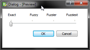

Putting aside the above concern, I am not convinced that sliders are the right interface. They imply a level of 'analog' behavior that isn't there, and also don't support tool tips and the like well.
I'm not sure I agree on that as I think "analog" with tickmarks and distinct labelled positions in combination with the actual values I proposed do actually represent a scale of directness of matching. However like I said the Qt sliders are pretty crap, and trying to line up centered labels in a grid next to them etc won't work very well.
I would lean toward radio buttons, with two groups. Group 1 would have ISBN, then the title choices, with the first choice being ignore. Group 2 would have the author choices with the first choice being 'ignore', which would line up horizontally with the title group's ignore (nothing beside the ISBN choice). Choosing ISBN would force group 2 to ignore and disable it. Choosing any title option would enable group 2. Choosing ignore for both options can be an error, or can make one big group.
I think I need a picture sorry
I'm not intending to change it at this point, your suggestion of getting wider feedback is valid. It is just that I wanted to add a fuzzier author & title algorithms to make this plugin more useful. However adding just a single "fuzzy title, fuzzy author" option might bring back way too many false positives. Maybe "similar title, fuzzy author" and "fuzzy title, similar author" would be the most useful variants of that.
I think this is the slider you want? I did this with a vertical layout containing two horizontal layouts. The top layout has the labels, the bottom one the slider.
This is what I meant by the radio buttons. EDIT: I forgot the 'ignore me' buttons.
Old 04-16-2011, 09:50 AM   #82
kiwidude
Calibre Plugins Developer
Posts: 4,883
Karma: 2220332
Location: Australia
Device: Kindle Oasis
I think this is the slider you want?...
Thanks Charles, you have been busy. You can see what I mean by the difficulty of lining up the tickmark labels nicely. Thanks for the radio buttons, as they say a picture is worth a thousand words.
kiwidude is offline   Reply With Quote
