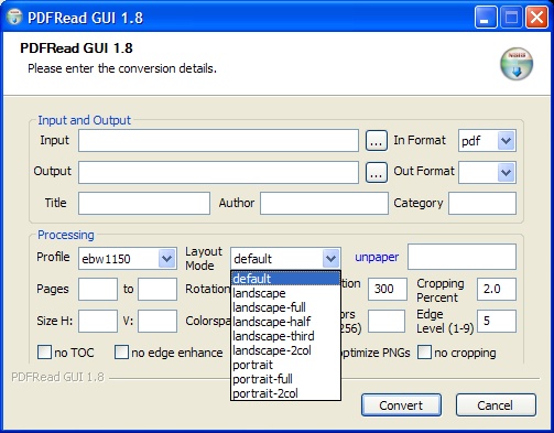

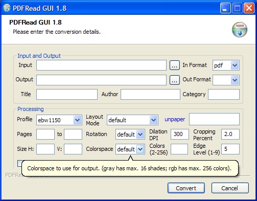

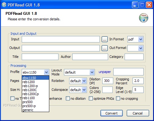

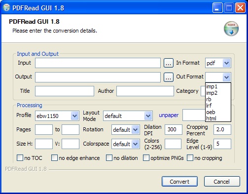

PDFRead 1.8 has many enhancements and minor bug fixes. Attached are screenshots of the new version 1.8 GUI.
ID:	11461   Click image for larger version
ID:	11462   Click image for larger version
ID:	11463   Click image for larger version
ID:	11464   Click image for larger version
Last edited by nrapallo; 03-13-2008 at 04:27 PM. Reason: added pictures of new version 1.8 GUI
