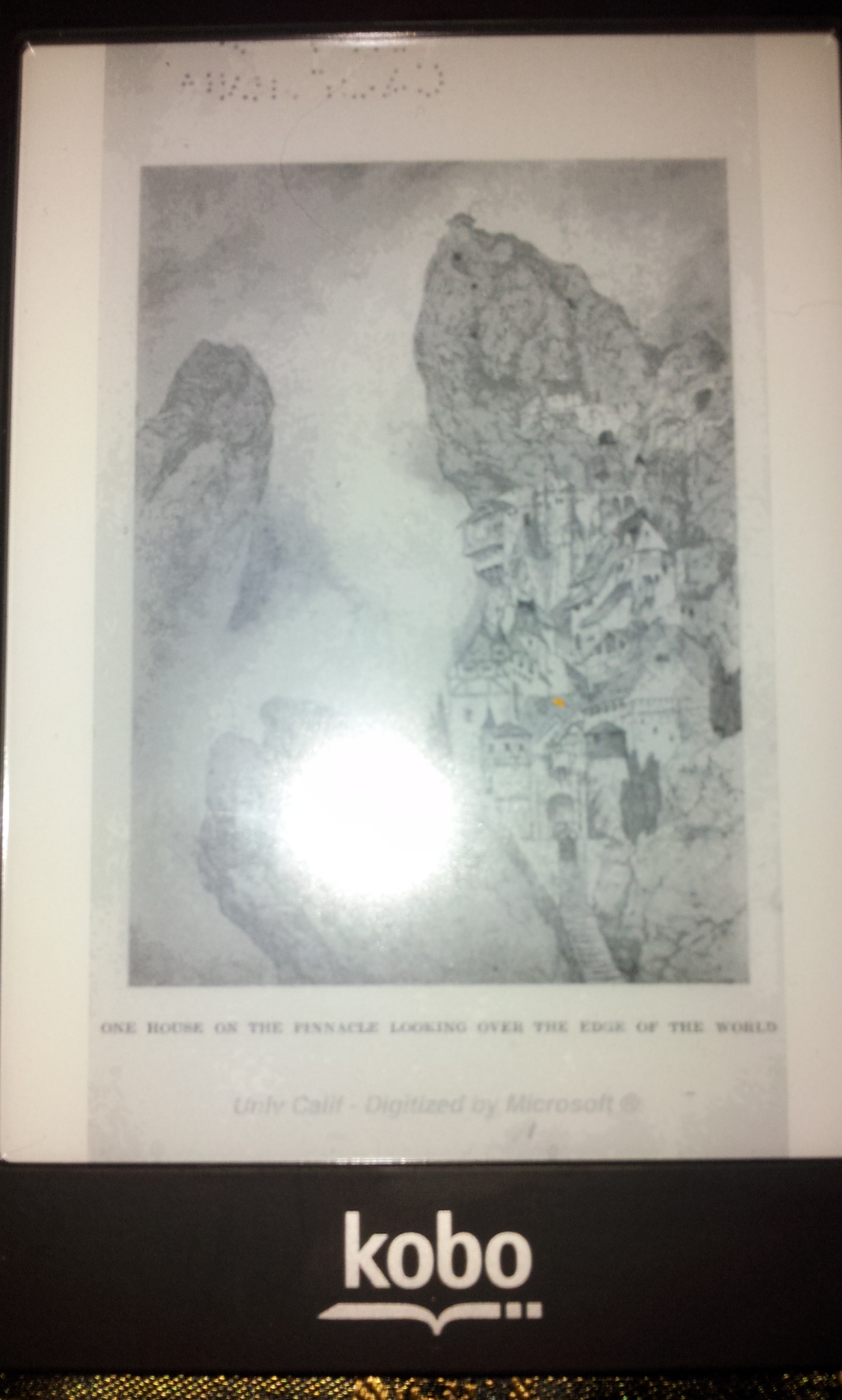

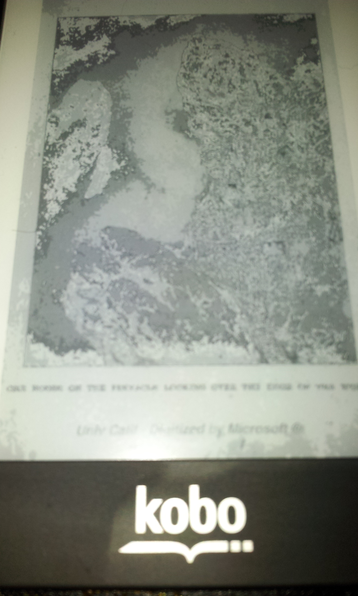

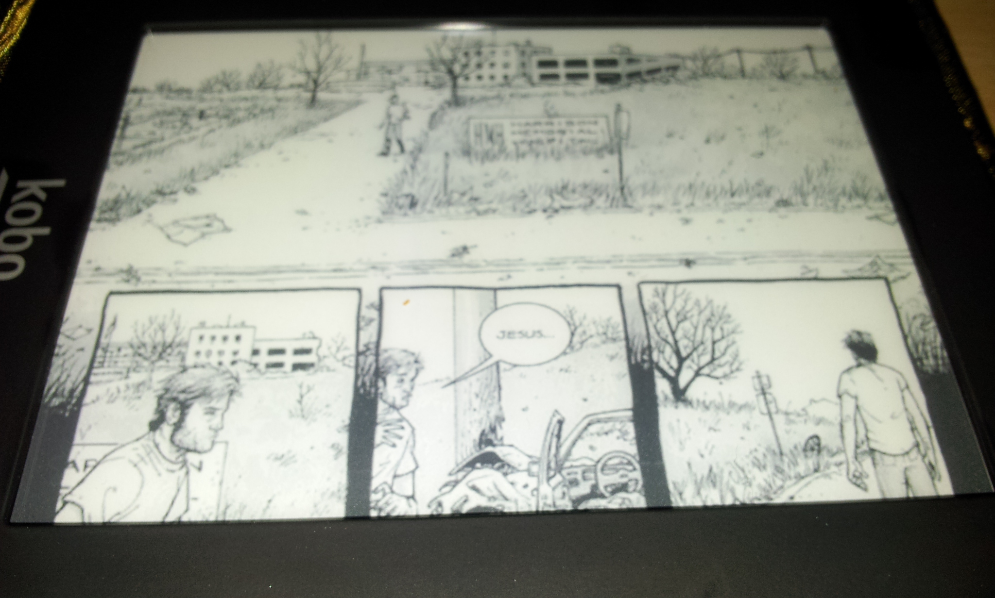

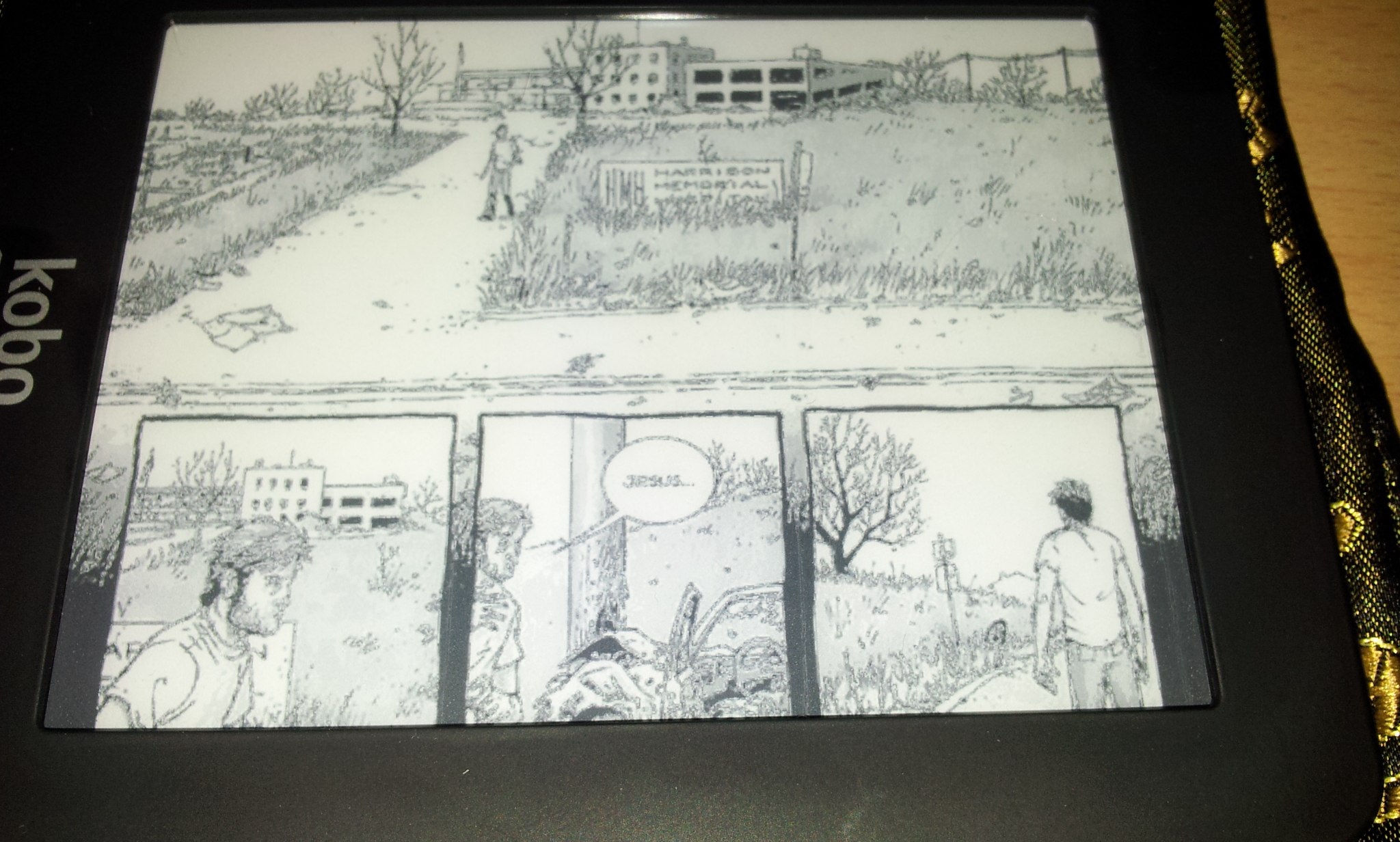

I get pictures displayed wrong in build669, while 641 worked fine. Seems shades of gray are messed up or something. It shows in cbz, pdf, djvu... Am I missing something?
That sounds like an issue related to the rendering of the original Mu based PDF reader project. Perhaps it needs to be adjusted to work with the improved framebuffer capacity and handling. Good thing you are bringing it up, so it can get looked at.
My .jpg are not rendering properly now either. Those I thought would be rendered by the libjpeg in the cr3 engine routines.
Luck;
Ken

I'll look into this. Ken is right, it's probably a regression with the new framebuffer (or rather, the underlying blitbuffer) code. Unfortunately, it might be a job that has to wait for the coming weekend, due to restricted spare time resources :-)

Thanks for looking into this, it's a major issue to me because koreader is the only way to reading those file formats. Will try to post some pics later...
edit: pics added, the left pic of each set is from build 669, other is 641. first set is djvu and second is cbz.
