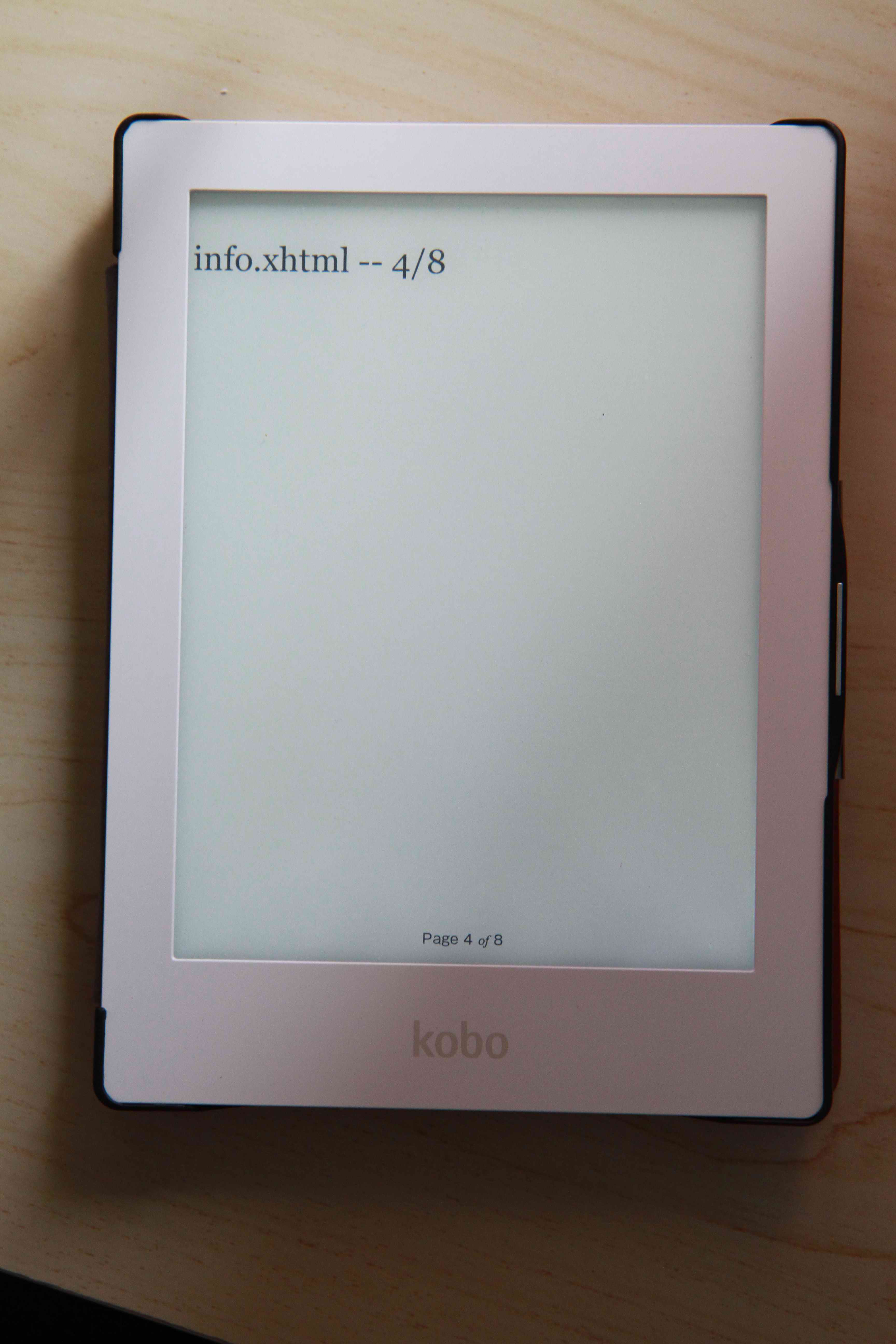

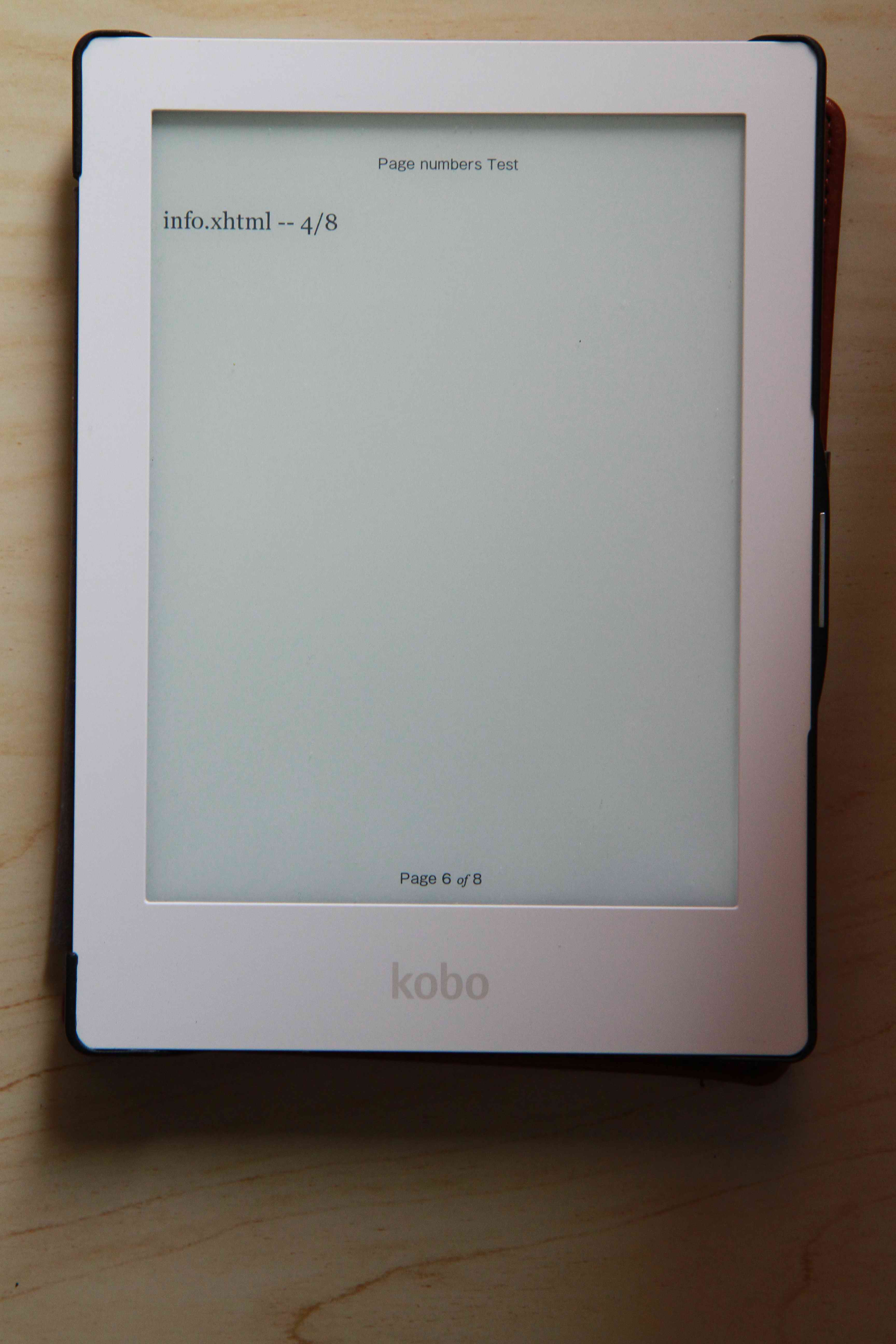

Because I was testing something else related to sending kepubs, I initially did a conversion to kepub and then sent it to my Glo. Paging through it I saw the same page sequence as above.
Then I deleted the kepub version from the Glo and calibre and enabled the extended driver. Exactly the same results as with the converted version and using the calibre viewer.
But, the numbers on the page do not agree with our original post. The file names do but not the numbers. Did you post the correct version of the epub? Or have I missed something?
Strange, because what you are actually saying is that you cannot replicate the issue. So either it's device dependant, (Glos are unaffected but Auras HD are) or something is wrong with my device.
I've retested following the next sequence:
  1. I've delete the test ebook from my AuraHD and from my Calibre library.
  2. I've downloaded the epub I previously uploaded and I've added it to Calibre. (No possible error about different versions of the test book).
  3. With your Kobo Utils plugin I've performed a check on the Aura HD database. It's OK.
  4. Using Calibre I've sent the ebook as epub to Aura HD. (I've disabled "Enable Extended Kobo Features" option in KoboTouchExtended driver).
  5. Picture taken from the fourth page (info.xhtml) in RMSDK viewer. All is fine.
  6. I've deleted the ebook within Aura HD.
  7. I've re-sent the same test ebook but as kepub ("Enable Extended Kobo Features" on).
  8. The bug is present. Picture taken from the same page.
What else can I check?

Weird. There should be no difference between the devices for this. The database is common and I'd be stunned if the code for loading the books and displaying them isn't as well. Get the generated kepub from the device and post that. Then we can see how it is different.

Are you using full-book page numbers in the driver options? Can you post both your original ePub and the generated KePub?
I upload the kepub from the device.
And yes, I'm using full-book page numbers. Nevertheless in my first post about this issue I uploaded a screenshot with all the driver settings I use.

This is nothing to do with the driver. I took your source ePub file, renamed it to have the ".kepub.epub" extension, copied it to the device, and the same bug occurred. There's surely a reason for it, but it may take some digging to find out why.
It's clear why info.xhtml is the fourth in order - it's the fourth in the book's spine ToC. But I can't see why the page numbering in full-book mode goes 1, 2, 3, 6, 7, 8, 4, 5. But I can tell you it isn't something to do with this driver, rather some bug (or something we don't understand) with the way the ACCESS reader is used.
But at least you can replicate the issue, can't you?
I was starting to get VERY nervous as davidfor didn't seem to be able to get it in his Glo...
I've replicated it now. I missed the need for the full book page numbering.
But, I think PeterT has it. When I open either the epub or kepub version in Sigil and check for errors, I get one error. The message is "empty content is not valid for content model '(meta+)'". Try doing a epub-to-epub conversion in calibre and then resend it using the extended driver. That conversion should probably fix the error in the book and the device should handle it properly.
