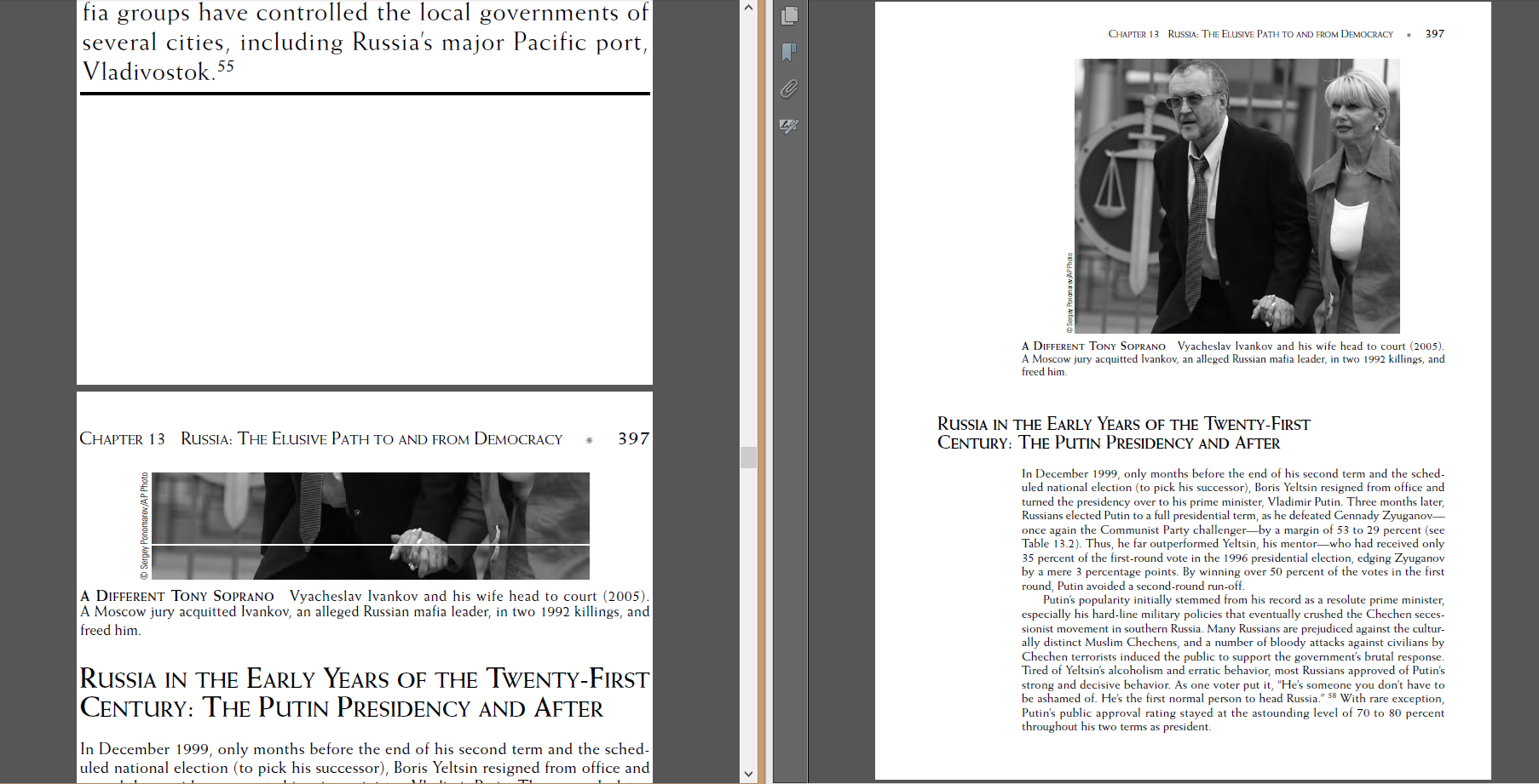

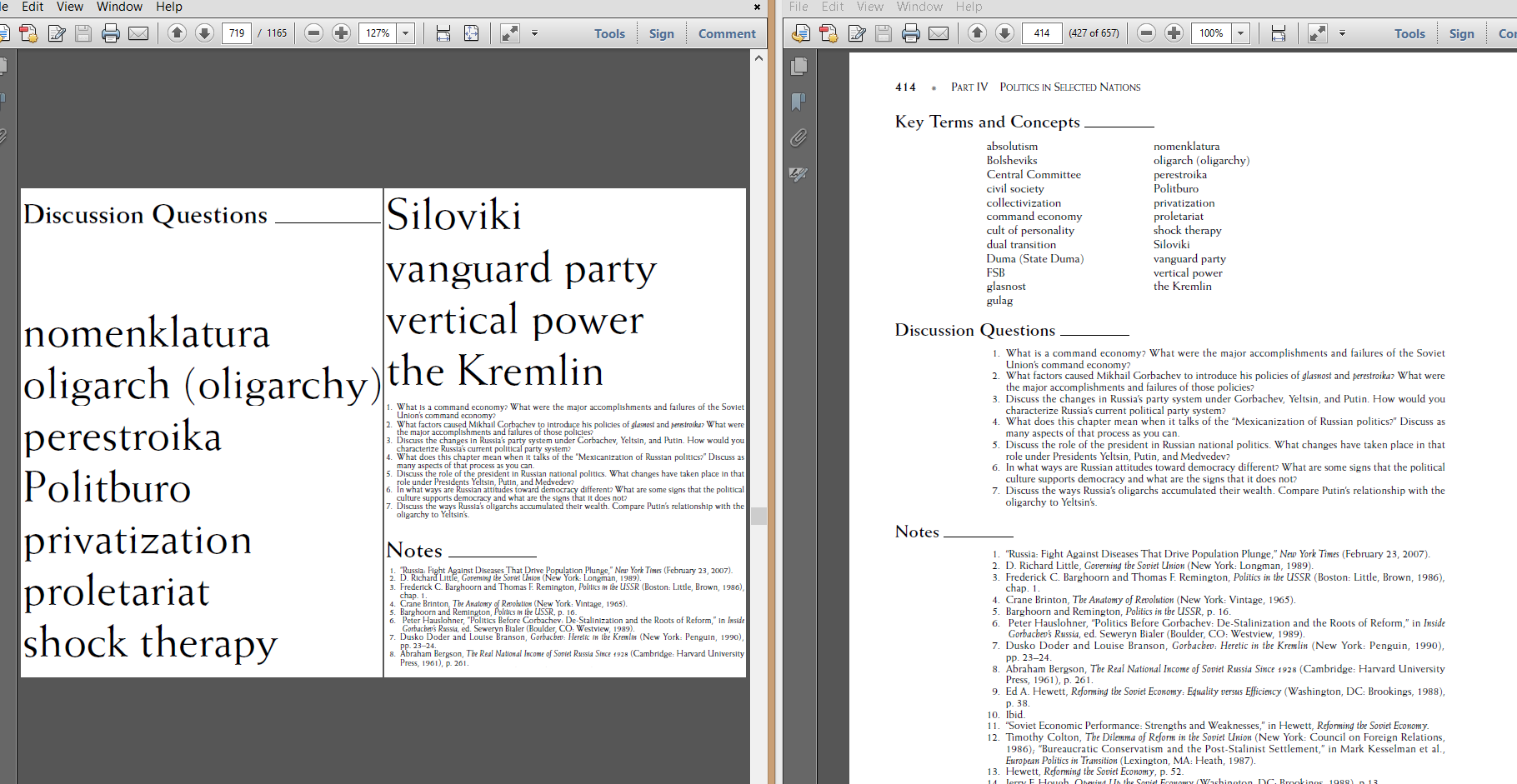

1) The search is absolutely broken, at least in Adobe Reader. I wasn't able to find any phrase correctly - at all times the wrong places are highlighted. Wondering how this would behave on the Kindle itself. No idea how to fix this either.
2) The images are broken down and misplaced. I have attached a screenshot to illustrate this. You'd think it happens because the image is close to the page border but this is not the case - virtually all images are broken down in the same way, regardless of their position.
3) Some formatting is handled badly, in particular columns - my second screenshots shows this effect.
4) The cover (the first page) is gone entirely. I can't figure out why would that be.
I used the native pdf output and mostly kept everything default I think.
Any clues?
