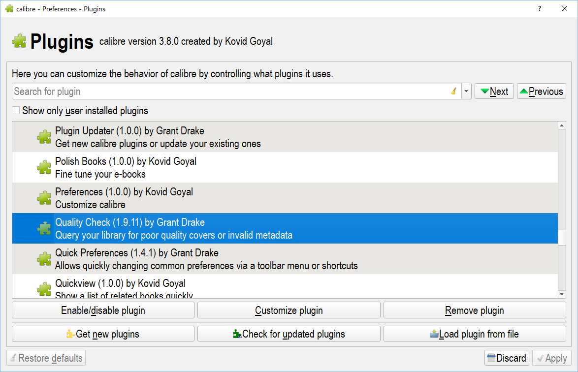

Originally Posted by mariaclaudia View Post
Hi, I'm curious, why does not this plugin appear in the Caliber add-on list? Thank you
It is both on the calibre list (see attached) and listed in the Index of Plugins.

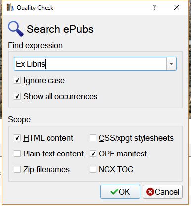

Thank you very much, I found it. Now rather a doubt about its use. Is it possible to search for an image by its name? Is that I have added Ex Libris to some books, and I want to modify them, but I do not know what books have been, but if I could find the epub that have the image that I created for Ex Libris, it would help me a lot.
Thanks for the support
Sorry for my grammar, I'm still learning (I use the Google translator to support me)

I would search the OPF manifest for the filename
(not tested. No books with Ex Libris)

It's almost the same I did. I searched NCX TOC section and that's all.
