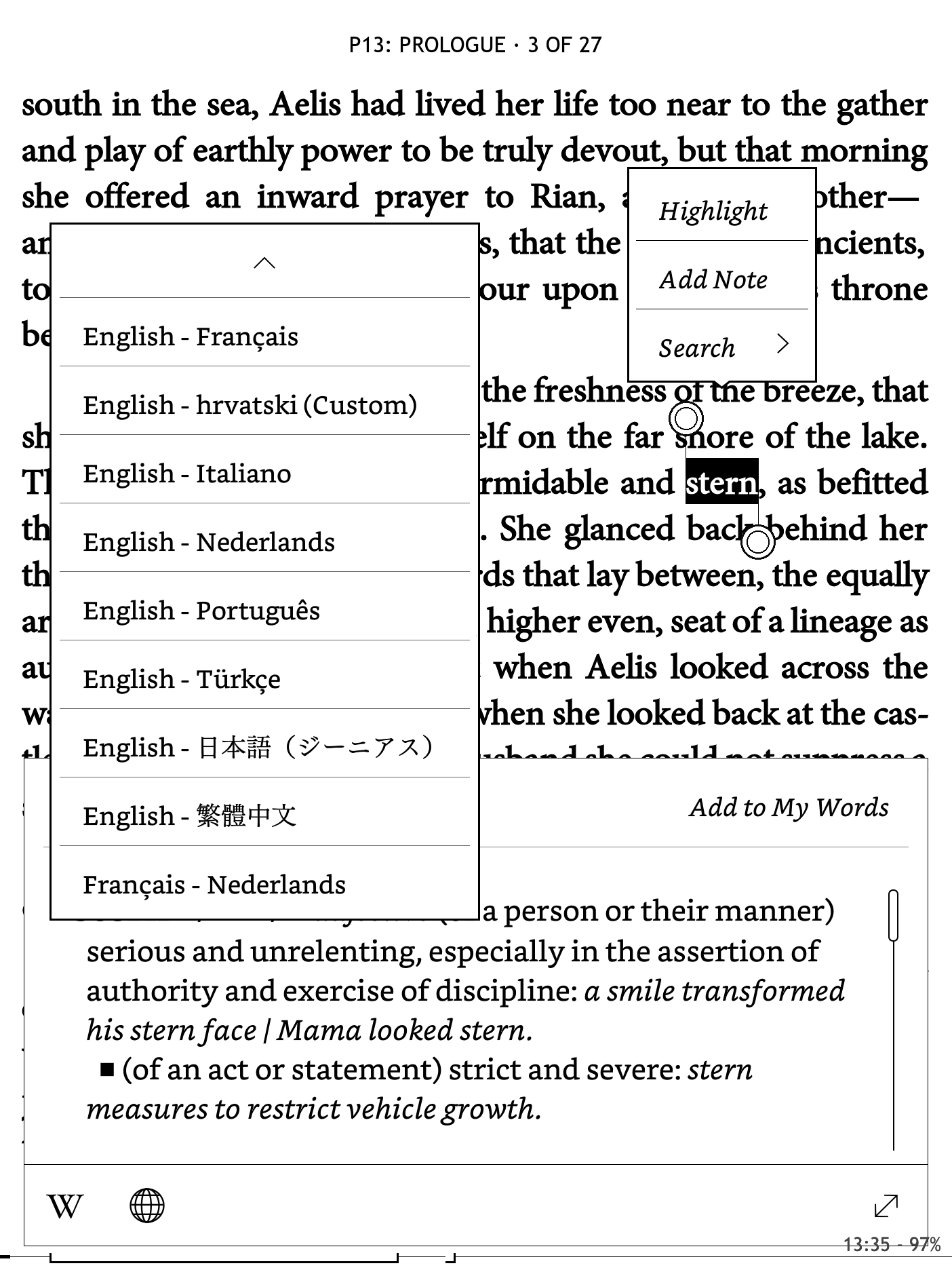

I have no idea why my suggestion is not working for you.
I placed a custom dictionary, renamed to dicthtml-en-hr.zip into the subdirectory .kobo/custom-dict/ on a KA1 and rebooted.
See attached screenshot. It appears, as expected, in the dictionary drop-down as:
English - hrvatski (Custom)
