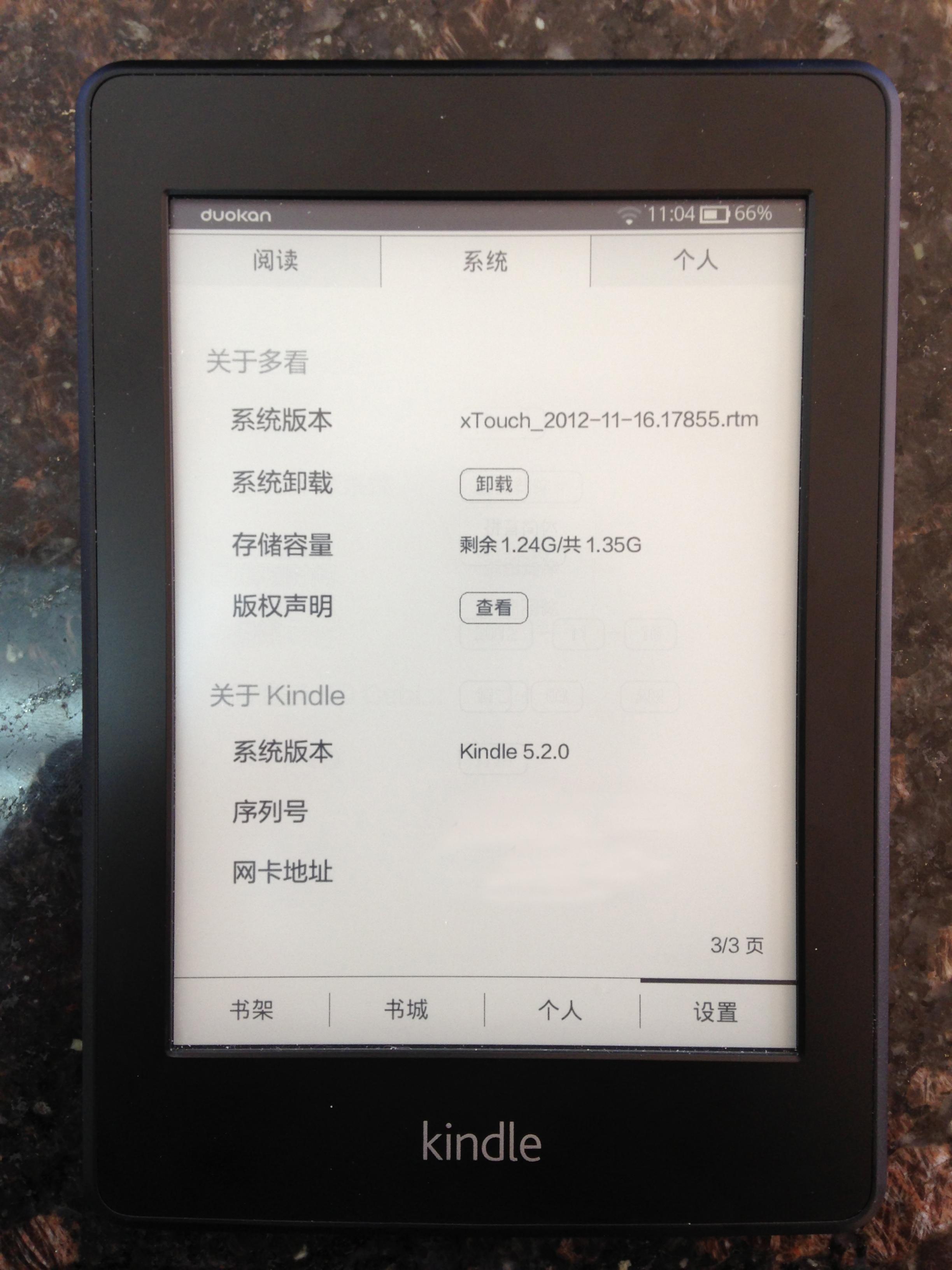

Duokan for Kindle Paperwhite is released. Supports jailbroken 5.2.0
hxxp://pan.baidu.com/share/link?shareid=110659&uk=3844333464
Click the white rectangular button. Enjoy. This file contains duokan for KP and Kindle Touch. Version is 2012 R7.0.
I'm currently downloading this and will report back once I get it on my KP.
Edit*
I got it installed so if anyone needs installation help. Read below:
1.Extract the zip file.
2.Copy the "DK_System" folder into your root.
3.For Paperwhite, copy the "data.stgz" into root. For touch, copy "diagnostic_logs" "data.tar" and "enable_diags" into root.
4.Eject and unplug your kindle from your computer.
5.Restart your kindle.
6.Restart your kindle again and it will install Duokan.
7. Enjoy
Everything is in Chinese, but I have contacted its developer to offer a helping hand with a English translation. They said they will contact me once they are ready for it.
