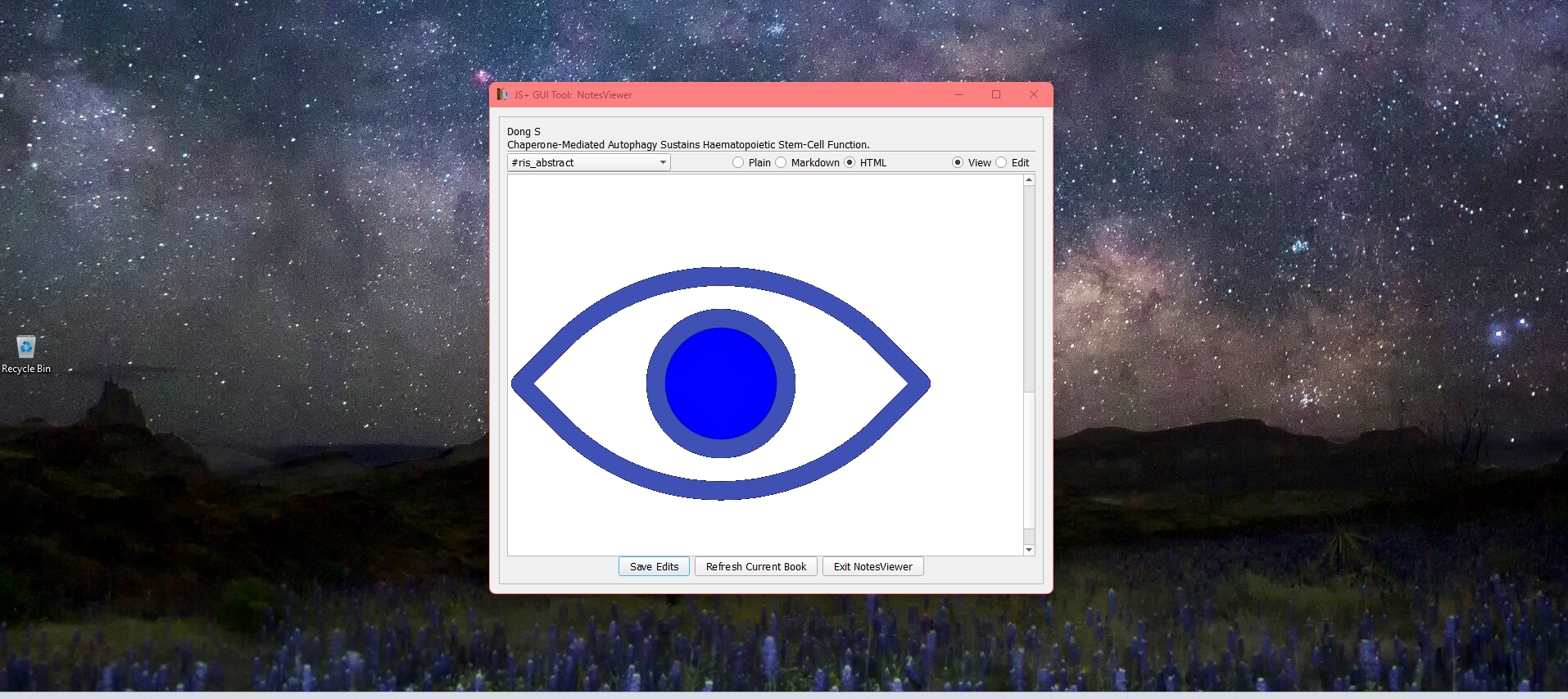

NV Cannot be Parent-less without an OS 'Stay on Top' Gadget
NV behaves as a child window, i.e. it follows the main window when it's minimised and doesn't present as a separate item on the calibre task bar...
Trivial to change. The "parent" usually just defaults to Calibre's GUI, but is easy to change to be parent-less.
See the attached example snip of a piece of my desktop photo with NV open.
Change: Next version will be not be parent-less because unless you use a 'stay on top' window utility, like I do, it would be highly annoying and very non-ergonomic to make it parent-less. Every time you click a column, the tool disappears below the Calibre GUI window.
DaltonST

Old 03-13-2023, 01:23 PM   #814
ownedbycats
Custom User Title
ownedbycats's Avatar
Posts: 11,617
Karma: 81412473
Join Date: Oct 2018
That's a giant eye!

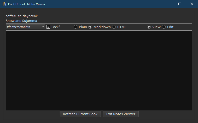

Incorrect detection:
I believe the instances of 'coffee_at_daybreak' is causing Note Viewer to incorrectly detect contents as MD. Changing them all to 'coffee' made it detect as HTML.
Despite containing HTML content, column is set to interpret as plain-text.
Column contents:
<p><span class='label'>Adapter_Classes</span>: <div class='metadata list' id='adapter_classes'><ul>
<li>ArchiveOfOurOwnOrgAdapter</li>
</ul></div><p>
<p><span class='label'>AO3 Categories</span>: <div class='metadata list' id='ao3categories'><ul>
<li>Gen</li>
</ul></div><p>
<p><span class='label'>Author</span>: <div class='metadata list' id='author'><ul>
<li>coffee_at_daybreak</li>
</ul></div><p>

Name:	2023-03-13 17_03_43-JS+ GUI Tool_  Notes Viewer.png

The DEBUG log shows exactly why MD was picked over HTML. It was because the 'normalizing factor' that was set was backwards. The divisor I used should have been the dividend, and vice versa. Fixed in new beta version uploaded to the prior post.
current_column:  #ris_abstract
MD : regex match:  (\*|\_)+(\S+)(\*|\_)+
MD : regex match:  (^(\W{1})(\s)(.*)(?:$)?)+
MD : regex match:  (\'{1})(.*)(\'{1})
HTML : regex match:   href=
HTML : regex match:  <a|</a|<a href=
HTML : regex match:  <div|</div
HTML : regex match:  <li|</li
HTML : regex match:  <p|</p
HTML : regex match:  <span|</span
HTML : regex match:  <ul|</ul
HTML : regex match:  <u|</u
guessing:
  MD: normalizing factor:  0.9
  MD: scores & ratios:  3 0.1875 0.16875
  HTML: scores & ratios:  8 0.25806451612903225
  --->>> best guess:  html

In View Mode, the visible/active qtextedit is Read-Only, which is probably why the tab won't stop there.
Note that tab goes in one direction (the opposite direction down under), and shift+tab goes the opposite. I have also been testing the use of the arrow keys that pick up where the tab left off when it stops in a 'group' of widgets, such as a radio-button group that allows only one 'on' at a time.
The dropdown combobox doesn't yet show 'focus' as visually different; I am going to look at its css and its other attributes to fix that issue.
BTW, all of the widgets are enabled for accepting focus via tabbing, clicking, and the mouse wheel. There is nothing else available that they don't already have now.
To be continued.

Old 03-14-2023, 05:47 AM   #825
ownedbycats
Custom User Title
Posts: 11,617
Karma: 81412473
Join Date: Oct 2018
That fixed the markdown problem. I'll keep going through my books and see if I can find anything else that's detected oddly.
