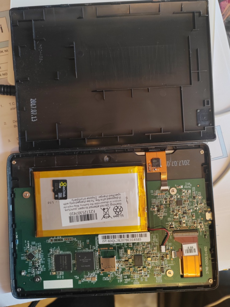

My Kobo Aura Edition 2 (model N236) became stuck on the “Restoring” screen after I had installed a third-party interface. I initially suspected that the third-party software was the only cause.
I opened the device carefully without damaging it, photographed the motherboard, and removed the internal microSD card without physically harming the card. I then connected the card to my MacBook using the built-in SD card reader.
Attachment 226000
The motherboard marking identifies the processor as **NXP MCIMX6L7DVN10AB**, an **i.MX 6SoloLite**. The card is approximately 8 GB and has the following layout:
