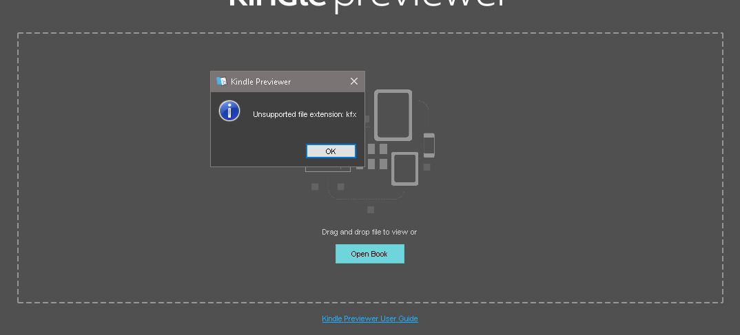

Old 03-25-2020, 08:54 AM   #797
Igorlima
Igorlima began at the beginning.
Posts: 9
Join Date: Mar 2020
Device: Kindle 10th Generation
Problem opening kfx in previewer with the bot
Hi! Thank you for the plugin!
The only thing that is still not working for me is that after I exe the bot as administrator I still get this message when I try to open a kfx book in the previewer.
Ps: I only found the 3.38 version of the Kindle Previewer.
If you could help me I would be very grateful!

Old 03-25-2020, 08:58 AM   #798
jhowell
jhowell's Avatar
Posts: 7,324
Karma: 95299999
Location: Charlottesville, VA
Device: Kindles
See the second post in this thread: Open KFX with Kindle Previewer 3
That just came out. I have not had a chance to try it yet.
Old 03-25-2020, 09:16 AM   #799
Igorlima
Posts: 9
Join Date: Mar 2020
I already saw that post and followed the steps in there, but I still got that massage.
You think the problem is that is the 3.38 version of the previewer? Is so, you know where I can download the 3.37 version?
Thank you, for the reply!
Igorlima is offline   Reply With Quote
Old 03-25-2020, 09:25 AM   #800
jhowell
jhowell's Avatar
Posts: 7,324
Karma: 95299999
Device: Kindles
That error message shows that the batch file from post #2 is not working for you. Try following the steps in that post again to install it.
No. It does not depend on the Previewer version.

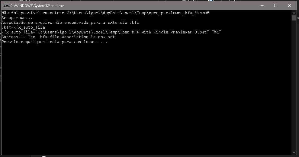

Old 03-25-2020, 09:45 AM   #801
Igorlima
Posts: 9
Join Date: Mar 2020
I tried follow the steps again, but its still not working.
When I run as administrator the .bat file It says that it wasn't possible to locate C:\Users\igorl\AppData\Local\Temp\open_previewer_k fx_*.azw8
Dont know if that affects the .bat file but I changed the location of my calibre library

Old 03-25-2020, 01:06 PM   #802
jhowell
jhowell's Avatar
Posts: 7,324
Karma: 95299999
Device: Kindles
The calibre library location does not matter.
I don’t know I why it is not working for you. As an alternative you can save your KFX file to disk, rename the file extension from .kfx to .azw8, and open that with the Previewer.
