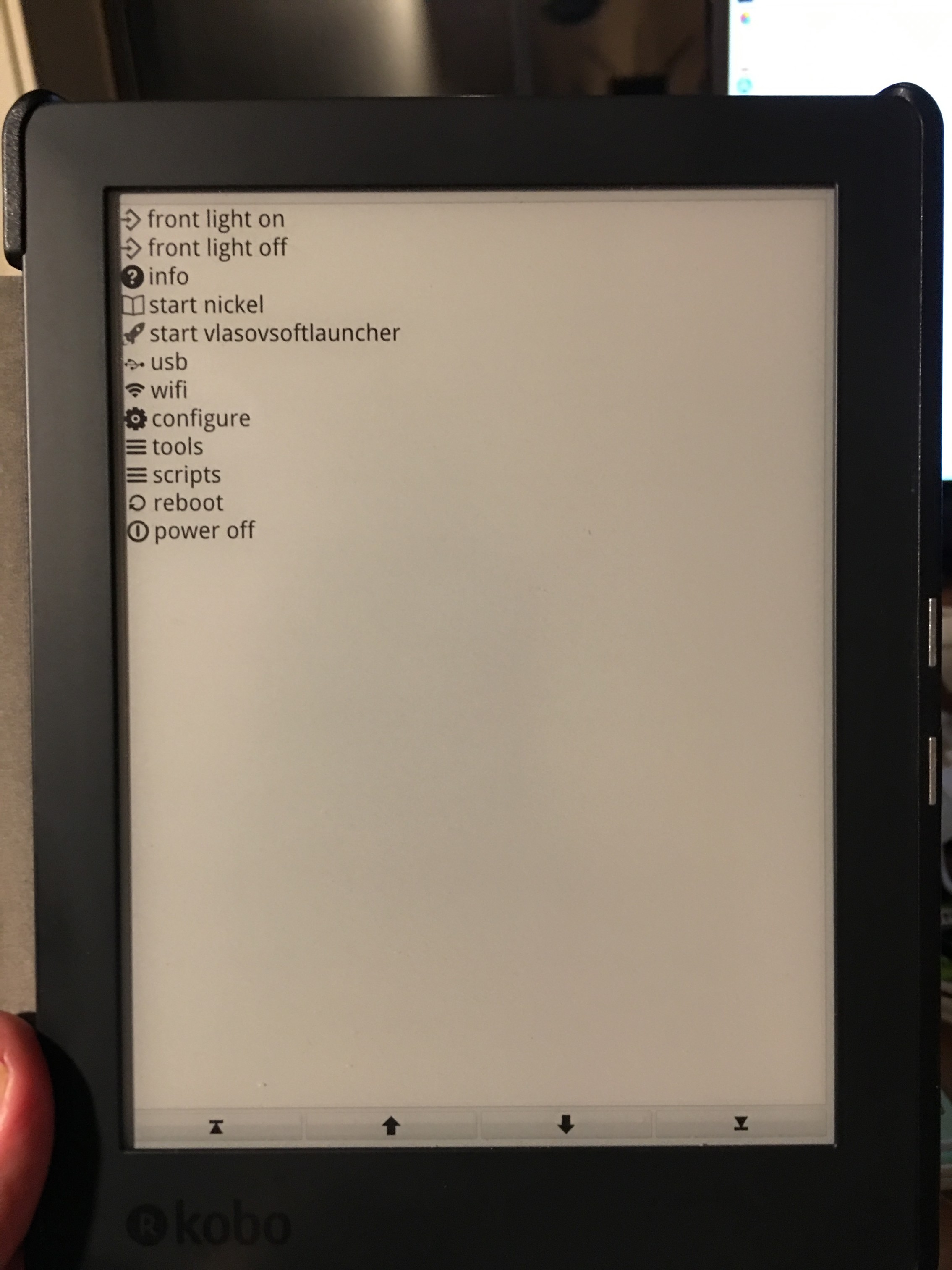

Still no touch
It boots up with the right orientation (see attachment), but still not responding to touch.

Old 10-15-2017, 05:39 AM   #807
tshering
Posts: 3,489
Karma: 2914715
Join Date: Jun 2012
Device: kobo touch
Thank you for the quick response. I did a silly mistake. I have replaced the package above by a new one. It should now use the new touch driver. I increased the font size also a bit. Next interesting point is whether the screen orientation stays constant, or whether it starts switching when you return from nickel back to KSM.
