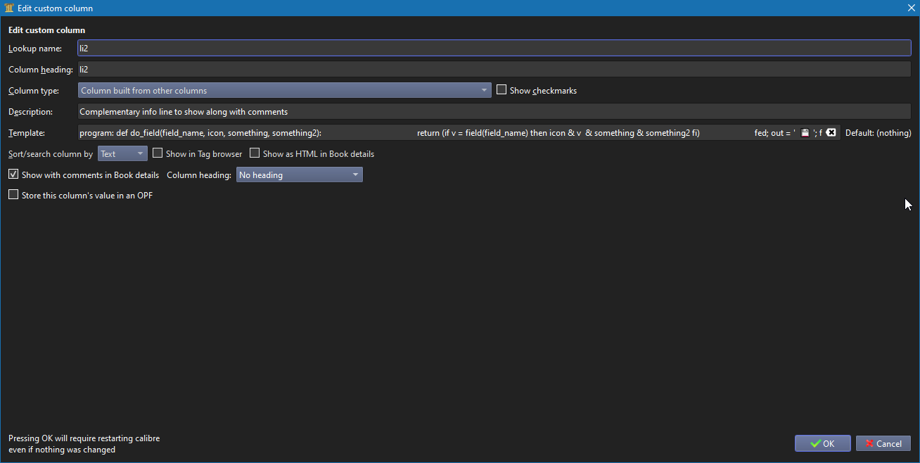

Old 01-25-2025, 02:38 AM   #786
Comfy.n
want to learn what I want
Posts: 2,478
Karma: 9656785
Join Date: Sep 2020
Device: Libra Colour
For the second template, for the bits that look like this:
if field('#li') then '​ ✍️ ' & field('#li') else '' fi,
replace them with this call to a user-defined template function:
do_field('#li', '​ ✍️ ')
To make this work you need to define the function. Put the following at the top of the template after the program: line.
	def do_field(field_name, icon):
		return (if v = field(field_name) then icon & v fi)
	fed;
Reasons:
  • The long list of conditions becomes much easier to read.
  • It saves editing if you want to change how an icon clause works.
  • The 'if' in the function uses the same technique as above for performance improvement.
I liked this approach and now I have:
program: def do_field(field_name, icon, something, something2):
		return (if v = field(field_name) then icon & v  & something & something2 fi)
	fed;
out = '  💾 ';
fmts = list_sort(formats_sizes(), 0, ',') ;
for fmt_data in fmts:
fmt = sublist(fmt_data, 0, 1, ':');
size = sublist(fmt_data, 1, 2, ':');
str = if size ># 0 then strcat(fmt, ': ', human_readable(size), ' | ') else '' fi;
out=strcat(out, str)
rof;
if substr(out, -2, 0) == '| ' then
out = substr(out, 0, -3)
fi;
out
& strcat(
do_field('#li', '​ ✍️ '),
do_field('#fav', ' ⭐:'),
do_field('#pp', '​ 📈 ', ' pages') ,
do_field('#words', '​ 📈 ', ' words') ,
do_field('#ac', '​ 🟨 '),
do_field('#ot', '​ 🌱 '),
do_field('#tr', '​ 🌐'),
do_field('series', '​ ▶️ ', ' - ' , field('series_index'))
It was cool to figure out how to concatenate the pages, words and series info, by adding those extra 'somethings', though I suspect there's a simpler way. I've added #ot (original title) and #tr (translator) as I have populated the db with this info for some titles.

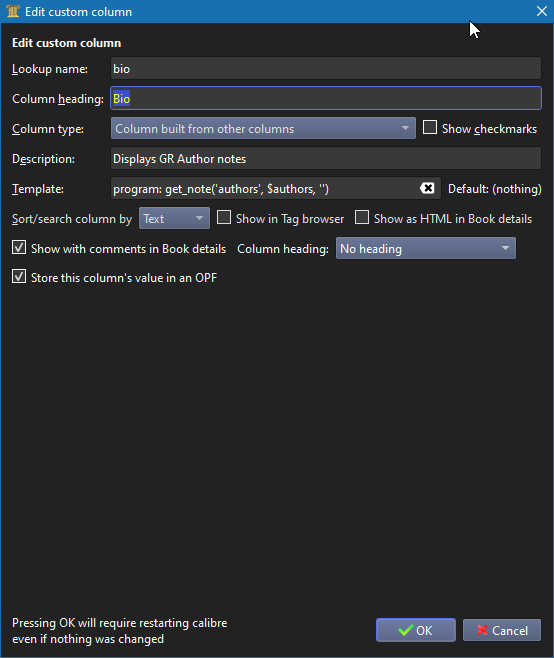

Actually what I'm using is available since 2023, I mean, the Custom Column/ Book Details feature that allows templates along with the Comments column:
Name:	2025-01-26 14_46_56-Edit custom column.png
Name:	2025-01-26 14_44_20-Edit custom column.png
Name:	2025-01-26 14_43_57-Edit custom column.png
Name:	MWSnap 2025-01-26, 14_34_49.png
As to the new Category custom icons for the Tag Browser, this feature is already available on latest preview

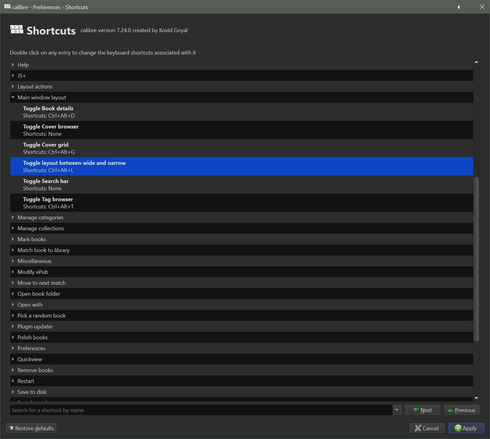

Also, I had assigned two custom layouts called "down" and "right" when the Layout Actions feature was released and would need to alternate between them sometimes. Now I've settled down with BD on bottom of the UI and i'm very satisfied with it.
FYI - the same result can be achieved with this:
Name:	Screenshot 2025-01-27 054710.jpg
Those key sequences are my assignments.
Attachment 213286
And... that's just another action whose existence I totally missed.
