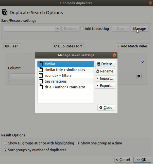

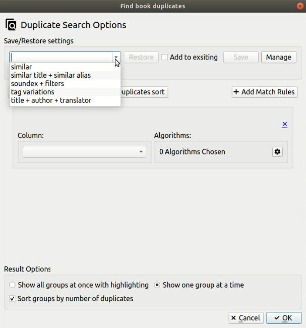

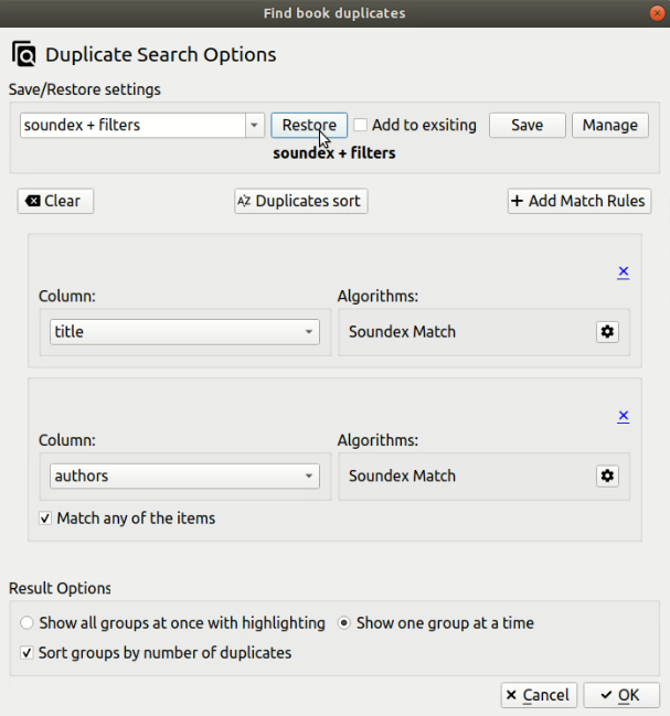

Update: Advanced Mode: Add support for saving and restoring match rules.

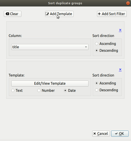

Update: Advanced Mode: Add option to control sorting of books in duplicate groups. Requested by @tanjamuse

With this new version, instead of repeating steps every time you invoke the advanced mode, you can save the match rules and restore in one click. You can also export these match rules for backup or for importing in other calibre libraries.
The new sort feature (a suggestion by @tanjamuse) allows you to control the sorting of books in duplicate groups. It is also complemented with marking the first book in the group as "first_duplicate" and the last book in the group as "last_duplicate". So if for example, if you want to show all the books in the group(s) except the last book(s) you can type the following in the search bar:
not marked:last_duplicate
N.B whether the above search applies to all groups or to the current group depends on the current search mode (either highlight or restrict results). To make it easier to switch between these two modes, follow the steps in this post.

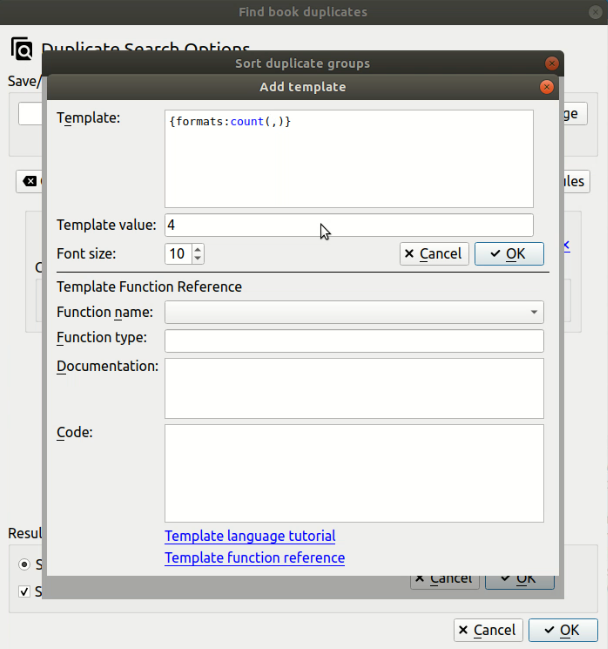

Another thing you can do with the sort is to use templates instead of columns. Say for example you want to sort the duplicate groups by the number of formats each record has, you can use this template in the sort dialog to achieve this:
{formats:count(,)}
