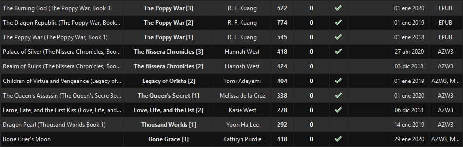

Do you get the same results if you use $$#pubdate? $ is field, $$ is raw_field.
it worked, but now there's a problem with the sorting order

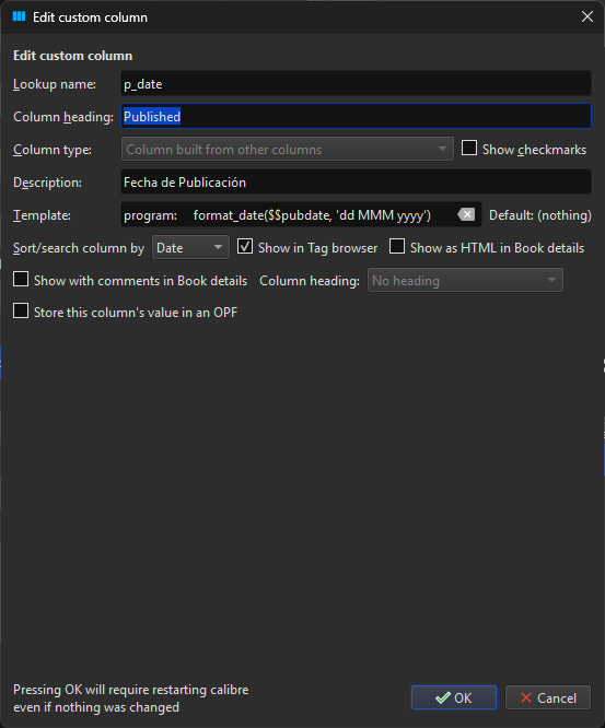

This is how the column is configured
Name:	Captura de pantalla 2024-11-05 162538.png

I'm not sure then - I seem to recall there were some oddities with the date sorting but I'm not sure if its the case here. @chaley?

Posts: 12,529
Karma: 8125420
Location: Notts, England
The problem is that the date is in non-English text. Sorting composites by date only works with English dates, and then only in most cases. The reliable solution is to sort the source column, pubdate.
I suspect a better solution would be to supply a format for pubdate (using a tweak) instead of creating a composite column.
