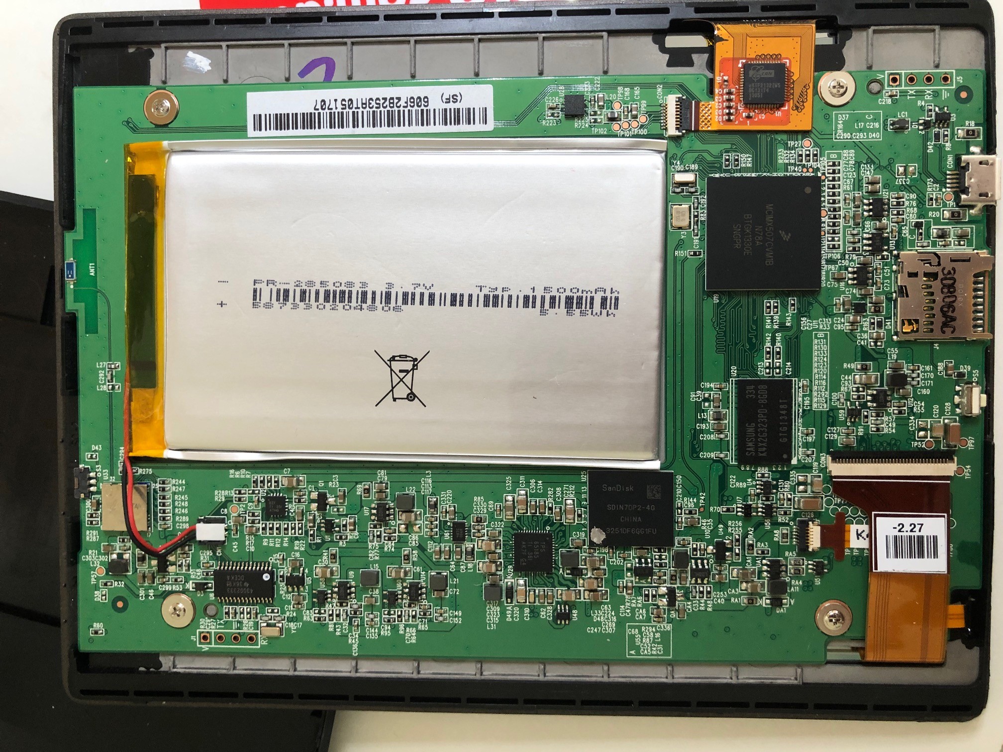

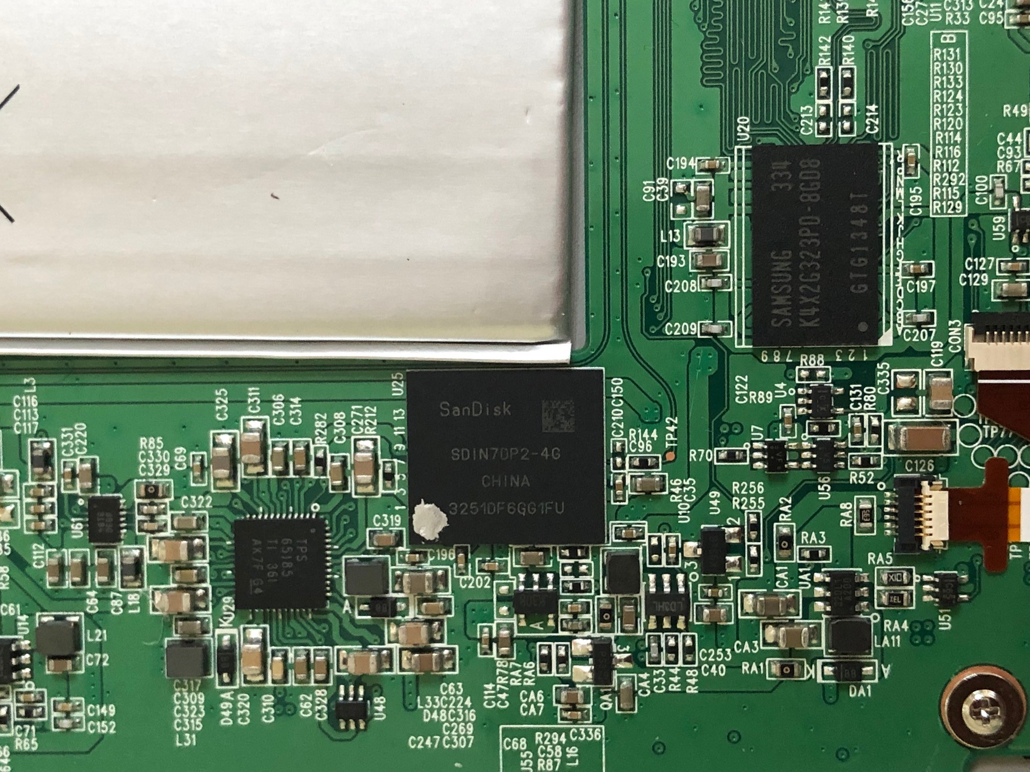

Thanks again for that image David. Unfortunately when I opened my Kobo Aura HD there wasn't a micro SIM. Instead I found a Sandisk 4GB chip soldered onto the board. I don't know if anyone else has the same when they went to do this fix.

I have never heard of an Aura HD with fixed storage. They should have a removable SD card. Are you sure it is an Aura HD? You can check what it is using https://help.kobo.com/hc/en-us/artic...or-Kobo-tablet.

Looks like I was mistaken on that model number sorry, it's a Kobo Aura and not the Aura HD.
I've attached two images of the internal board. Hopefully they've come through.

If it is an Aura, there is no image for it. Some people have been able to boot from the external card using a card built from the image for an Aura H2O.
