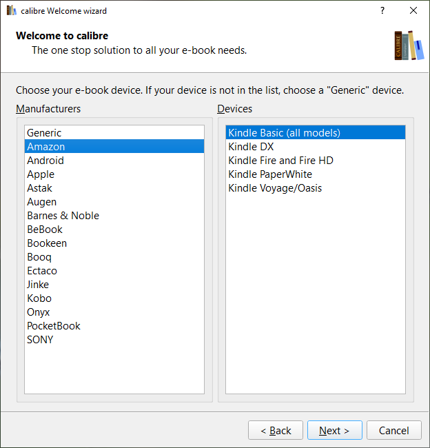

Originally Posted by BertramFox View Post
I've installed Calibre on my PC, setting my device as "Kindle Emulator." And it says the first step is to "add books," but where are they? The file called "My Kindle Content" contains exactly one book. (It's in the wrong format, but we'll cross that bridge when we've crossed the ones before.) Where does the PC keep my Kindle books if not there?
Are you sure you installed calibre? Where did you see a device "Kindle Emulator"? Do you have Kindle for PC installed? You will need that to download your ebooks from Amazon before they will show in it's My Kindle Content directory.
I've attached an image of the Welcome wizard's device selection. No Kindle Emulator to be seen.
