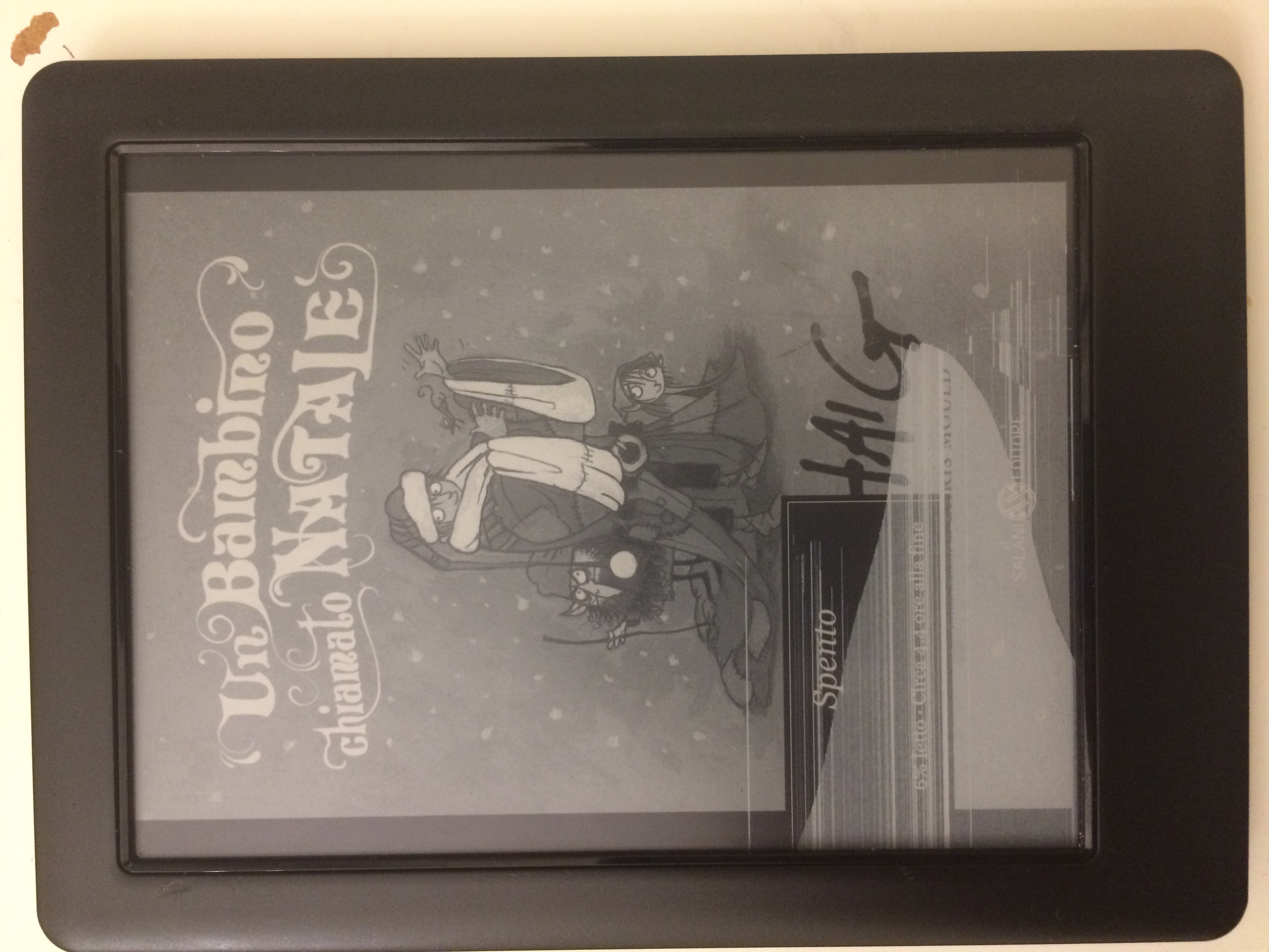

Originally Posted by luke73 View Post
At the moment it's showing a book cover and a little windows that says it's OFF.
[photo very clearly showing a smashed screen]
You are going to be wasting a whole lot of your own time (and that of others trying to help you) by omitting information like this. So many people here open their devices and muck about with the SD cards and batteries and etc, when the screen is broken and no amount of technical fiddling will change that. I wonder why the screen artifacts are so often ignored or omitted from the troubleshooting info given - even when the person describes other aspects of what is showing on the screen? Not aimed at you specifically; this happens a lot, and I just can't figure out why, or how the process can be improved.

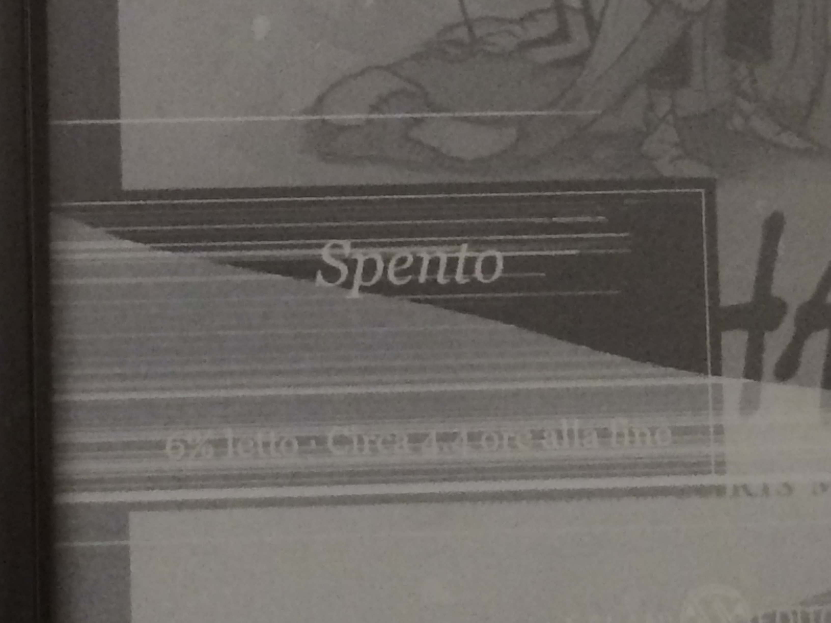

I'm sorry but I didn't foresee a broken screen.
I'm new to e-paper screen and I was thinking of a sort of last memorized page that was degrading in time.
There is no external sign of impact on the screen or the case (take a look at the images). The owner didn't talked about an incident, only about a frozen reader.
I'will report on the logs, I imagine that the boot should appear standard but no reacting screen.
Thanks
Those images clearly show a broken substrate. If you do a search here or elsewhere, you will find many readers of all brands with broken screens looking the same.
How it was broken, I don't know, I'd be tempted to think something sharp hit it near the end of the light area going across the screen. But, it might have been something else. And it might have been gradual. If there was bad bump on the screen, it can start a crack you can't see and then twisting the device a bit while using can extend it. Until you get what you are seeing.

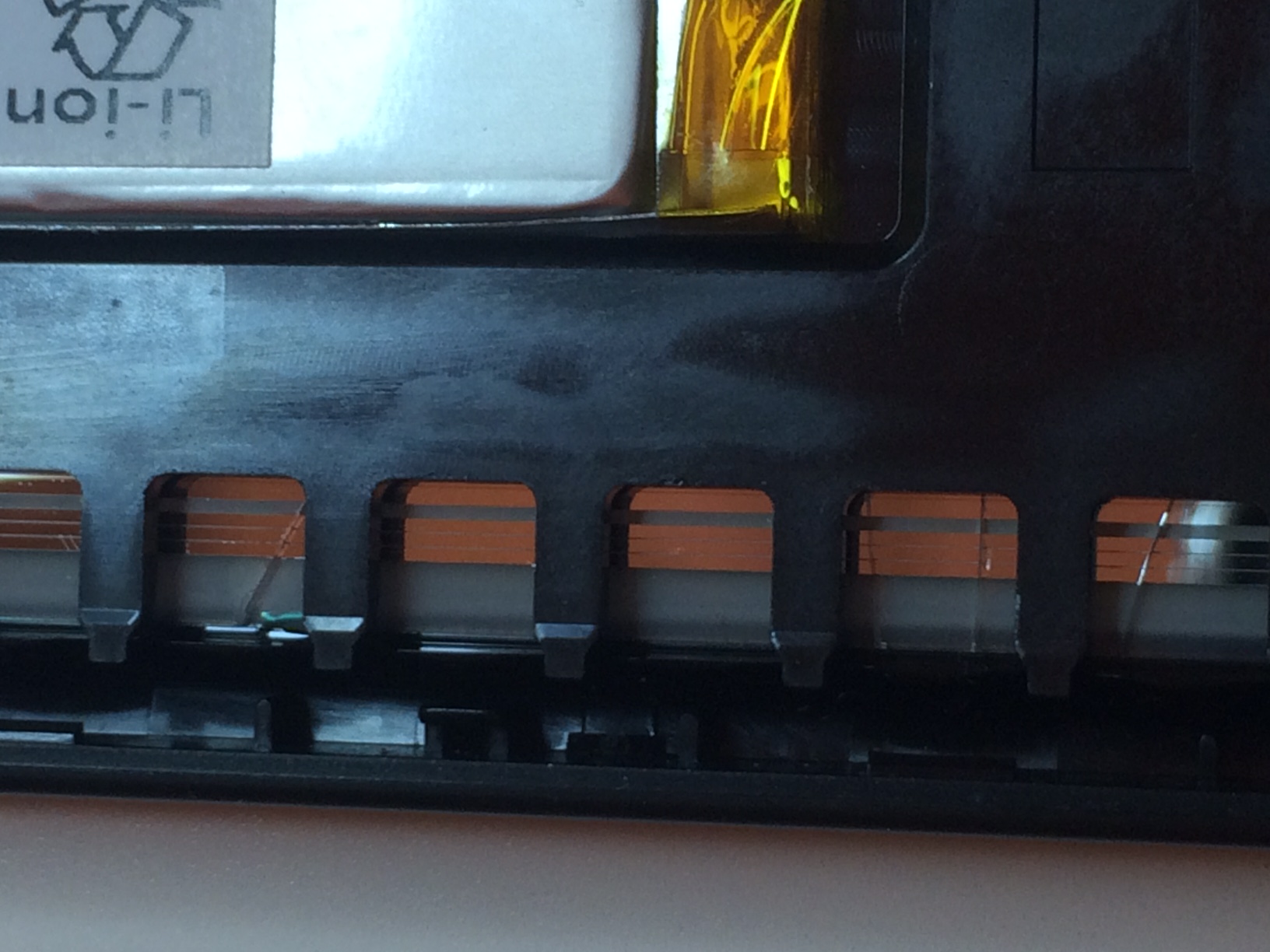

And then,
removed the motherboard ...
found the broken display ....
OK, I leave.
Thanks to all of you for your time.
Bye
G
