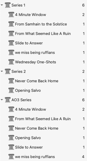

Originally Posted by dailyalice View Post
Thanks!
I think the other method I tried last night didn't use a composite column at all, I just edited the custom columns in my personal.ini so all the different AO3 columns were sending data to my #series_ao3 column, like this:
add_to_custom_columns_settings:
 series00=>#series_ao3,a
 series01=>#series_ao3,a
 series02=>#series_ao3,a
Yeah, I just tried that method again and got similar results (see attachment).
Well, that was silly. I removed ",a" from all of those and that fixed the one problem. (I don't usually use ,a but I had copied this idea from someone earlier in this thread and they used it.)
But now I'm perplexed by what is happening with my "we miss being ruffians" series data. I have both an anthology (marked 0 in the series) and three works in the series (marked 1, 2, 3).
But this is how things look in the tag browser for my series. It shows just 1 work under "Series 1" but all four of them under my AO3 Series column.
This isn't actually a problem for me given I intend to hide the Series 1, Series 2, Series 3 categories in the tag browser and just keep calibre's default series category/column and my AO3 series column.
But it's weird, isn't it? See attached.

Ugh, I need to relearn how best to post and edit posts here. It has been years.
Also my guide to FanFicFare & calibre is at 275 pages (by some measure) in a Google doc. Even considering the zillion screenshots that's ridiculous and I'm a bit loopy from working on it. (And can't believe I've spent so much time on this particular issue.)
Anyway. I finally thought to check what calibre's default series category shows. It has all four works in the "we miss being ruffians" series.
I've tried so many different things I fear I'm getting them confused. If the main series is correct & my "all AO3 series" column/category is correct, that's fine.
[EDITED TO ADD: ]
And I'm not thinking clearly. The "Series 1" and "Series 2" columns are leftover from when I was sending things into individual series columns, but now I have things in personal.ini so they all go to one column and those old Series 1 and Series 2 columns aren't being updated. (And I should delete them if I'm just going to do it this way. I left them because I was still testing things out and thought I might still want them. Ugh.)
Ugh! Sorry for wasting anyone's time here.
FYI, I don't use the tag browser at all, so I don't know what your images of it are meant to show. Assuming that is the tag browser.
I assume that the issue you got with the settings above was that it keeps growing on each update?
Try changing the ',a' flag to ',r' on the first list--that will overwrite the existing value, then the later lines will add to it.
If you posted any story URLs to go with this, I missed it.
