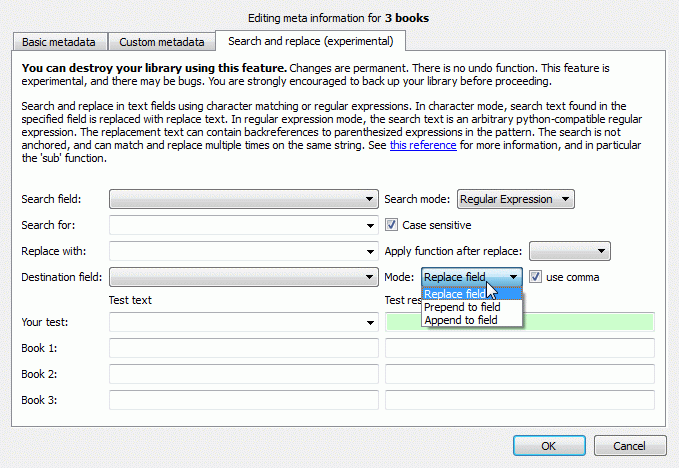

I have finished the latest effort and submitted it to Kovid. The attached screen shot shows what it looks like in regexp mode. In character mode the 'destination' line of controls goes away. You will see that I did not do general templates, but instead provide for explicit source and destination fields. Handing multiplicity was simply too hard in the template case.
It really looks great to me. It's exactly what I had in mind, with a bit extra. I doubt I'll miss having general templates.
