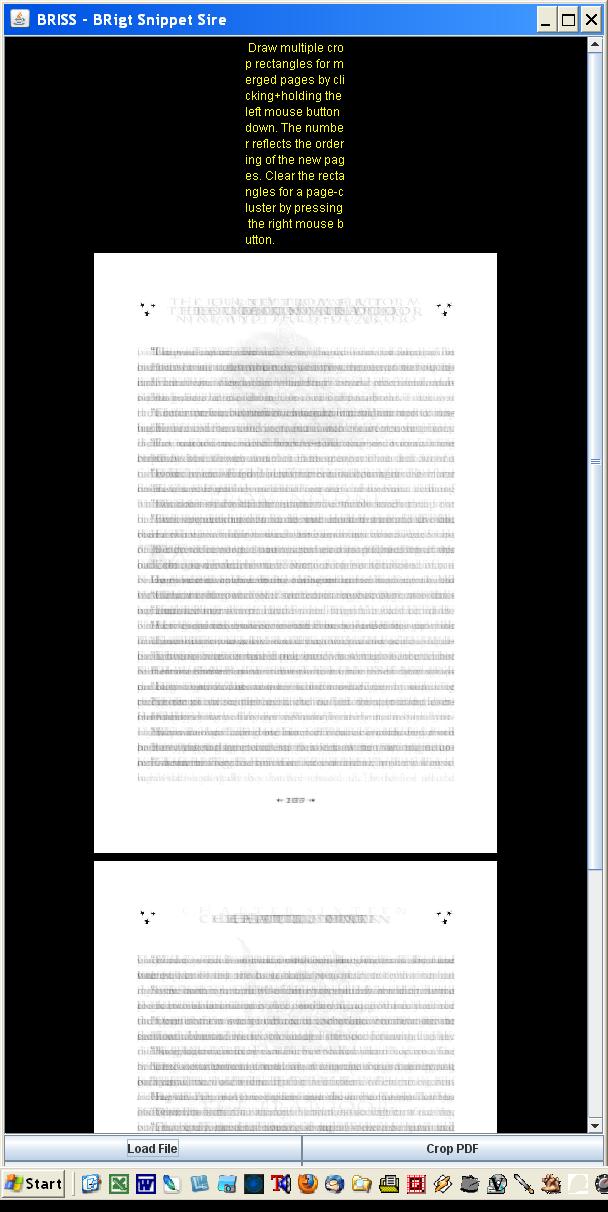

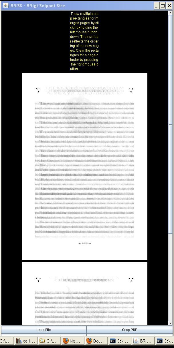

Old 07-08-2010, 07:54 PM   #66
jackie_w
Posts: 6,312
Karma: 16800000
Hi Gerhard,
Thank you for for finding time for a new release.
The remembering of last-used directory is very welcome
However, the appearance of the screen when a PDF is loaded doesn't appear much different from v0.0.8.
The cropping areas are now slightly smaller but still can't be seen simultaneously on my 1920x1200 screen. Maximise buttons are still "off screen" until window is manually resized. I attach 2 screencaps showing v0.0.9 versus v0.0.8.
Is this the result you expected?
ID:	54813   Click image for larger version
Old 07-09-2010, 01:46 AM   #67
laborg
laborg has top level security clearance to Area 51.laborg has top level security clearance to Area 51.laborg has top level security clearance to Area 51.laborg has top level security clearance to Area 51.laborg has top level security clearance to Area 51.laborg has top level security clearance to Area 51.laborg has top level security clearance to Area 51.laborg has top level security clearance to Area 51.laborg has top level security clearance to Area 51.laborg has top level security clearance to Area 51.laborg has top level security clearance to Area 51.
Posts: 105
Karma: 94000
Join Date: Oct 2007
Location: Vienna
Device: Cybook Gen3
Hi!
Hi Gerhard,
This release should only fix the problem where people were unable to create a crop rectangle because the preview was even bigger than the screen. You're suffering a different problem, but I think this can be solved easily.
Greetings,
Gerhard
laborg is offline   Reply With Quote
