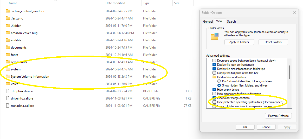

Old 11-04-2024, 01:36 AM   #66
Posts: 50,457
Karma: 178402706
Originally Posted by JediRhymeTrix View Post
Commenting to follow this thread for updates.
Also, I've never seen the system folder on my Paperwhite 10th gen (pre-MTP). Hidden files are set to visible.
On the CS, as some others have mentioned, I can see covers for some books but not others. I'm guessing they're the ones with a valid ASIN in the metadata so the covers are being downloaded from Amazon.
Under Windows, you need to remove the checkmark from Hide protected operating system files. See the attached images. The first two are the root of my Kindle Paperwhite 10th gen's storage with and without the Hide protected operating system files option disabled. The third is the contents of the system directory.

Old 11-04-2024, 02:12 AM   #67
JediRhymeTrix
JediRhymeTrix began at the beginning.
Posts: 11
Join Date: Nov 2024
Device: Kindle Colorsoft + Kindle Paperwhite 10
Ah, so just making hidden files visible is not enough, I need to make protected OS files visible as well. Got it. Thanks!

Old 11-04-2024, 07:02 AM   #72
Posts: 82,141
Karma: 150871427
I wonder if anyone who looked at a 2024 Kindle under Windows for the system directory has turned on show hidden system files? If not, then we don't know if system is visible or not.
Old 11-04-2024, 07:03 AM   #73
Posts: 82,141
Karma: 150871427
With hidden system files now visible, can you see system under Windows with your Colorsoft?
