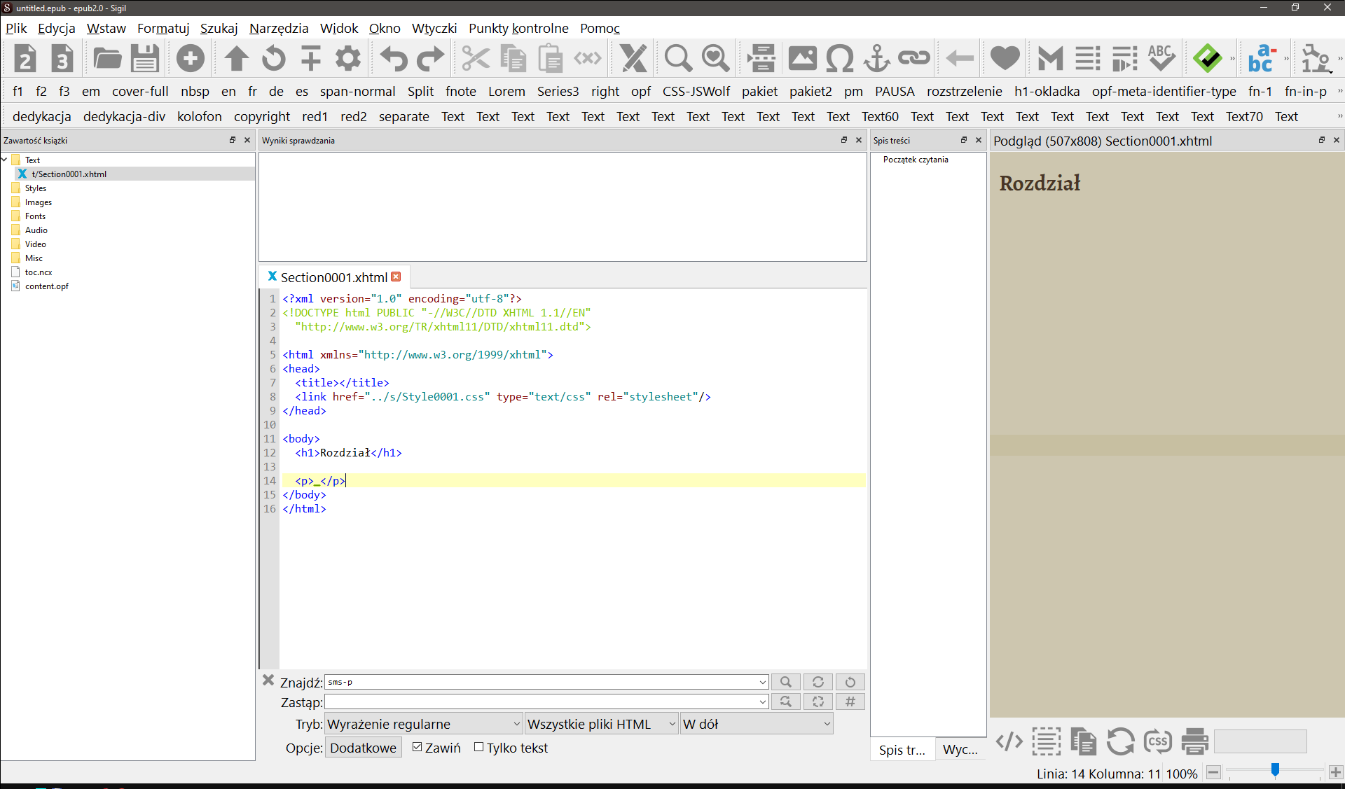

So it just adds a scroller to the end of the clip bar.
Perhaps instead of 80, we reduce it to 60 with 30 per line? Or make segments of sets of 10?

Agreed, 80 (and more) may be a bit much but I could see maybe going from 20 per clip toolbar to 30 per clip tool bar (giving a total of 60 clip icons). There appears to be room on those bars and users can always hide both and use the clip window if they so desire.

Now that you know how to tweak Sigil clips toolbars on your own you can have as many as you want.
We were discussing if Sigil master needs anymore than the 40 they have now or not. Typically making clips for very rarely used xhtml tags, and replicating existing h1-h6 tags icons may not be the most judicious use of clips.
By picking what clips to make wisely and following Pareto's 20% : 80% rule, most normal clip cases can be covered by the 40 existing clips icons available now, with rarer clips applied via the Clips Window..
I agree with this.
Toolbars with clips are very useful because using them is the fastest.
Add only the ones used most often to the toolbars and that should be enough for most users.
Clip Editor has more options and also allows you to group clips thematically.
IMHO I would not change this. 20+20 should be enough for "handy clips".
Returning to the issue of the invisible '>>' icon at the end of the toolbars: the problem only occurs on Windows in dark mode.
I have already worked out a simple solution, I will prepare PR once the new version of Sigil is released.
