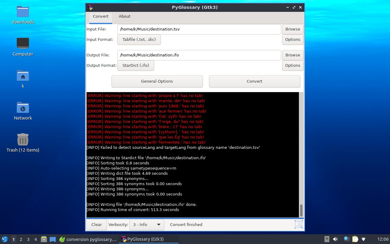

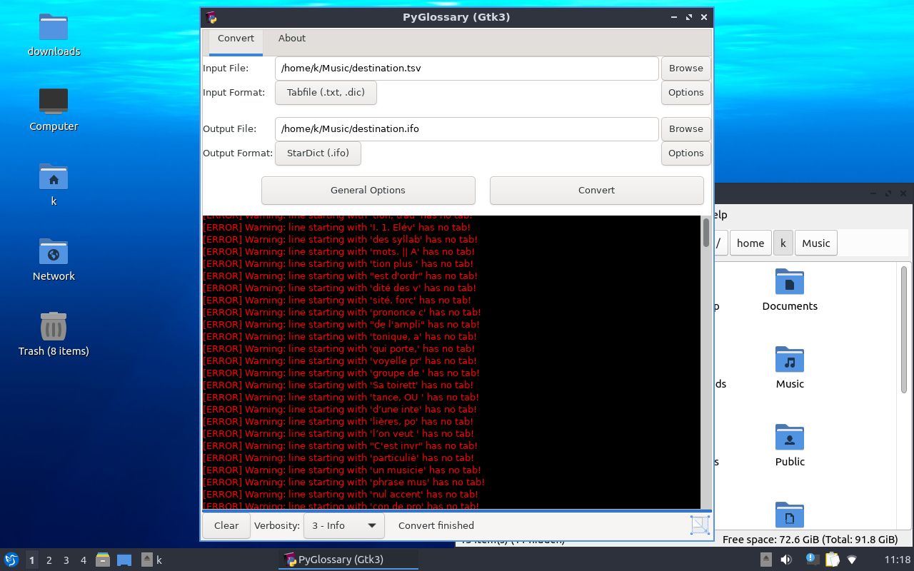

pyglossary conversion of tsv file
Good afternoon M. Samart89,
Pyglossary did indeed use the tsv file. Here are two images included(hope they are attached correctly).
Lots of no tab errors, not the headwords,but just text. And the index .idx file is probably corrupt.
I didn't put the files into koreader to try them thinking it useless to do so.
Please take a look at the images enclosed. Please not the question marks on the index and synonym files.
Cordially,
pz

You seem to have spurious line breaks in your destination.tsv file. Use the file with long lines obtained in the post 35 to add the tabulation.
