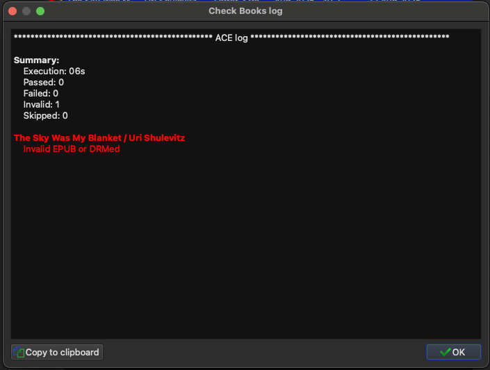

I mean running it like in the first attached image.

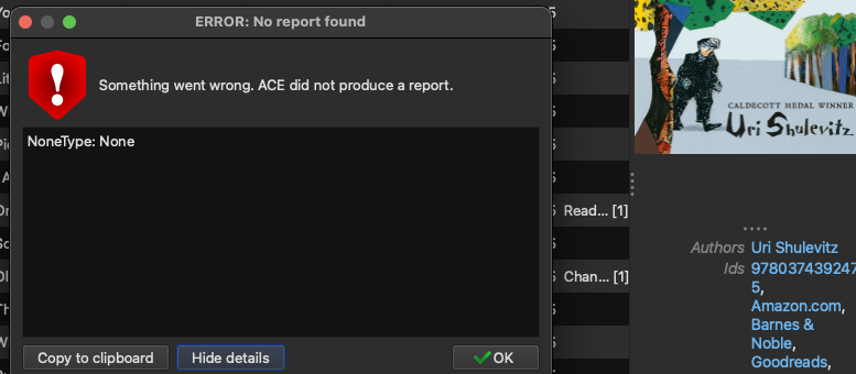

Thanks, but I'm still having the same issues. See attached images, one from running from Terminal, one without. Note that the issues are the same for all EPUBs.

I remembered another Mac user having a similar problem. Maybe his solution works for you: https://www.mobileread.com/forums/sh...9&postcount=31
Originally Posted by uhh.andy View Post
I figured out what the problem was.
I had installed node with homebrew, and for apple silicon Macs the executables are put in '/opt/homebrew/bin' which was not in the PATH when subprocess.Popen ran ace.
Adding it to the path fixed the issue.
