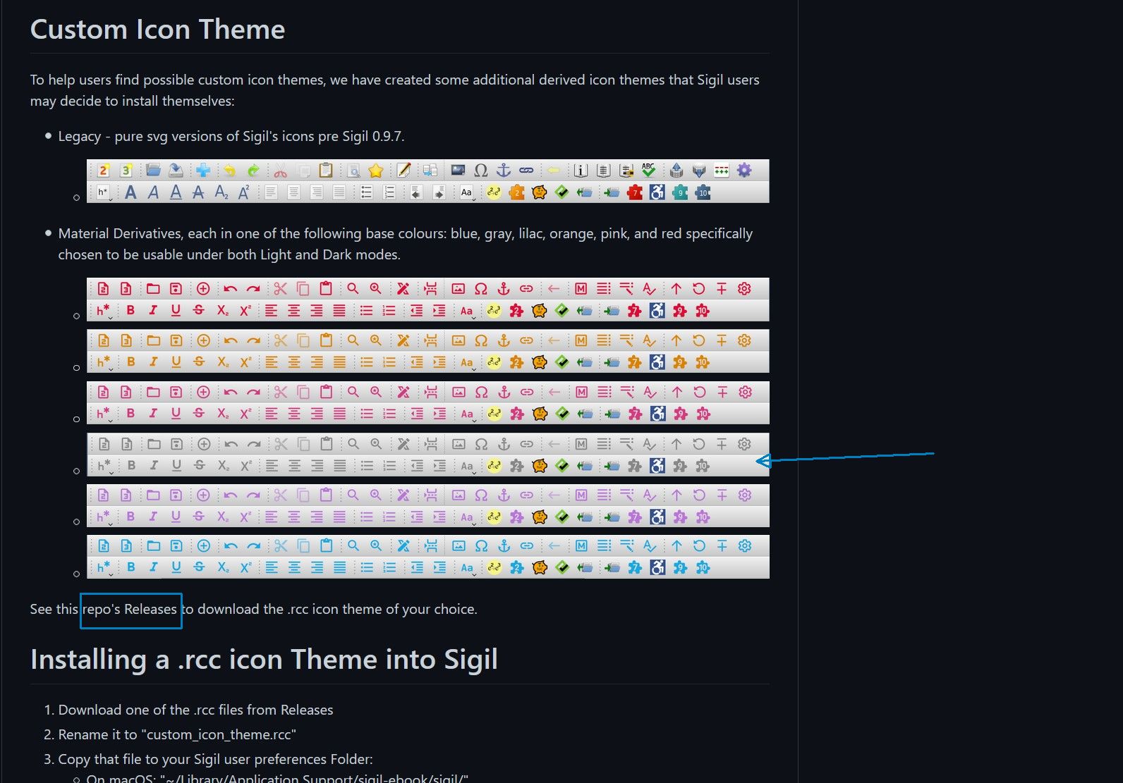

Can you give me a direct link to the .rcc file indicated in the attachment; not sure what 'this repo's releases' means - pretty sure its nothing to do with a repurchase agreement for US Treasury bonds
Thanks BR

https://github.com/Sigil-Ebook/IconThemes/releases
Use material-gray.rcc

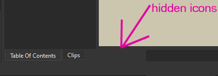

You can "hidden" these icons –> use color for icons == color of background toolbar (attached file)
1. Resize icons to minimal
2. Enable custom icons
3. Download and extract file custom_icon_theme.rcc and place it in Sigil Preferences Folder
