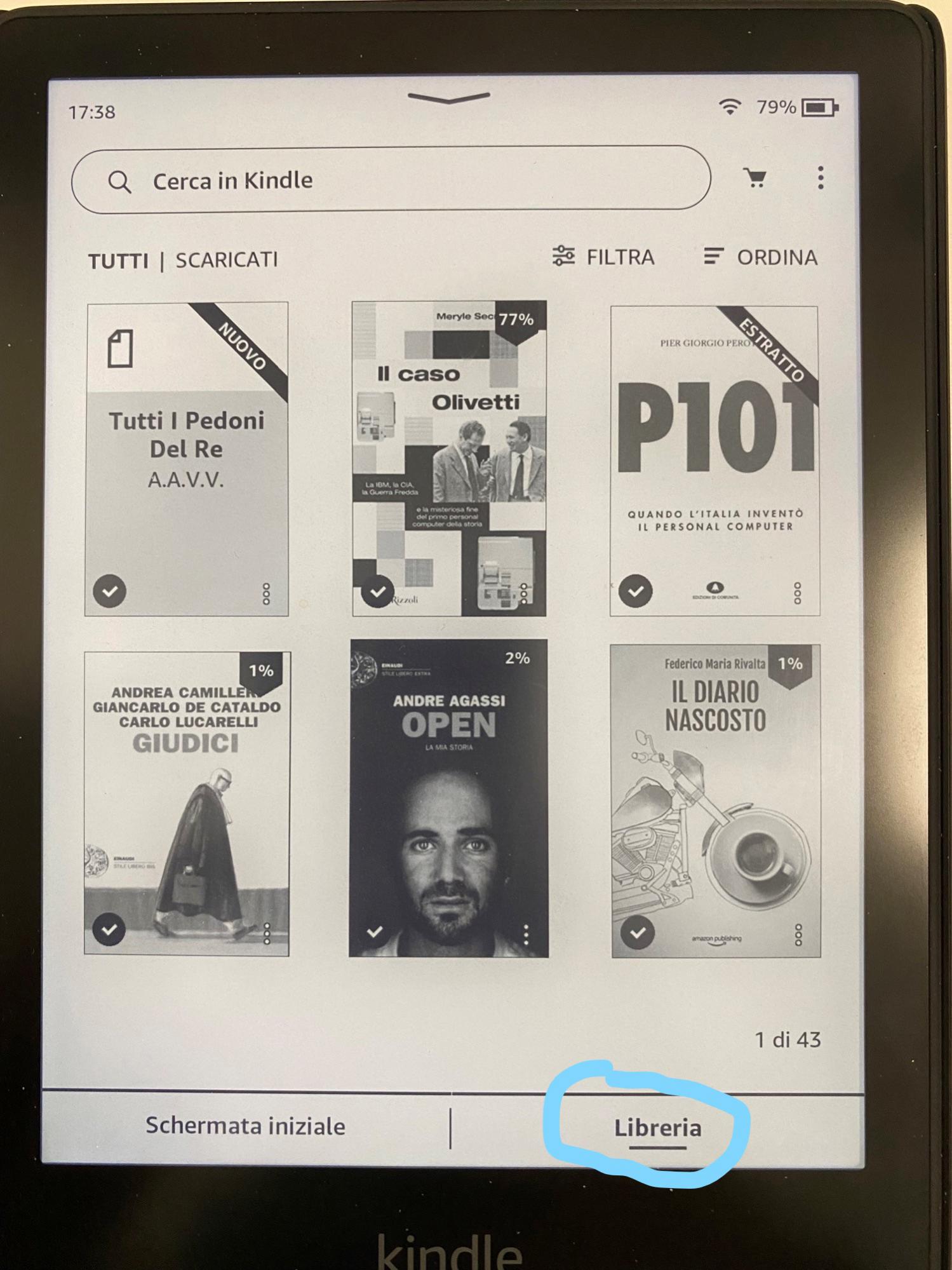

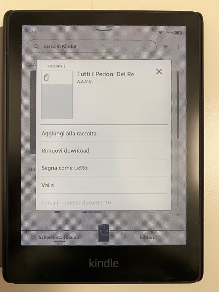

Thanks jhowell for the answer. The strange thing is that using the no Calibre ebook there is only one situation the thumbnail cover is show by my Kindle. See attached images.
But... it's ok the problem is the cover size
Stefano

No...maybe I'm wrong, but isn't one a PDOC (Personal Document) and the other a book?
Hitch
No, it's the same MOBI ebook (title "Tutti i pedoni del re") that is sideloaded via email to my kindle. It' s not converted with Calibre.
