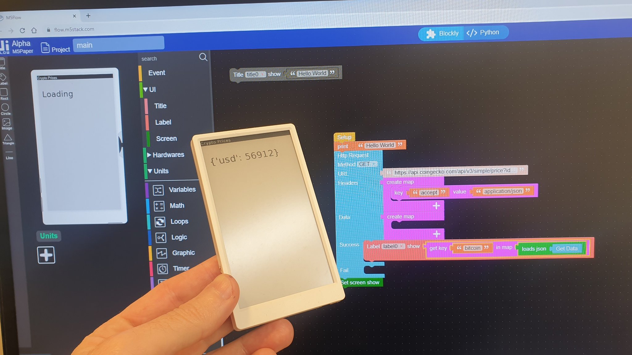

How easy it is to read a JSON REST API and display it on the M5Paper with UIFlow (not my project, from https://twitter.com/simonvc/status/1363249199689715726)
