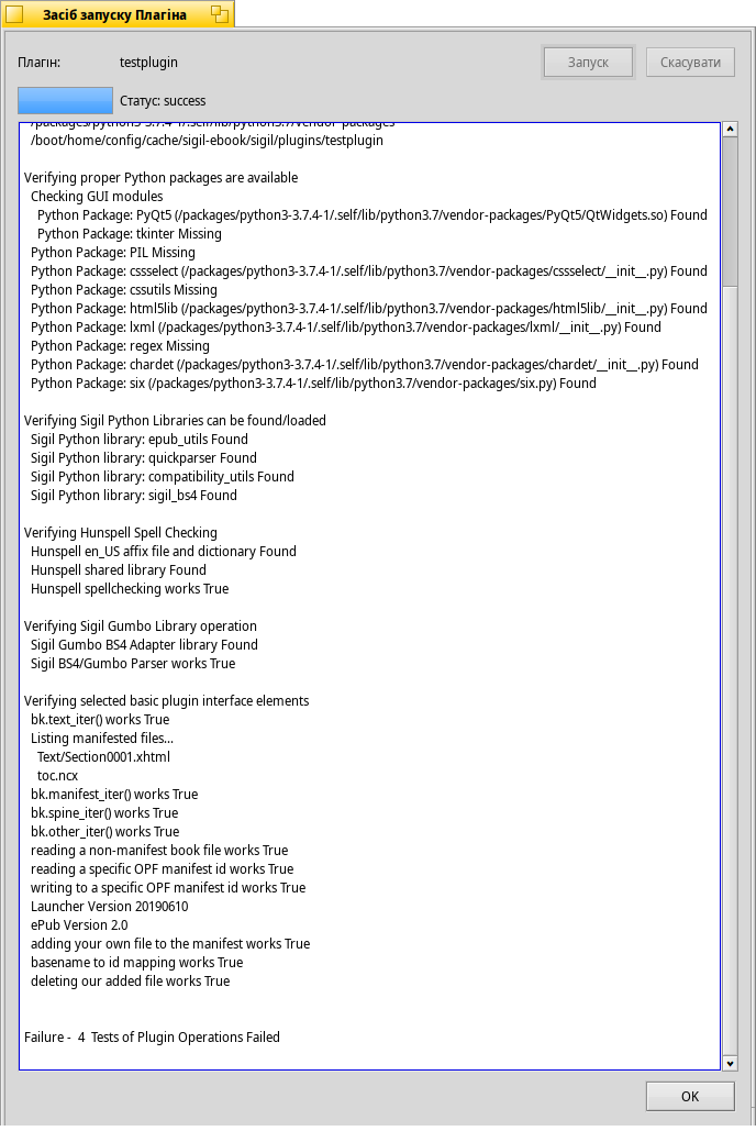

In the assembly recipe, this option is set.
	cmake .. \
		-DCMAKE_BUILD_TYPE=Release \
		-DCMAKE_INSTALL_PREFIX=$appsDir/Sigil \
		-DCMAKE_INSTALL_BINDIR=$appsDir/Sigil \
		-DSHARE_INSTALL_PREFIX=$appsDir/Sigil \
		-DCMAKE_INSTALL_LIBDIR=$appsDir/Sigil/lib \
		-DPYTHON_LIBRARY=$pythonLib \
		-DPYTHON_INCLUDE_DIR=$pythonInclude \
		-DPYTHON_EXECUTABLE=$pythonBin \
		-DUSE_SYSTEM_LIBS=1 \
		-DINSTALL_BUNDLED_DICTS=0
Maybe the problem is something else?
For example in this library tkinter or other path?

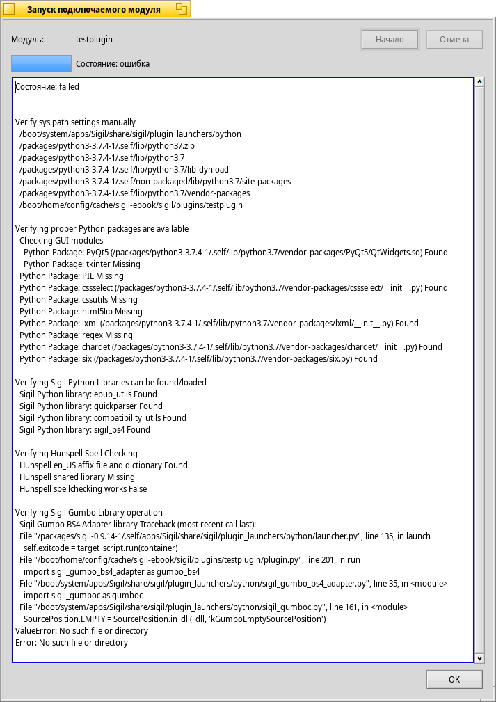

Test Plugins...

Looks much better. You can fix 2 of those failures quite easily by installing the python projects: cssutils and regex. Both are pure python modules so should install with no problems. You should also try to install PIL (pillow) for graphics support. That should only leave tk grpahics module.
Has no one ported the tcl / tk libraries to Haiku? They are typically one of the first graphics libraries ported as they allow graphical user interfaces for perl, and python.

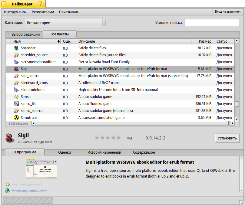

HaikuDepot...

Originally Posted by User_Z View Post
HaikuDepot...
IMHO The description is still the OLD one. (Devs: can we purge this everywhere?)
Silgil is not WYSWYG in the sense that you work in the resultant (formerly Bookview) view
We've purged it everywhere we have the power to do so. As BR already mentioned, however, the version of Sigil available on Haiki IS still a WYSIWYG version of Sigil.
