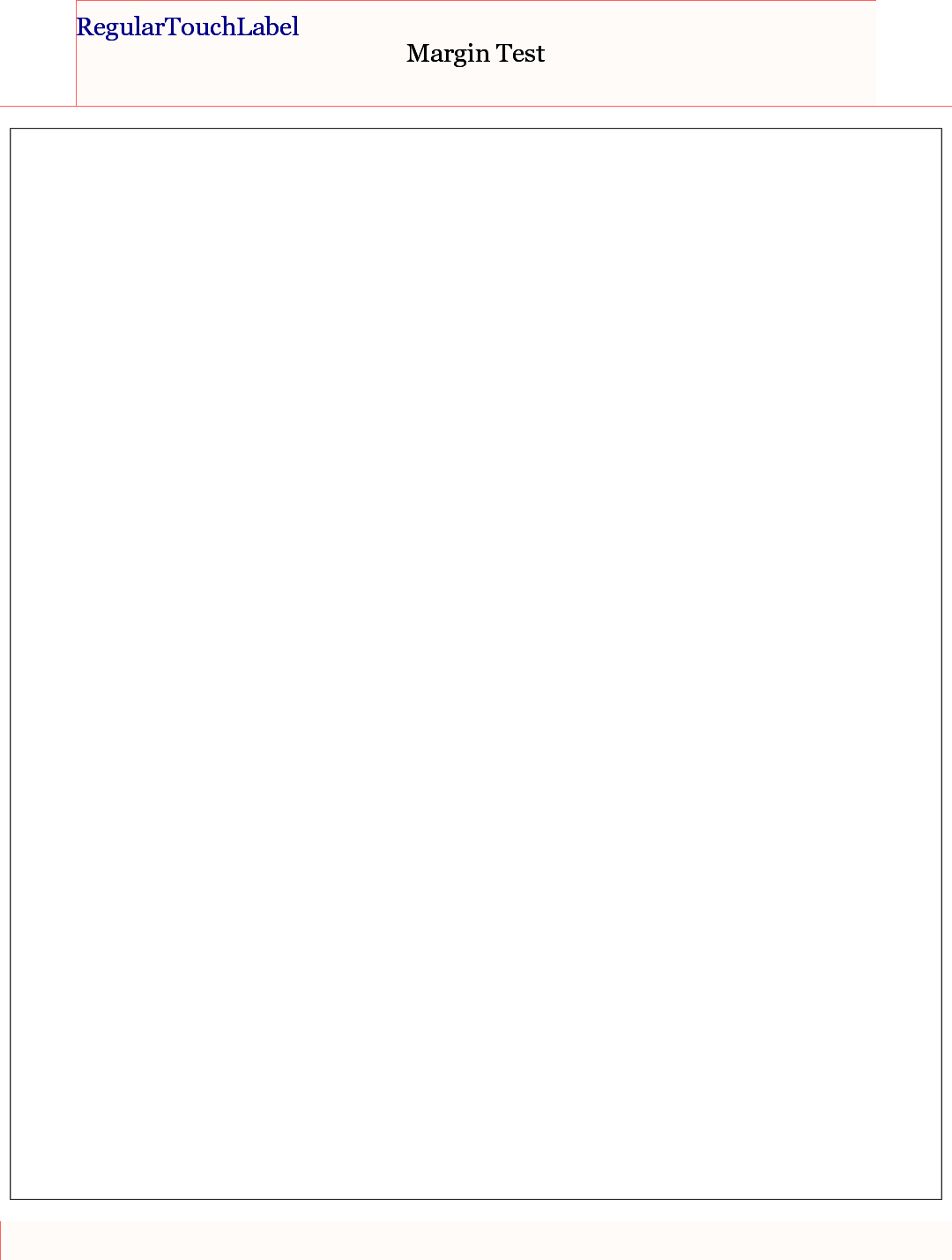

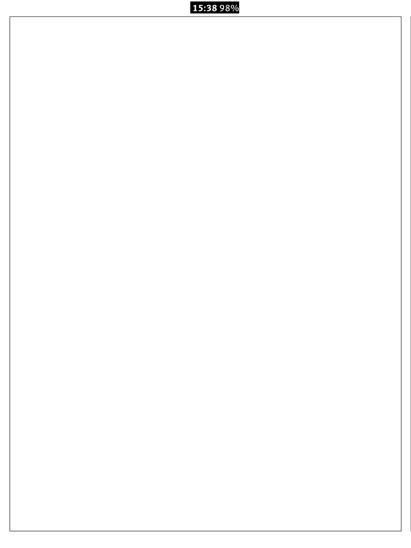

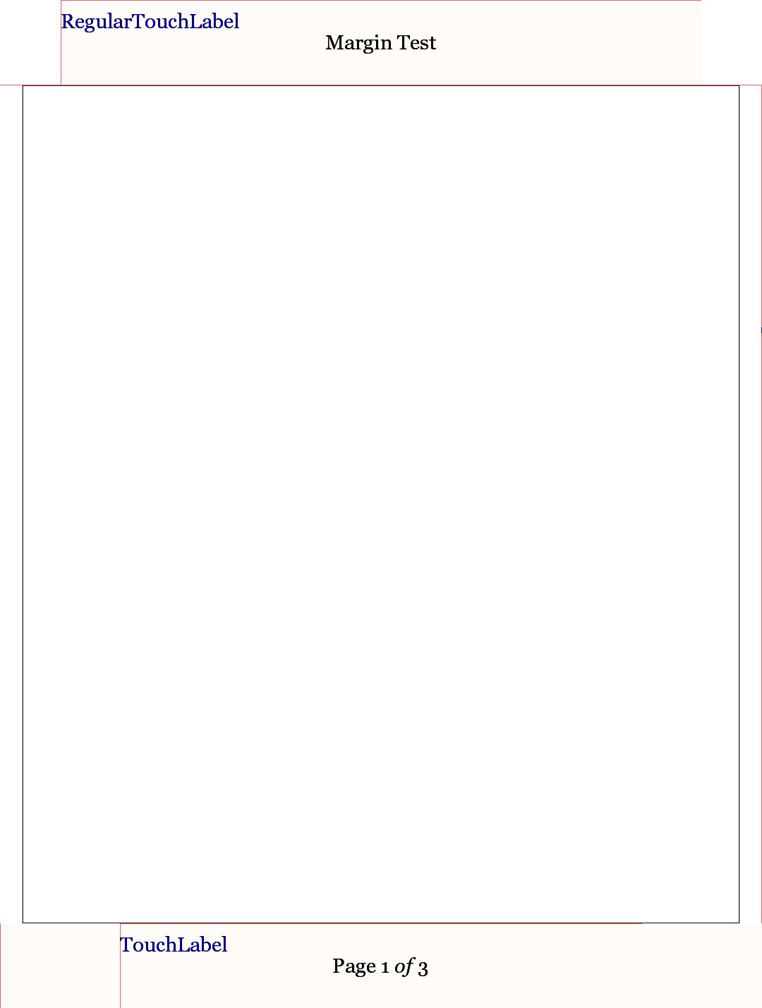

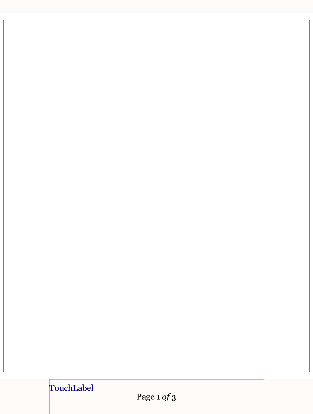

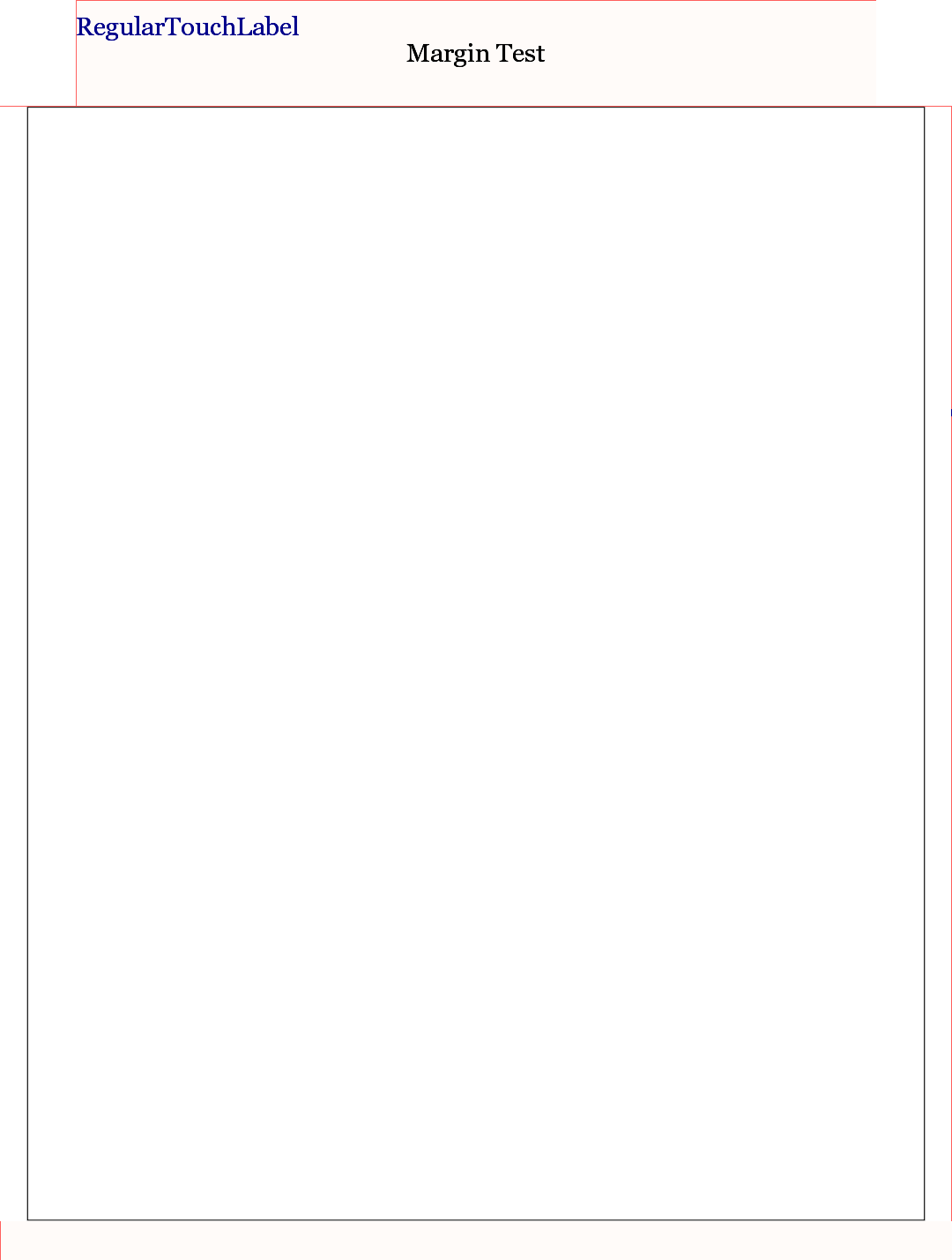

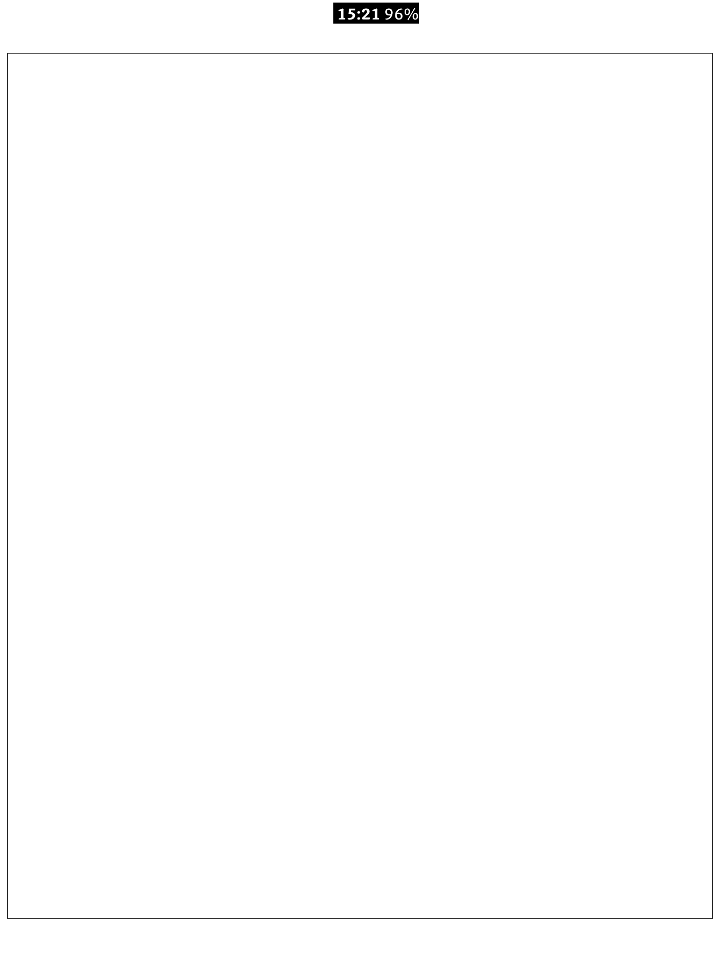

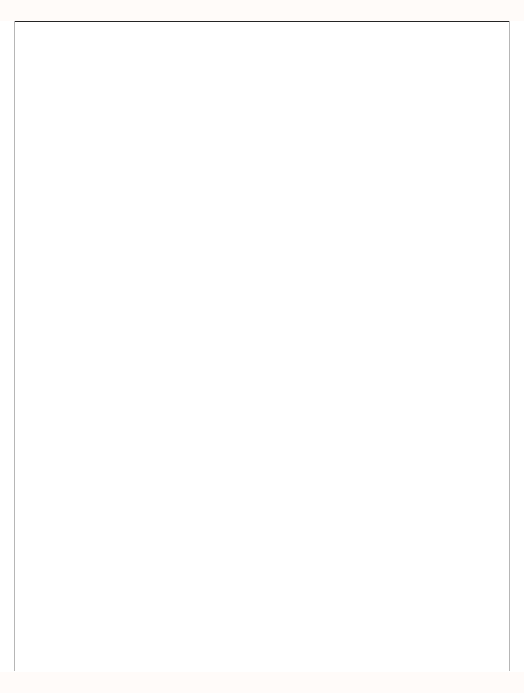

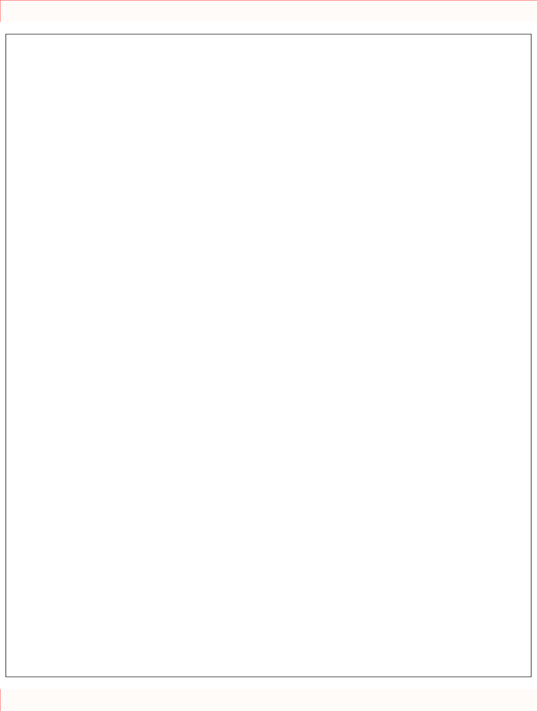

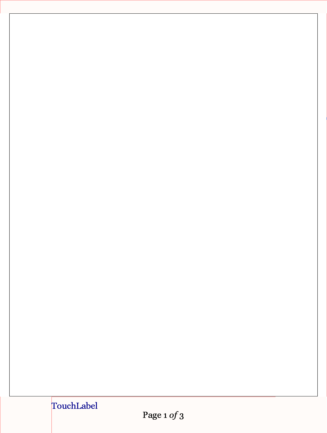

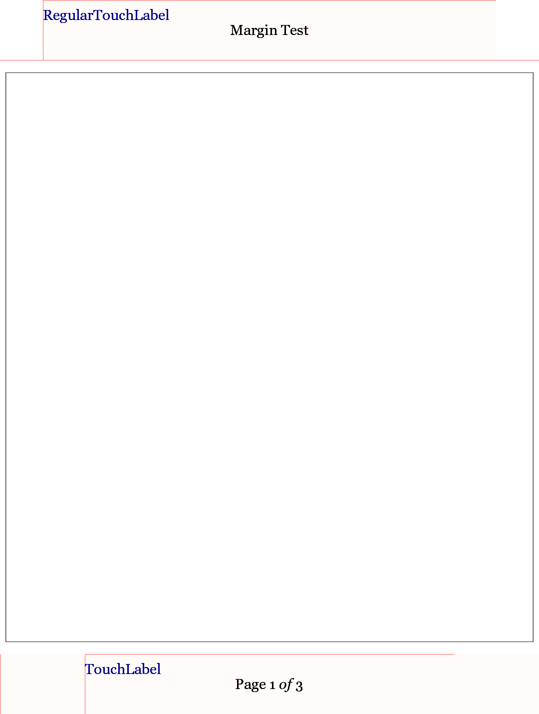

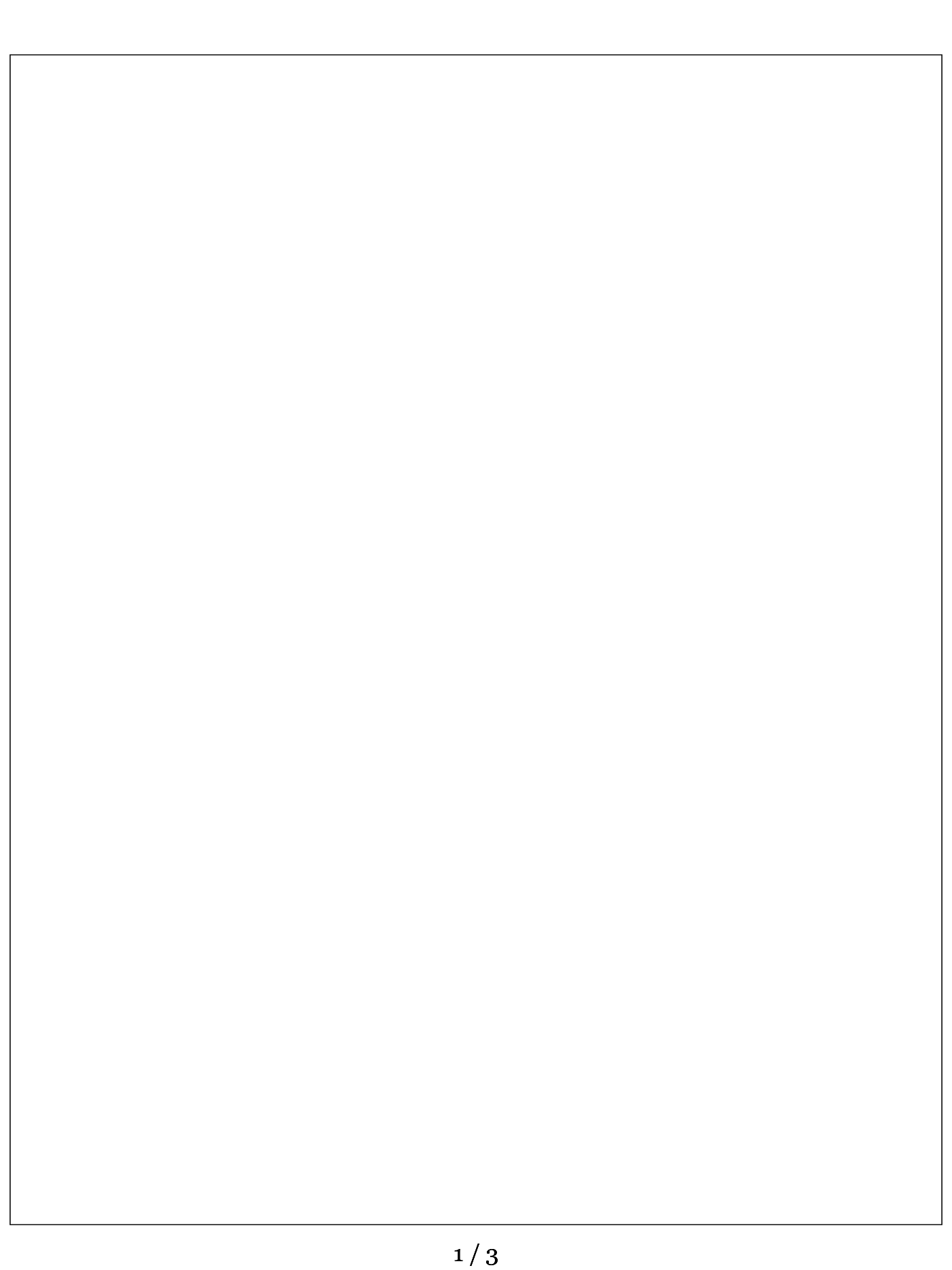

Testing ePub viewport
Could someone who is familliar with the ePub reader test these patches (one at a time) and let me know how they affect the header/footer size in ePub books when the "Show title" / "Show footer" options are unticked?
Decrease ReaderService viewport height: (libnickel.so.1.0.0.yaml)
  - Enabled: yes
  - ReplaceBytes: {Offset: 0xB7D00C, FindH: D8 F8 04 30, ReplaceH: 43 46 59 68}
  - ReplaceBytes: {Offset: 0xB7D010, FindH: D8 F8 08 20, ReplaceH: 09 68 9A 68}
  - ReplaceBytes: {Offset: 0xB7D014, FindH: 19 68 12 68, ReplaceH: 12 68 00 3A}
  # Number of pixels to decrease by
  - ReplaceInt: {Offset: 0xB7D016, Find: 0, Replace: 48}
Increase ReaderService viewport height: (libnickel.so.1.0.0.yaml)
  - Enabled: no
  - ReplaceBytes: {Offset: 0xB7D014, FindH: 19 68 12 68, ReplaceH: 12 68 00 32}
  # Number of pixels to increase by
I tried them with firmware 4.8.11073 and decreasing the height seemed to work as I would expect, the area available for book content decreased and remained vertically centred, but increasing it didn't work at all. Maybe it will give a clue where to look for a solution though.
Old 12-19-2018, 10:53 AM   #71
jcn363
absolute beginner
jcn363 ought to be getting tired of karma fortunes by now.jcn363 ought to be getting tired of karma fortunes by now.jcn363 ought to be getting tired of karma fortunes by now.jcn363 ought to be getting tired of karma fortunes by now.jcn363 ought to be getting tired of karma fortunes by now.jcn363 ought to be getting tired of karma fortunes by now.jcn363 ought to be getting tired of karma fortunes by now.jcn363 ought to be getting tired of karma fortunes by now.jcn363 ought to be getting tired of karma fortunes by now.jcn363 ought to be getting tired of karma fortunes by now.jcn363 ought to be getting tired of karma fortunes by now.
jcn363's Avatar
Posts: 323
Karma: 1750999
Join Date: May 2017
Location: Go with the wind (43°19'17.7"N 2°00'19.4"W)
Device: ka1
KA1 with 4.12.12111.
If you need something more...
Good luck.
ID:	168464   Click image for larger version
ID:	168465   Click image for larger version
ID:	168466   Click image for larger version
ID:	168467   Click image for larger version
ID:	168468   Click image for larger version
ID:	168469   Click image for larger version
ID:	168470   Click image for larger version

Not sure if that's going to be helpful, but by playing with a few debugging features, we can get the widget class names logged.
(Right now, I've got EnableDebugServices, EnableInspector & ShowWidget in DeveloperSettings, and ShowLayoutRectangles in FeatureSettings. It's... err, busy ;D).
With header & footer hidden, that's:
Dec 19 18:53:12 nickel: (   248.895 @ 0x553010 / ui.debug) draw widget:  46 QStackedWidget QRect(0,11 1080x1429)
Dec 19 18:53:12 nickel: (   248.896 @ 0x553010 / ui.debug) ===> parent widget:  AbstractMainWindow
Dec 19 18:53:12 nickel: (   248.941 @ 0x553010 / ui.debug) draw widget:  46 QFrame QRect(0,55 1080x1341)
Dec 19 18:53:12 nickel: (   248.941 @ 0x553010 / ui.debug) ===> parent widget:  ReadingView
(both ePub & kePub).
1429 is indeed the effective height of the H2O (Out of the 1440, hence the 0, 11 offset).
And 1429 - 1341 == 44*2, so that tracks with what we got from the screenshots.
I'll check GeoffR's experimental patches next .

First round of tests with the "Decrease" patch (on a H2O).
Footer + Header:
Dec 19 19:58:28 nickel: (   643.716 @ 0x553010 / ui.debug) draw widget:  46 QStackedWidget QRect(0,11 1080x1429)
Dec 19 19:58:28 nickel: (   643.716 @ 0x553010 / ui.debug) ===> parent widget:  AbstractMainWindow
Dec 19 19:58:28 nickel: (   643.762 @ 0x553010 / ui.debug) draw widget:  46 QFrame QRect(0,132 1080x1188)
Dec 19 19:58:28 nickel: (   643.762 @ 0x553010 / ui.debug) ===> parent widget:  ReadingView
Dec 19 19:58:28 nickel: (   643.838 @ 0x553010 / ui.debug) draw widget:  46 TouchLabel QRect(170,1320 740x120) "Page 1 <i>of</i> 3"
Dec 19 19:58:28 nickel: (   643.838 @ 0x553010 / ui.debug) ===> parent widget:  ReadingFooter
Dec 19 19:58:28 nickel: (   643.842 @ 0x553010 / ui.debug) draw widget:  46 RegularTouchLabel QRect(86,11 908x120) "Margin Test"
Dec 19 19:58:28 nickel: (   643.843 @ 0x553010 / ui.debug) ===> parent widget:  GenericContainerWidget
Dec 19 19:58:28 nickel: (   643.847 @ 0x553010 / ui.debug) draw widget:  46 QLabel QRect(0,131 1080x1) ""
Dec 19 19:58:28 nickel: (   643.847 @ 0x553010 / ui.debug) ===> parent widget:  StatusBarView
No Header:
Dec 19 19:59:58 nickel: (   733.480 @ 0x553010 / ui.debug) draw widget:  46 QStackedWidget QRect(0,11 1080x1429)
Dec 19 19:59:58 nickel: (   733.480 @ 0x553010 / ui.debug) ===> parent widget:  AbstractMainWindow
Dec 19 19:59:58 nickel: (   733.525 @ 0x553010 / ui.debug) draw widget:  46 QFrame QRect(0,55 1080x1265)
Dec 19 19:59:58 nickel: (   733.526 @ 0x553010 / ui.debug) ===> parent widget:  ReadingView
Dec 19 19:59:58 nickel: (   733.606 @ 0x553010 / ui.debug) draw widget:  46 TouchLabel QRect(170,1320 740x120) "Page 1 <i>of</i> 3"
Dec 19 19:59:58 nickel: (   733.606 @ 0x553010 / ui.debug) ===> parent widget:  ReadingFooter
No Footer:
Dec 19 20:01:05 nickel: (   800.190 @ 0x553010 / ui.debug) draw widget:  46 QStackedWidget QRect(0,11 1080x1429)
Dec 19 20:01:05 nickel: (   800.191 @ 0x553010 / ui.debug) ===> parent widget:  AbstractMainWindow
Dec 19 20:01:05 nickel: (   800.236 @ 0x553010 / ui.debug) draw widget:  46 QFrame QRect(0,132 1080x1264)
Dec 19 20:01:05 nickel: (   800.237 @ 0x553010 / ui.debug) ===> parent widget:  ReadingView
Dec 19 20:01:05 nickel: (   800.318 @ 0x553010 / ui.debug) draw widget:  46 RegularTouchLabel QRect(86,11 908x120) "Margin Test"
Dec 19 20:01:05 nickel: (   800.318 @ 0x553010 / ui.debug) ===> parent widget:  GenericContainerWidget
Dec 19 20:01:05 nickel: (   800.323 @ 0x553010 / ui.debug) draw widget:  46 QLabel QRect(0,131 1080x1) ""
Dec 19 20:01:05 nickel: (   800.323 @ 0x553010 / ui.debug) ===> parent widget:  StatusBarView
FS:
Dec 19 20:01:53 nickel: (   848.100 @ 0x553010 / ui.debug) draw widget:  46 QStackedWidget QRect(0,11 1080x1429)
Dec 19 20:01:53 nickel: (   848.100 @ 0x553010 / ui.debug) ===> parent widget:  AbstractMainWindow
Dec 19 20:01:53 nickel: (   848.146 @ 0x553010 / ui.debug) draw widget:  46 QFrame QRect(0,55 1080x1341)
Dec 19 20:01:53 nickel: (   848.146 @ 0x553010 / ui.debug) ===> parent widget:  ReadingView
(In the FS case, you can see the extra 24 pixels on each side in *pure white*, vs. the *very nearly white* hard margin. Colors courtesy of one of the debug setting mentioned earlier).
ID:	168481   Click image for larger version

And with the Increase patch:
Footer + Header:
Dec 19 20:11:31 nickel: (   185.993 @ 0x553010 / ui.debug) draw widget:  46 QStackedWidget QRect(0,11 1080x1429)
Dec 19 20:11:31 nickel: (   185.993 @ 0x553010 / ui.debug) ===> parent widget:  AbstractMainWindow
Dec 19 20:11:31 nickel: (   186.038 @ 0x553010 / ui.debug) draw widget:  46 QFrame QRect(0,132 1080x1188)
Dec 19 20:11:31 nickel: (   186.038 @ 0x553010 / ui.debug) ===> parent widget:  ReadingView
Dec 19 20:11:31 nickel: (   186.113 @ 0x553010 / ui.debug) draw widget:  46 TouchLabel QRect(1079,132 108x1429) ""
Dec 19 20:11:31 nickel: (   186.113 @ 0x553010 / ui.debug) ===> parent widget:  N3AdobeReader
Dec 19 20:11:31 nickel: (   186.116 @ 0x553010 / ui.debug) draw widget:  46 TouchLabel QRect(170,1320 740x120) "Page 1 <i>of</i> 3"
Dec 19 20:11:31 nickel: (   186.116 @ 0x553010 / ui.debug) ===> parent widget:  ReadingFooter
Dec 19 20:11:31 nickel: (   186.120 @ 0x553010 / ui.debug) draw widget:  46 RegularTouchLabel QRect(86,11 908x120) "Margin Test"
Dec 19 20:11:31 nickel: (   186.121 @ 0x553010 / ui.debug) ===> parent widget:  GenericContainerWidget
Dec 19 20:11:31 nickel: (   186.125 @ 0x553010 / ui.debug) draw widget:  46 QLabel QRect(0,131 1080x1) ""
Dec 19 20:11:31 nickel: (   186.125 @ 0x553010 / ui.debug) ===> parent widget:  StatusBarView
No Header:
Dec 19 20:13:13 nickel: (   287.650 @ 0x553010 / ui.debug) draw widget:  46 QStackedWidget QRect(0,11 1080x1429)
Dec 19 20:13:13 nickel: (   287.650 @ 0x553010 / ui.debug) ===> parent widget:  AbstractMainWindow
Dec 19 20:13:13 nickel: (   287.695 @ 0x553010 / ui.debug) draw widget:  46 QFrame QRect(0,55 1080x1265)
Dec 19 20:13:13 nickel: (   287.696 @ 0x553010 / ui.debug) ===> parent widget:  ReadingView
Dec 19 20:13:13 nickel: (   287.776 @ 0x553010 / ui.debug) draw widget:  46 TouchLabel QRect(1079,55 108x1429) ""
Dec 19 20:13:13 nickel: (   287.776 @ 0x553010 / ui.debug) ===> parent widget:  N3AdobeReader
Dec 19 20:13:13 nickel: (   287.778 @ 0x553010 / ui.debug) draw widget:  46 TouchLabel QRect(170,1320 740x120) "Page 1 <i>of</i> 3"
Dec 19 20:13:13 nickel: (   287.779 @ 0x553010 / ui.debug) ===> parent widget:  ReadingFooter
No Footer:
Dec 19 20:14:04 nickel: (   338.344 @ 0x553010 / ui.debug) draw widget:  46 QStackedWidget QRect(0,11 1080x1429)
Dec 19 20:14:04 nickel: (   338.344 @ 0x553010 / ui.debug) ===> parent widget:  AbstractMainWindow
Dec 19 20:14:04 nickel: (   338.390 @ 0x553010 / ui.debug) draw widget:  46 QFrame QRect(0,132 1080x1264)
Dec 19 20:14:04 nickel: (   338.390 @ 0x553010 / ui.debug) ===> parent widget:  ReadingView
Dec 19 20:14:04 nickel: (   338.470 @ 0x553010 / ui.debug) draw widget:  46 TouchLabel QRect(1079,132 108x1429) ""
Dec 19 20:14:04 nickel: (   338.470 @ 0x553010 / ui.debug) ===> parent widget:  N3AdobeReader
Dec 19 20:14:04 nickel: (   338.473 @ 0x553010 / ui.debug) draw widget:  46 RegularTouchLabel QRect(86,11 908x120) "Margin Test"
Dec 19 20:14:04 nickel: (   338.473 @ 0x553010 / ui.debug) ===> parent widget:  GenericContainerWidget
Dec 19 20:14:04 nickel: (   338.478 @ 0x553010 / ui.debug) draw widget:  46 QLabel QRect(0,131 1080x1) ""
Dec 19 20:14:04 nickel: (   338.479 @ 0x553010 / ui.debug) ===> parent widget:  StatusBarView
FS:
Dec 19 20:14:46 nickel: (   380.719 @ 0x553010 / ui.debug) draw widget:  46 QStackedWidget QRect(0,11 1080x1429)
Dec 19 20:14:46 nickel: (   380.719 @ 0x553010 / ui.debug) ===> parent widget:  AbstractMainWindow
Dec 19 20:14:46 nickel: (   380.765 @ 0x553010 / ui.debug) draw widget:  46 QFrame QRect(0,55 1080x1341)
Dec 19 20:14:46 nickel: (   380.766 @ 0x553010 / ui.debug) ===> parent widget:  ReadingView
Dec 19 20:14:46 nickel: (   380.850 @ 0x553010 / ui.debug) draw widget:  46 TouchLabel QRect(1079,55 108x1429) ""
Dec 19 20:14:46 nickel: (   380.851 @ 0x553010 / ui.debug) ===> parent widget:  N3AdobeReader
So, yeah, no dice.
Not quite sure why one of them seemed to affect the L/R margins like that, though. (MarginLeft/MarginRight is set to 1, not 0. if I set it to 0, I *think* that matches dec @ 1, FWIW. Which is how my LR margins usually look.).
