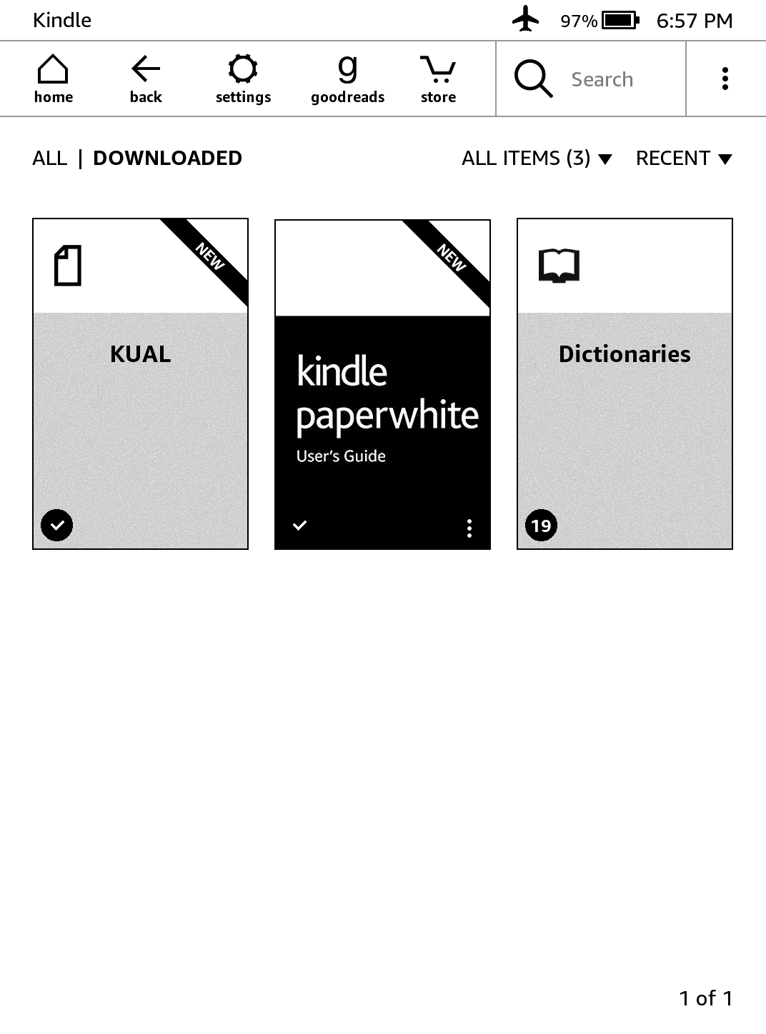

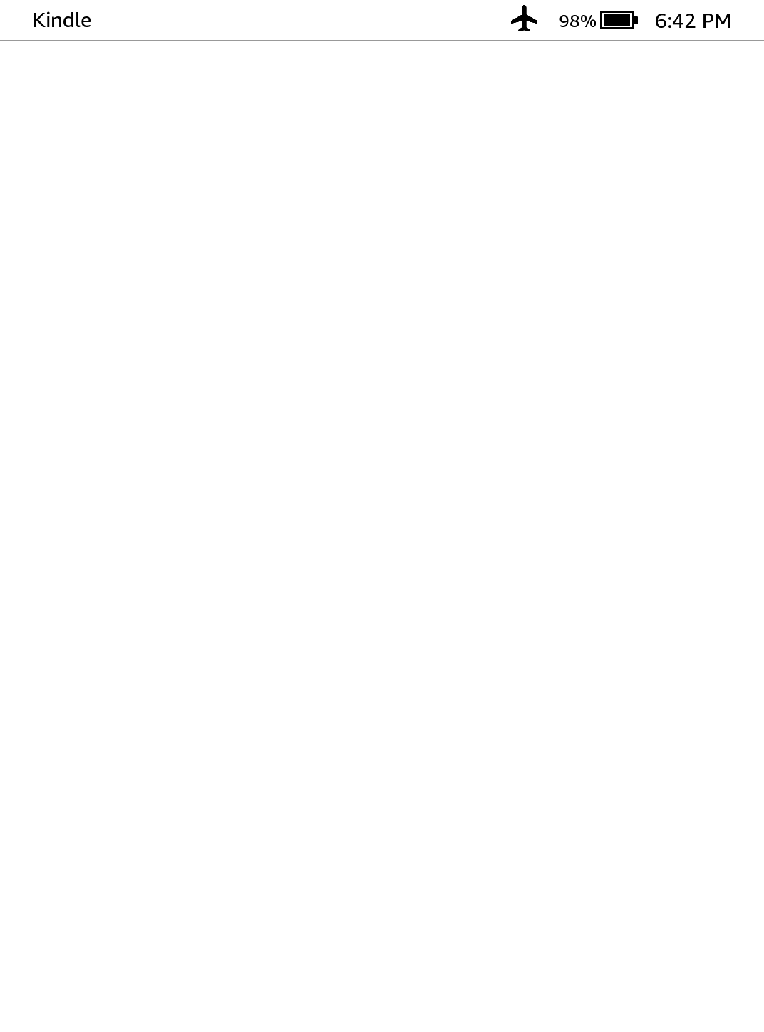

Device: Boox Palma
Thank you all! I'm grateful for your work and sharing these tools.
I was able to successfully jailbreak the Kindle (5.10.0.2) and I have updated to 5.10.1.2.
But I have run in to a problem...
I installed KUAL using MR Package Installer (;log mrpi). I was watching the screen and it flashed a message that the install was successful.
The KUAL booklet is showing on the screen, however, when I tap it to open KUAL, it is just a blank screen. The only items that show at the very top of the screen are the device name, airplane mode, battery, and time.
The only way to exit it is to hold the power button and restart the device.
My goal is to use KOReader on this Kindle.
I also tried installing (using mrpi) kpvbooklet (0.6.4, or 0.6.5 or 0.6.6) and the "destroying packages" message popped up on all three, so I'm not able to install that (at least not yet).
I also transferred an epub file to the Kindle and it is in the documents folder, but doesn't show in "Downloaded". (Edit: just wanted to add a note that I found that epub will not show unless you are using kpvbooklet, so disregard this comment as this is not an issue with KUAL.)
If anyone can help me troubleshoot, I would be grateful.
Thank you.
Attached a couple of screenshots.
PSA for PW4
Need to use KUAL booklet from here:
https://www.mobileread.com/forums/sh...&postcount=304

Originally Posted by ilovejedd View Post
PSA for PW4
Thank you!!!! KUAL is now working.
