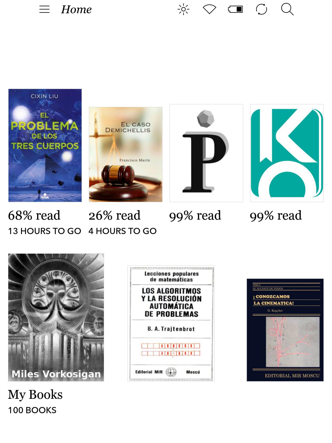

Is it possible to have screenshots of the two patches "Only Reading and My Books" and "Only Reading"?
Thank you
gillesit is offline   Reply With Quote
Thank you
Here
The first one is Only Reading.
The second and third one is Only Reading and My Books.
Good luck.

pics of only reading and only "my books, aka slot on left bottom"
Thank you
https://www.mobileread.com/forums/sh...4&postcount=60
Thank you
Originally Posted by scionmessenger View Post
Sorry, it's almost the same.
Good luck.

      Find:    "RegularTouchLabel {\n  font-family: Georgia;\n  font-style: italic;\n}\n\
                RegularTouchLabel[qApp_deviceIsTrilogy=true] {\n  font-size: 19px;\n}\n\
                RegularTouchLabel[qApp_deviceIsPhoenix=true] {\n  font-size: 23px;\n}\n\
                RegularTouchLabel[qApp_deviceIsDragon=true] {\n  font-size: 29px;\n}\n\
                RegularTouchLabel[qApp_deviceIsAlyssum=true] {\n  font-size: 32px;\n}\n\
                RegularTouchLabel[qApp_deviceIsNova=true] {\n  font-size: 32px;\n}\n\
                RegularTouchLabel[qApp_deviceIsDaylight=true] {\n  font-size: 37px;\n}"
      Replace: "RegularTouchLabel{font-family:Georgia;font-style:italic;font-size:37px;}"
Good luck.
