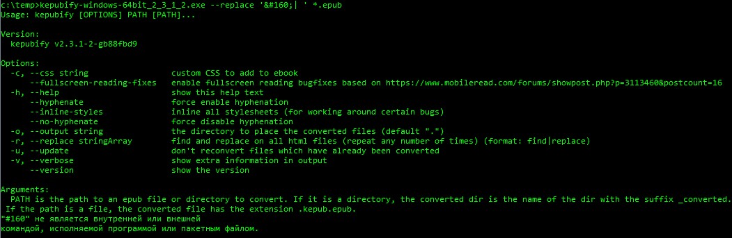

Have you tried to do this? It does not work for me: "#160" is not recognized as an internal or external command, operable program or batch file
You must quit the space between & and #.
Good luck.
Good luck.
Actually, I think the issue is escaping. Try adding a backslash before the ampersand.
Good luck.
There is no space
Did so. Without changes.
konstantinus is offline   Reply With Quote

Originally Posted by konstantinus View Post
There is no space
Try a ^ before the ampersand instead then.
Does not work.
Does not work.
What is the error? If you can't get it to work, I'll make a build for you which always removes the nbsps.

What is the error?
"string replace" is not recognized as an internal or external command, operable program or batch file.Click image for larger version
I now remove non-breaking spaces before converting kepubify: & # 160; do not appear, this is not a problem. The problem is to leave the original characters without getting & # 160; There should be non-breaking spaces, but there should not be a text & # 160;

Originally Posted by Semwize View Post
"& #160;| "
It was the beginning ...

Using the symbol «"» everything works, just checked
with «'» does not work
