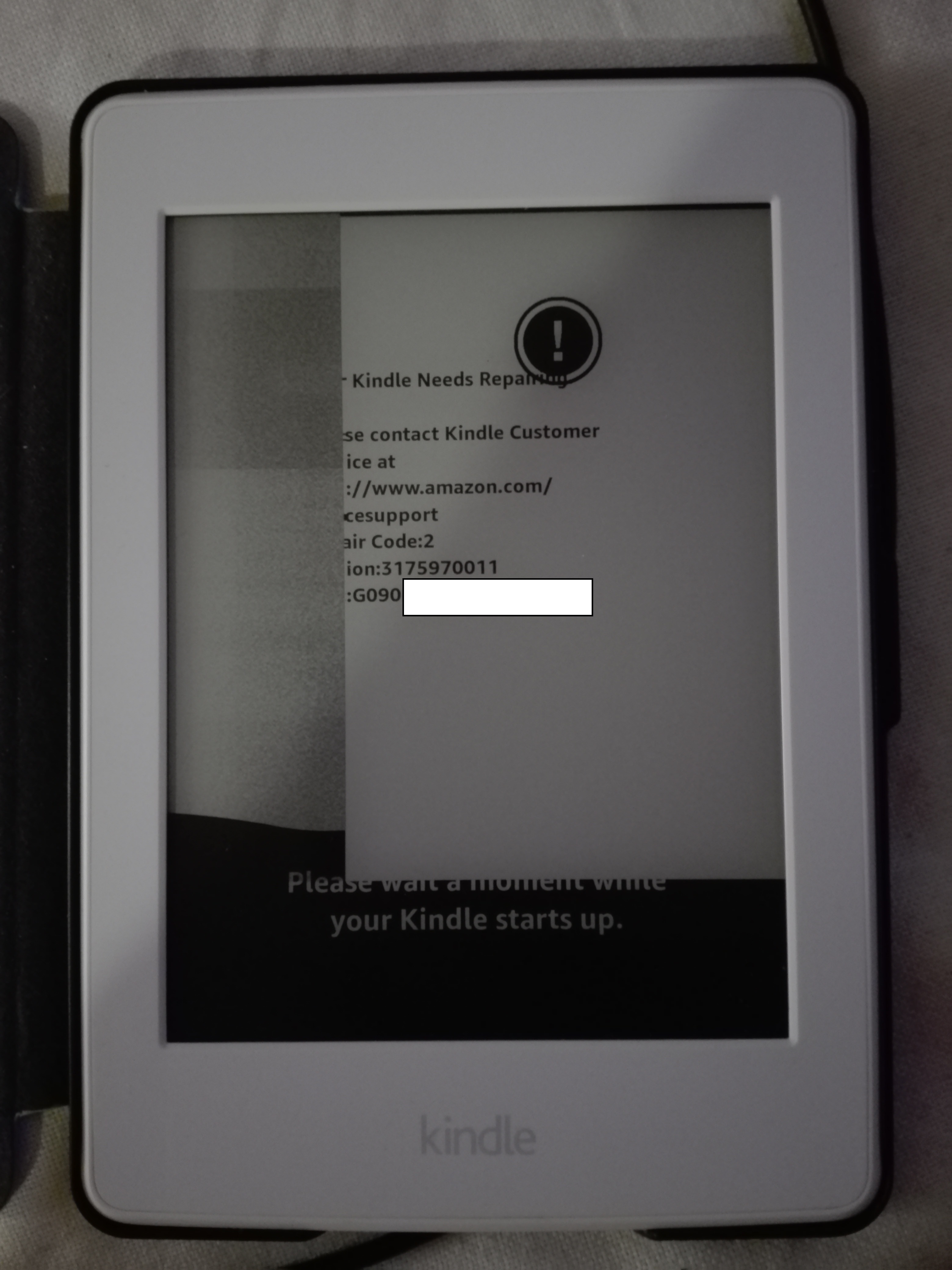

Thank you. At step 4, when I try to update to factory image, the result is a broken screen (picture attached). If I click on the white rectangle, it restarts and gives the same result. Is this some sort of boot loop? Sorry for my noobness, I just couldn't identify the problem.
Data: G090KB, 5.8.10.1, SO removed, parental control and passcode turned off, airplane mode turned on, has been registered with an Amazon account, MD5 hash of the .bin file matched.

If it is running 5.8.10.1 then the special image did not install.
Put the special image at the visible root of the Kindle, then reboot it.
As above, once more put the special image to the usb-root and reboot.
If failed, try other Amazon firmware update file (e.g. 5.8.11) - this case will make jailbreak impossible but might rescue the device.
Do not use DO_FACTORY_RESTORE method - it will brick the device and finally close usb access to it, and only serial port will help.
Thank you. The only piece of information the device lets me know is shown in the attached picture, so I can't tell for sure if it's still running 5.8.10.1.
I don't know how I can move the update file again to the PW, as it can't connect for more than a few seconds, while pasting the file on it takes a few minutes. And plugging in the USB (both to a wall charger and the PC) makes the device restart the booting with this broken screen at the end of the process (and the charger light turns off, too, after getting to this part). I tried holding the power button for 40 seconds, it repeats the booting (or loading, don't know which is the right word in this case) with the same result. So anything I do ends in the broken screen shown above.
If I missed something, please tell me. Thank you very much for your help!

It sure reads to me as if YOU wrote that it is running 5.8.10.1 now.
If it was running 5.8.10.1 BEFORE you started this, I would like you to re-read the title of this thread.
The procedure described here is ONLY for the PW3, running 5.8.9.0.1 AT THE TIME it is used on the device.
Note:
Originally Posted by first post
This is a hardware/firmware specific variation on the current software jailbreak.
Originally Posted by current software jailbreak
There is a single, complex, special case for 5.8.9.0.1 firmware version. If you get a Kindle with that firmware version, please just post in this thread before you do anything to it, your device **might** be one of the rare exceptions.
Whatever the situation was and whatever the situation is now, I can assure you that the image did not break your screen.
It might appear broken, but if it is broken, then it was something physical done to it.
You can tell the difference by watching to see if the left half of the screen ever changes when you reboot it.
Your choices now appear to be:
Since it is brand new, just purchased, return it for replacement.
or
De-brick it using the serial port.
(*) I have had a bunch of requests this week for the file required from people who clearly never read or read and refused to follow that part of the directions.
In every case, my initial response did not include access to the image file.
People who can not read the directions and people who can read but not follow the directions have no business trying anything they find here.
Everything on this site assumes people will read and follow the directions.
(And believe any replies of "No" they might receive.)
