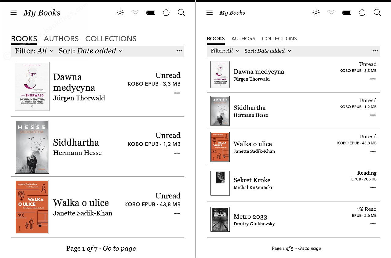

There is also one new option "Large Print Mode" in "Beta Features". You can use ereader even without reading glasses
