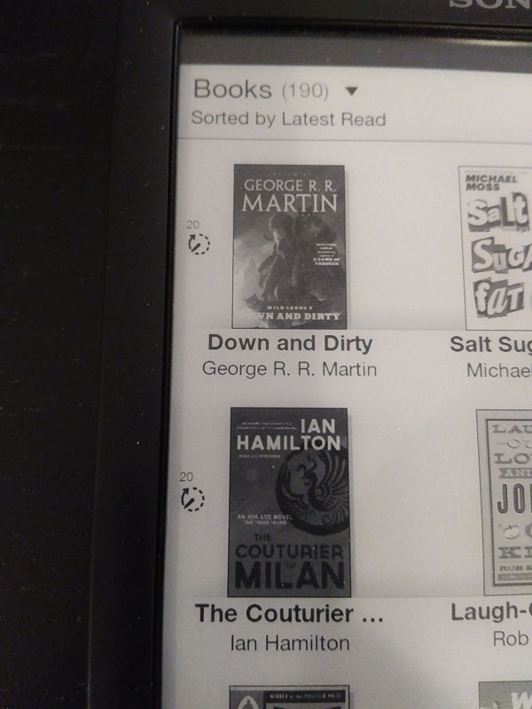

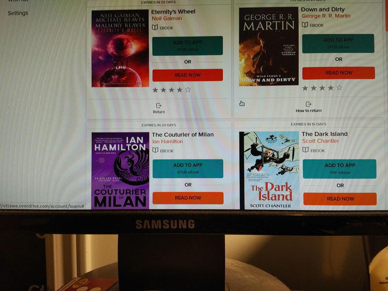

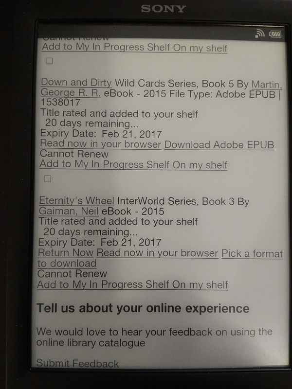

Here are some screen shots showing:
a) my loans as they appear in my desktop browser, showing the add to app button,
b) my loans as they appear on my T3, showing that for one book the alt-text still shows download and for another book the alt-text still shows select download format, even though the graphical buttons both say add to app
c) book successfully added to T3. I didn't touch anything using the PC before downloading to device.
I guess there is some little bug fix or upgrade to the T3 that makes it work? The link still does give me the ascm file in any case. If it was a matter of https support, the T1 shouldn't display any of the page at all. I'm surprised there is a difference between the devices.

Radius, it looks like you are using "<library_name>.overdrive.com" as opposed to the library's own website to download your books. When I use this method I am also able to download the epub without using my PC as I described in my post yesterday. That;s good news.
In your second image (T3view) you appear to be on the library's actual website and the second book has the "pick a format to download" option instead of the "download Adobe epub" option of your first. I expect you might have difficulty with the second.
