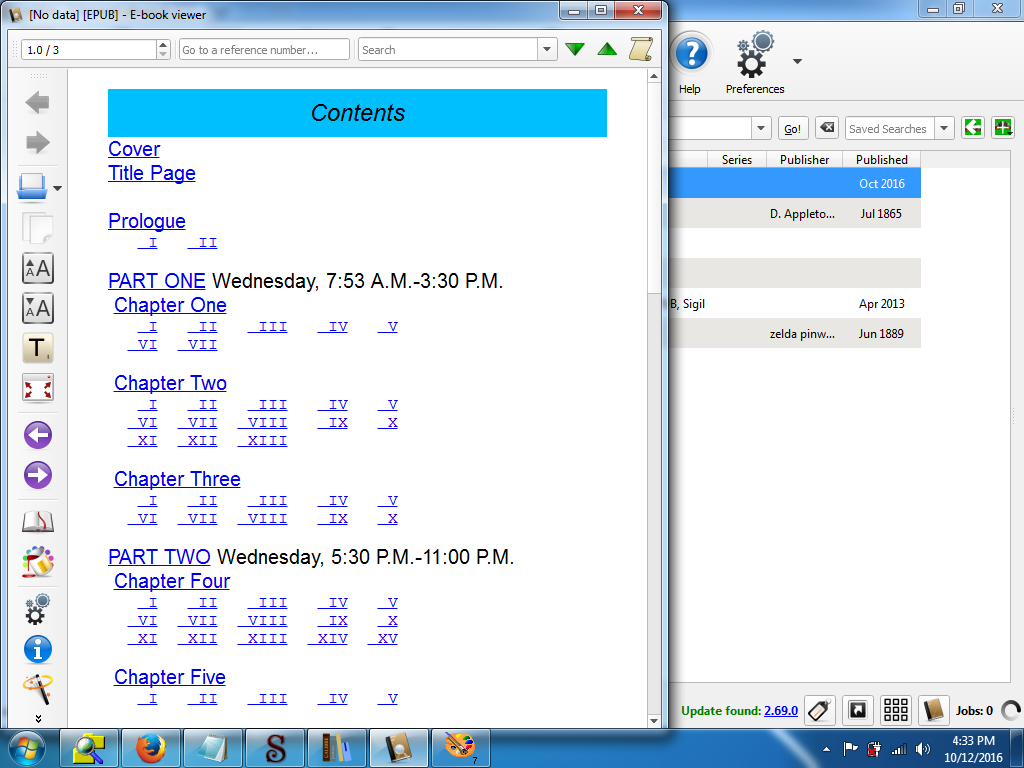

Looks fine to me (and Validates in Calibre sans the missing links)
Block Level tags can not be split. Check your nesting ( pretty formatting visually helps)
<p>
<div> x</p>
</div>
Found it, fixed it. Many thanks!

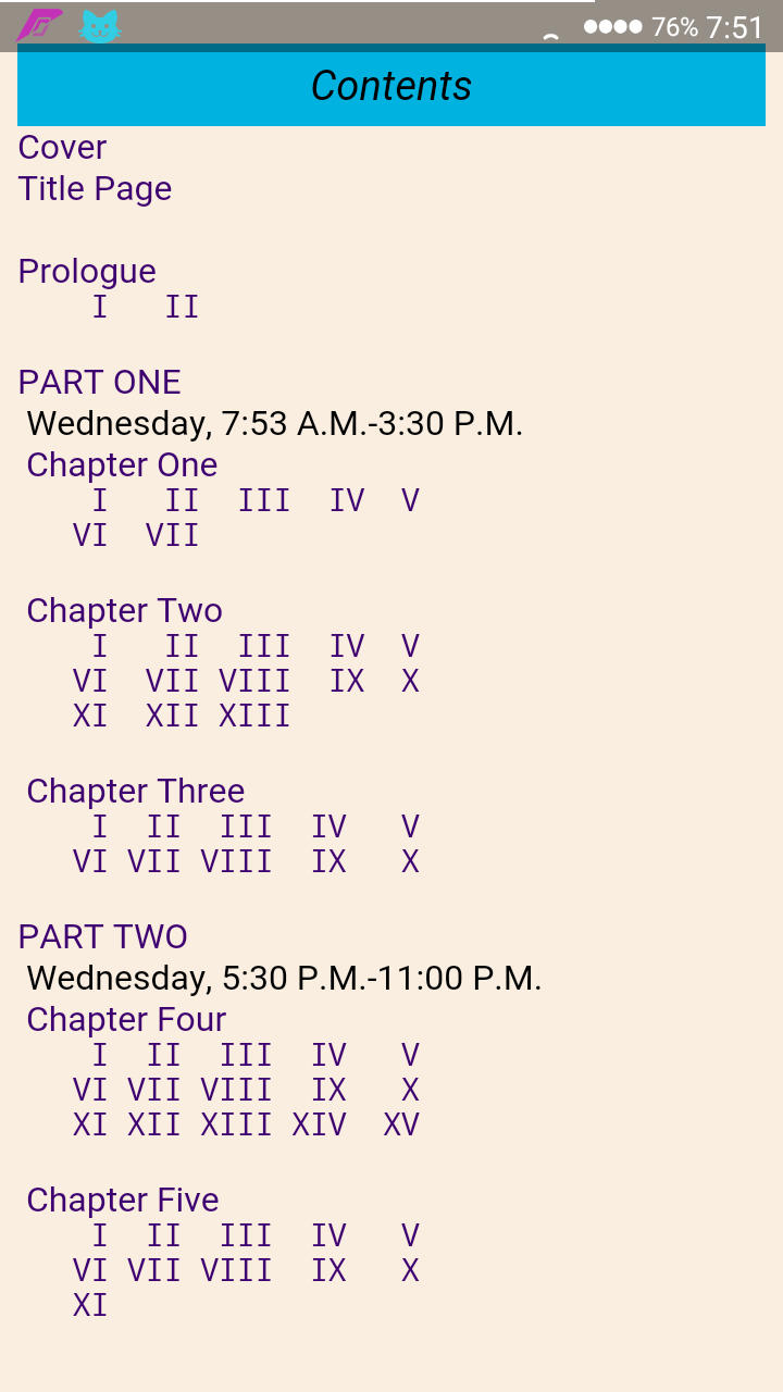

You went to a lot of trouble to make a narrow TOC.
Then you have the 'PART <timestamp>' which made it wide.
Another <br /> needed?
<div>
  <a href="../Text/102-004-001.xhtml">PART TWO</a><br /> Wednesday, 5:30 P.M.-11:00 P.M.<br/>
</div>
Something I'm going to look at--as you can see from the screenshot below, it displays fine in Calibre. What I'm looking for is to keep it as true to the original book as possible, while making it display well on e-reader devices. I'm going to look at the page on my tablet as well as my phone and see if the breaks are necessary.
I was not only designing a slimmer Table, for display on e-readers, but also to align the links visually, as it's shown in the screenshot. When I ripped the table from the book, I neglected to bring my monospace font along, so that didn't display in the one I posted. Have that corrected as well.
I need to check the presentation on both my tablet as well as on my phone, just to see how it renders. If there is an untoward wrap, I'll add breaks as necessary to line it up.
I'm curious, though--did you also experience the problem that prompted the original post, that of Sigil placing an extra line space between the blocks with each save? (Hopefully this question will bring the post more on-topic...)

Code view, except for <pre> pairs,
can have as many blank lines to make it easy
Those are only for Humans to make coding easier.
just like <space><space><space><space> is rendered as one space
BTW Calibre and Sigils view are very forgiving. Check on real devices
theducks is online now

I'm aware of that. This wasn't posted in the form of a complaint, believe me. I know Sigil does a little "housekeeping" on the code with each save, and normally that's a very welcome activity. Just that, with this (probably unique) situation, it was "emptying the ashtrays" to excess. As I said in my post, because of the sometimes...ummmm...questionable power here, I tend to hit the Ctrl+S key frequently. Then, when i go back to the TOC, sometimes I was having to page-down in order to get past all the blank lines that were added. As you stated, it doesn't affect the presentation at all, which was the reason I said it was pretty unimportant.
Boy, that's for sure! Nothing illustrates that better than the four screenshots, all of the same page, below. The ones on my devices were taken from within Gitden Reader; I still haven't found the combination that consistently displays the colored chapter headings from within Moon+ reader--although sometimes it will. That's part of my OTHER discussion in a different thread.
I continue to believe that these are probably the two most valuable tools for e-book creation--especially with the support that experienced users such as yourself are willing to provide. And the price(s) can't be beat!
