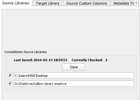

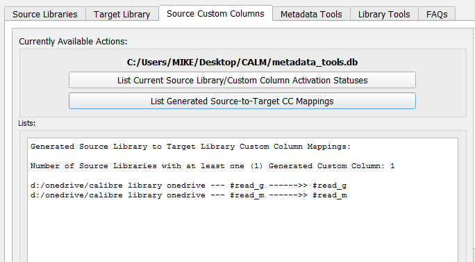

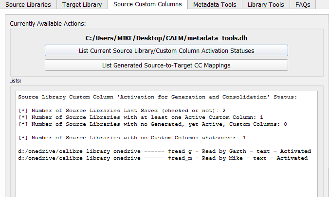

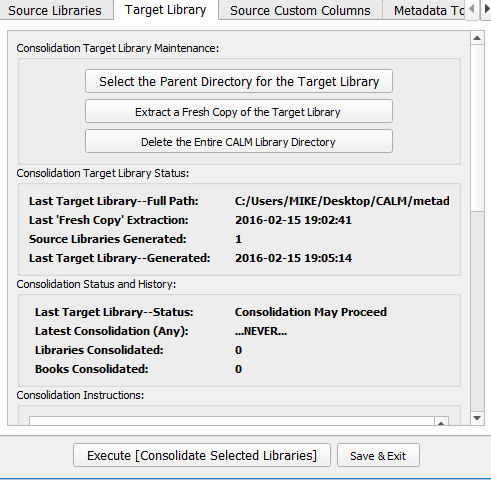

Sorry Mike again I actually managed to get through to the calibre job box this time but get sqlerror: no such table: Source.languages.
Calm is only finding one of my libraries though calibre can read 2 and I typed the address wrong for the second one which I presume will be the "no such table" error
No more time this evening (france) so will renuke and start over tomorrow when I am CALMer.
I have attached the files but if I am right about the error not a lot to see
Thanks for your trouble and sorry for being dumber than usual
Mike

@Mike:
Attaching to New Source Library: C:/Users/MIKE/Desktop/metadata.db
Consolidating Source Standard Metadata: Mon Feb 15 19:06:17 2016
Job: "CALM Consolidation" failed with error:
File "site-packages\calibre\gui2\threaded_jobs.py", line 83, in start_work
File "calibre_plugins.consolidate_all_library_metadata. calm_consolidation", line 94, in main_calm_consolidation
File "calibre_plugins.consolidate_all_library_metadata. calm_consolidation", line 193, in CALM_Control
File "calibre_plugins.consolidate_all_library_metadata. calm_consolidation", line 374, in source_control
File "calibre_plugins.consolidate_all_library_metadata. calm_consolidation", line 392, in source_copy_control
File "calibre_plugins.consolidate_all_library_metadata. calm_consolidation", line 450, in add_new_language_codes
File "c:\cygwin64\home\kovid\sw\build\apsw-3.8.2-r1\src\cursor.c", line 990, in APSWCursor_execute.sqlite3_prepare
File "c:\cygwin64\home\kovid\sw\build\apsw-3.8.2-r1\src\statementcache.c", line 386, in sqlite3_prepare
SQLError: SQLError: no such table: SOURCE.languages
The cause of your problem is very clear. Your Source Library is "C:/Users/MIKE/Desktop/metadata.db" which has no Standard Calibre Table languages. The languages table is the very, very first thing that CALM copies from a Source Library into the Target Library. Your Source Library is not a valid Calibre Library.
By the way, in Windows, the "Desktop" folder is a very special folder. I would not recommend using it as a Calibre library itself.
You need to use Calibre to create a 'real' Calibre Library using its proper menu path for doing so: Right Click the Library Icon> Switch/Create Library > Choose the parent directory which must already exist, and go from there.
Example: "C:\Users\Mike\Documents\eBooks\MyLibraryName" .
Then, switch to that new Library and test it. Add a book to it, and check its functionality.
Click the CALM icon. Refresh the Target Library. Change the Source Libraries to what they should now be, and that does not include C:/Users/MIKE/Desktop . Generate the Source Custom Columns. Then, run the Consolidation.
Note that you can Consolidate a particular Source Library only once for any single incarnation of the CALM Target Library, but that does not mean that you have to Consolidate all of the Source Libraries at once. The checkboxes on the Source Library Tab control which to consolidate at any particular time. The ToolTips say that too. You could try Consolidating only the OneDrive library to see what happens. Based on your attachments, it should work fine. If it does not, apply the Nuclear Option again, and start over from scratch again but using "C:\Users\Mike\Documents\eBooks\MyLibraryName" instead of "C:/Users/MIKE/Desktop/metadata.db".
The reason that only one (1) of your Source Libraries was "Generated" is that you have only one (1) Source Library with any Custom Columns whatsoever.
In summary, the problem is not CALM, but C:/Users/MIKE/Desktop/metadata.db.
Good luck.
DaltonST
Edit: I just noticed that your CALM DB path is C:/Users/MIKE/Desktop/CALM/metadata.db . The erroneous Source Library is C:/Users/MIKE/Desktop/metadata.db . That means that your CALM Target Library is a "child" of your Source Library! That is not ever going to work as far as CALM is concerned. Your CALM Target Library path should be something like: "C:\Users\Mike\Documents\eBooks\CALM\metadata. db"
Last edited by DaltonST; 02-15-2016 at 05:47 PM. Reason: Your CALM Target Library is a "child" of your Source Library

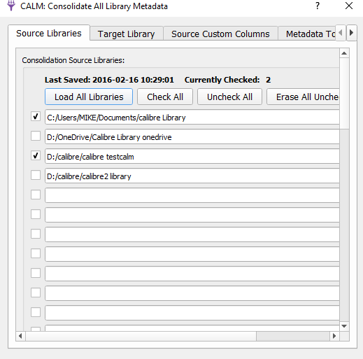

Thanks again. I've been playing around this morning and by just selecting the libraries that CALM finds it works wonderfully. My problem seems to have come from the test library that I created. Calibre reads it fine but CALM doesn't 'see' it at all and when I type it in I get the CALM library error. I installed Job Spy to try and get a log of what happens but nothing shows up. I recreated a test library ticking the copy current library structure box then importing a book and that went fine, CALM found it and everything worked
If you can tell me how to get a file to show what is going on I will be very happy to send it to you.
Also for information, working on my rather small monitor I didn't see the save button on the source libraries screen (see clip) so that may not have helped the first run through although I would still have got the error message due to the library that CALM wasn't seeing.
Many thanks again for a great program
Mike

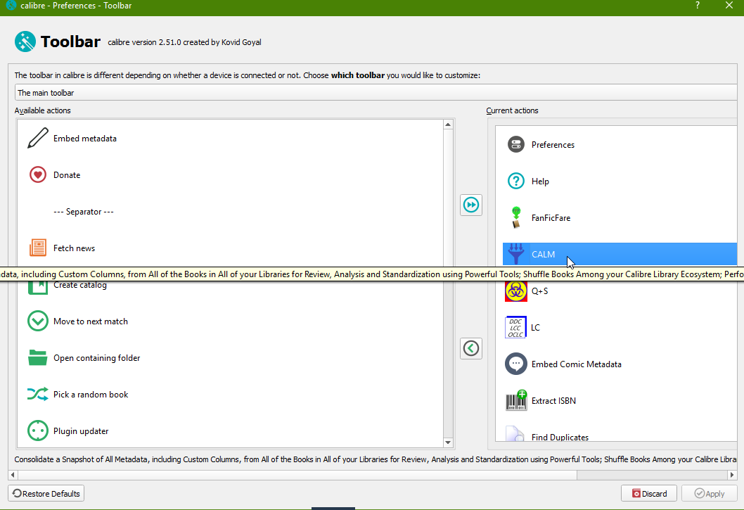

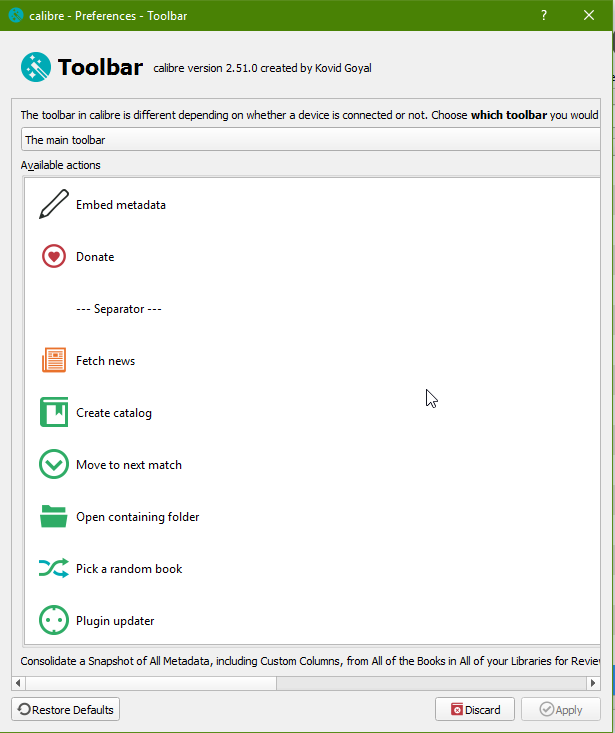

So I came across an issue that causes my Preference - Toolbar to act unusual.
When I mouse over CALM it causes the Available Action to expand
Then even if I expand the Preference - Toolbar it still causes it to expand
Name:	2016-02-19 22_01_22-New notification.png
ID:	146512   Click image for larger version
Name:	2016-02-19 22_01_50-calibre.png

@tekeek - far as I can see, you're seeing what's known as a 'Tooltip'. They've been a standard feature of graphical user interfaces for last 30+ years, hover over almost anything and you'll see something similar. The CALM Tooltip text looks to be longer than most, but that's better than some applications which have none or merely repeat the name.
That it's also shown at bottom of the lists may be a recent innovation - saves the user the bother of hovering
