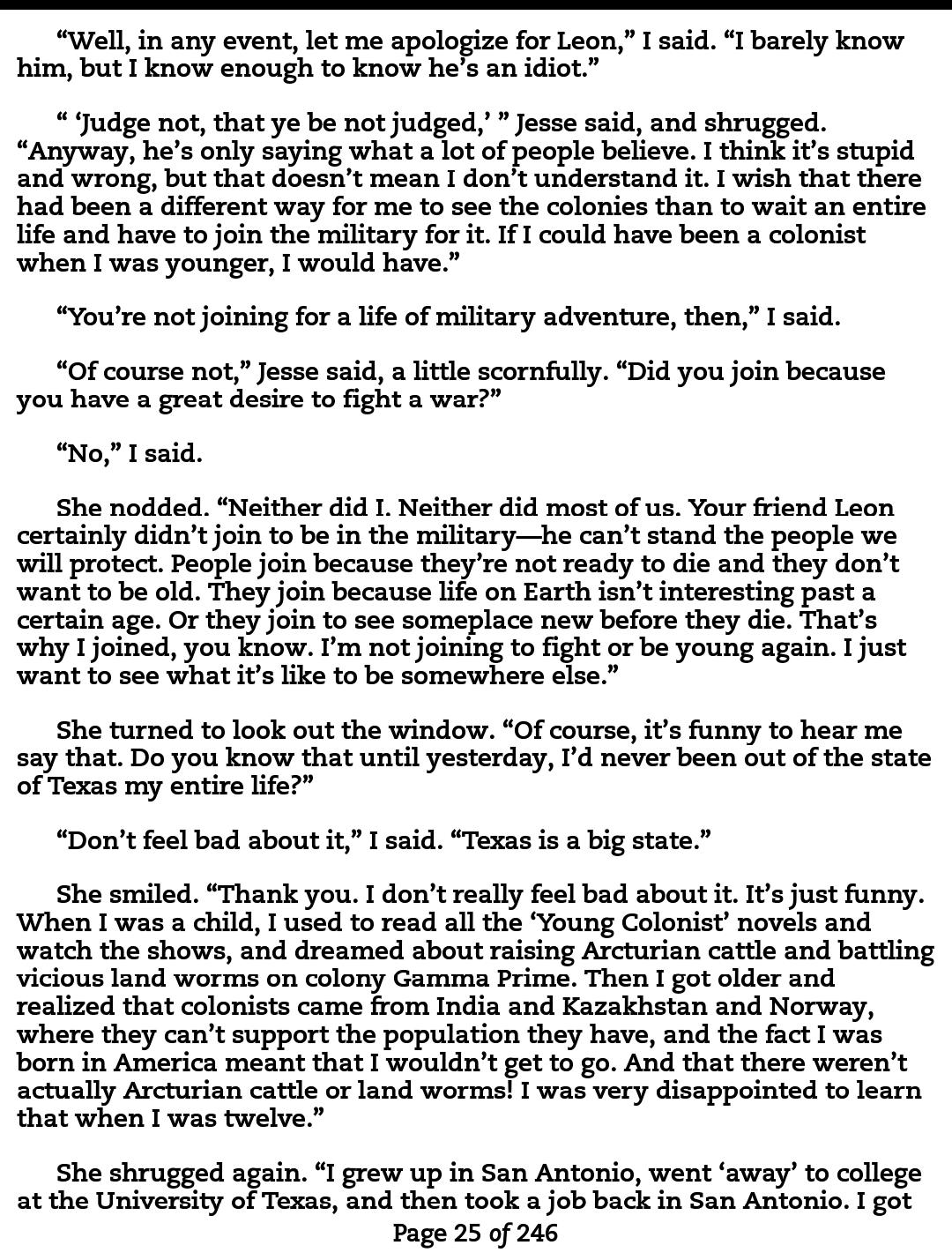

Playing around with the patch file on my H2O, I have settled on the following footer modification:
replace_string = DBDC0D, `min-height: 70px;`, `min-height: 40px;`
replace_string = DBDC20, `max-height: 70px;`, `max-height: 40px;`
replace_string = DBDC3D, `footerMargin: 105;`, `footerMargin: 040;`
replace_string = DBDC58, `font-size: 16px;`, `font-size: 26px;`
replace_string = DBDC6A, `padding-bottom: 0px;`, `padding-bottom:12px;`
replace_string = DBDC80, `margin-top: 0px;`, `margin-top:-5px;`
footerMargin again seems to do nothing but left it how I had it before
I had to increase the padding-bottom value to 12 (removed space to make sure exact character length remained the same) to make sure that the "g" of the "Page" read footer wasn't cut off the bottom of the screen. To get the most lines I could per page at my font settings, I used a smaller height of 40 and a negative margin-top (again ensuring that the exact character length of the code remained the same).
I have also used font-family Georgia for the default footer font.
Now, I am curious, can we specify different font-family from Avenir, Amasis, and Georgia for the footer? How about using a side-loaded font for the footer? Has anyone tried this?

In the previous firmware version Kobo used footerMargin values of 15 for Glo/Aura, 20 for AuraHD/H2O and 40 for other devices. For this version Kobo changed the values to 170 for AuraHD/H2O and 105 for other devices. The example patches just preserve the values set by Kobo in case they are important for something.
It should be okay to use other fonts for the footer, but if the font has a long name then you will need to edit the first replace_string in the patch to make it fit. (those of you familliar with css might want to delete all the examples and just work with the first replace_string line by itself anyway.)
I suggest Avenir or Georgia because these fonts are used in other places in the UI, so they are probably already in the device's memory, but you will have to experiment and see what else works.

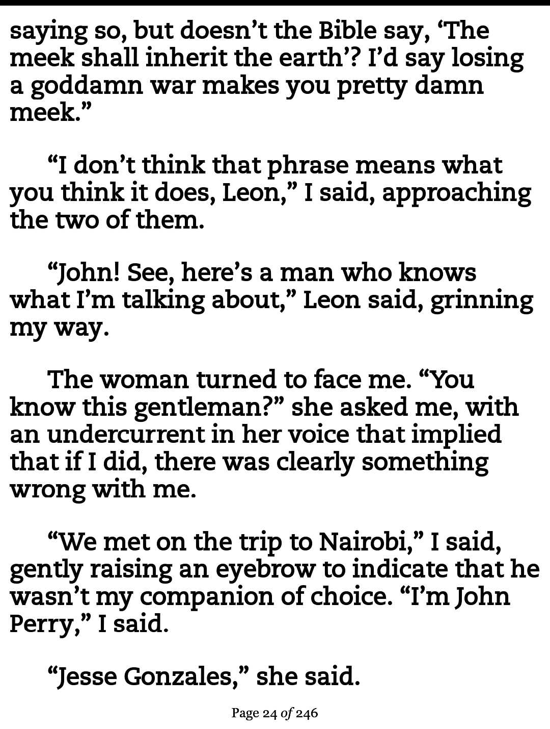

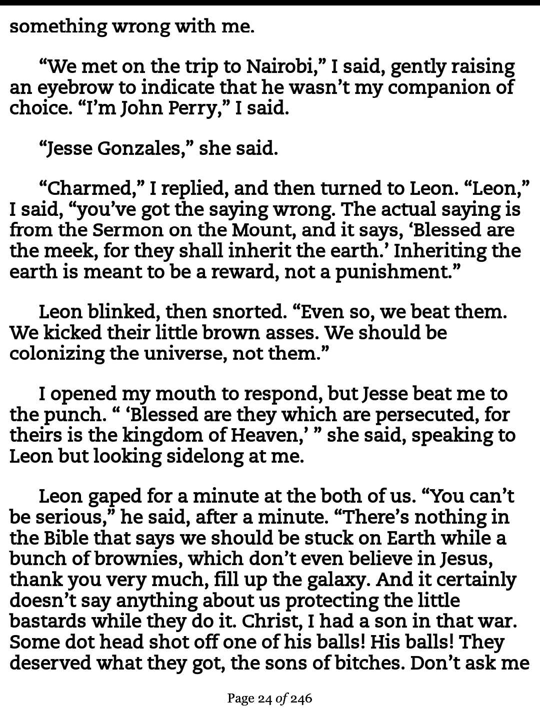

Originally Posted by icallaci View Post
I really like the way this looks, but I have a question: Have you tried this with a larger font size? I seem to remember doing something similar in a previous firmware version, and it looked great when the font was small, but it cut off the tops and bottoms of letters if I increased the font size. Just wondering. Thanks.
I tried it with larger sizes and there was no text cut off. I will attach screenshots of the larger text when I get home and can transfer off the pictures. Edit: screenshots of larger text (Scalzi Old Man War) added.
ID:	130283   Click image for larger version

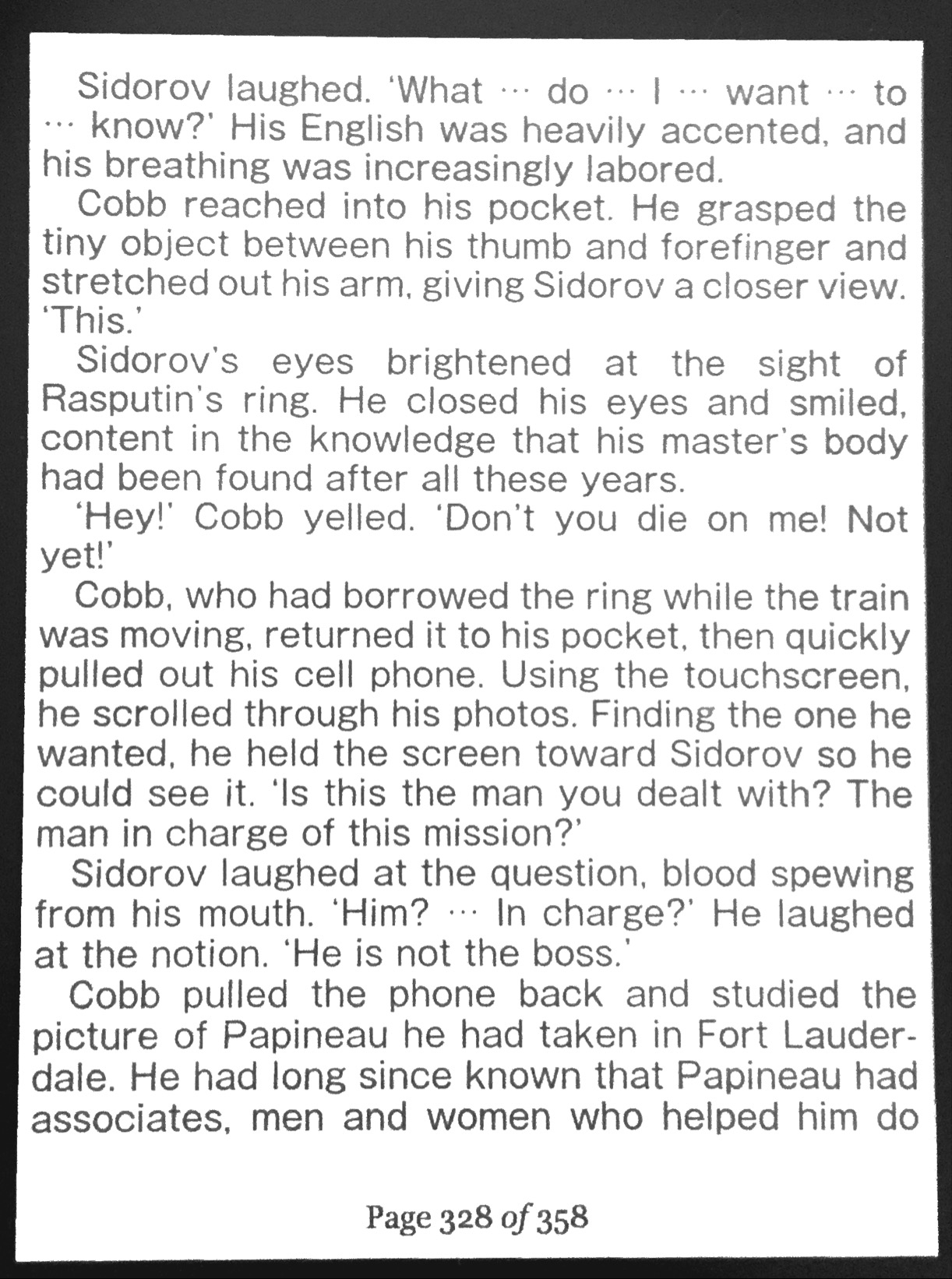

Thanks for the thoughts about changing the footer font. I have now done the following:
Custom footer code for H2O:
and:
replace_string = DBDC92, `/*font-family:none;*/`, `font-family: Delima;`
As per my earlier post, all string lengths carefully kept the same.
To get the font of the footer to match my custom side loaded font, I changed the custom font metrics to "Delima" (you need to use a typography program to do this) and dropped the fake "Delima" fonts into the fonts folder on my Aura H2O. Now, the H2O thinks my custom font is the system font Delima. I also changed the font-family in the footer string in the libnickel patch file to Delima and then patched as per normal.
**I had to refresh the fonts on my device for this to show up properly - I did this by changing the font in the book I was reading**
Below is the screenshot showing the results where both the book text and the footer text are the same custom side-loaded font. This also worked at larger sizes.
A big thanks to all those who helped in answering my questions AND for making it possible to patch my device!
