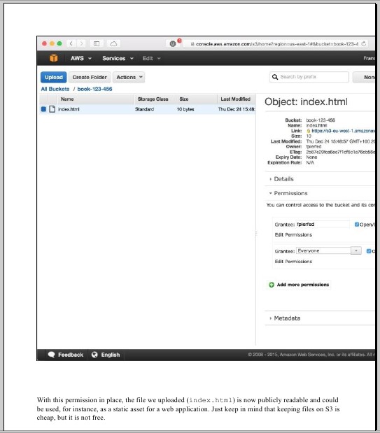

Hi Jellby! Your plugin is good, but I have problem with pictures after convert AZW3 in PDF. Converted PDF files have no full sizes of images (1st picture). Here how must to be correct (2nd picture).
How to fix this?

I can't say without seeing the code, it's probably something in how the size is specified.
How did you get the "correct" picture? If it's from a reader, it could be that the reader is forcing the image to fit in the page, regardless of the specified size...

I resolve this problem with next code (1st picture):
body {
prince-image-resolution: 166dpi;
hyphens: auto;

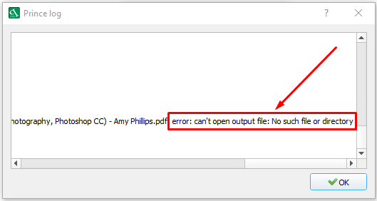

I have error message when want convert AZW3 file in PDF (2nd picture):
prince: loading document: C:\Program Files (x86)\Prince\engine\license\license.dat
prince: Loading document...
prince: loading HTML5 input: text/part0000.html
prince: loading document: text/part0000.html
prince: Applying style sheets...
prince: loading style sheet: C:/Users/User/AppData/Local/Temp/calibre_oyystz/od_htm
prince: loading style sheet: styles/0001.css
prince: Preparing document...
prince: loading image: images/00001.jpeg
prince: loading image: images/00002.jpeg
prince: loading image: images/00003.jpeg
prince: loading image: images/00004.jpeg
prince: loading image: images/00005.jpeg
prince: loading image: images/00006.gif
prince: loading image: images/00007.jpeg
prince: loading image: images/00008.jpeg
prince: loading image: images/00009.jpeg
prince: loading image: images/00010.gif
prince: loading image: images/00011.gif
prince: loading image: images/00012.jpeg
prince: loading image: images/00013.gif
prince: loading image: images/00014.jpeg
prince: loading image: images/00015.gif
prince: loading image: images/00016.jpeg
prince: loading image: images/00017.gif
prince: loading image: images/00018.jpeg
prince: loading image: images/00019.jpeg
prince: loading image: images/00020.jpeg
prince: loading image: images/00021.jpeg
prince: loading image: images/00022.jpeg
prince: loading image: images/00023.jpeg
prince: loading image: images/00024.jpeg
prince: loading image: images/00025.jpeg
prince: loading image: images/00026.jpeg
prince: loading image: images/00027.jpeg
prince: loading image: images/00028.jpeg
prince: loading image: images/00029.jpeg
prince: loading image: images/00030.jpeg
prince: loading image: images/00031.jpeg
prince: loading image: images/00032.jpeg
prince: loading image: images/00033.jpeg
prince: loading image: images/00034.jpeg
prince: loading image: images/00035.jpeg
prince: loading image: images/00036.gif
prince: loading image: images/00037.jpeg
prince: loading image: images/00038.jpeg
prince: loading image: images/00039.gif
prince: Converting document...
prince: used font: Times New Roman, Bold
prince: used font: Times New Roman, Regular
prince: loading hyphenation patterns: C:\Program Files (x86)\Prince\engine\style\..\hyph\hyph-en-us.pat
prince: Resolving cross-references...
prince: PhiAmy\Photoshop_ Absolute Beginners Guide - 15 Ultimate Tips Yootoshop for Beginners, Digital Photography, Photoshop CC)\Photoshop_ Absolute Beginners Guide - 15 Ultimate Tips You Musr Beginners, Digital Photography, Photoshop CC) - Amy Phillips.pdf: error: can't open output file: No such file or directory
prince: Finished: failure
I upload this eBook in AZW3 format.
That could be a problem with escaping/quoting filenames, or some limit in the filesystem. Are you running on Windows?
As a workaround, try changing the title in calibre to something simple like just "Photoshop".
