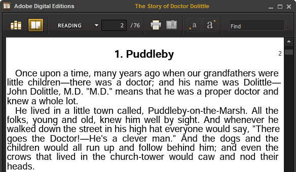

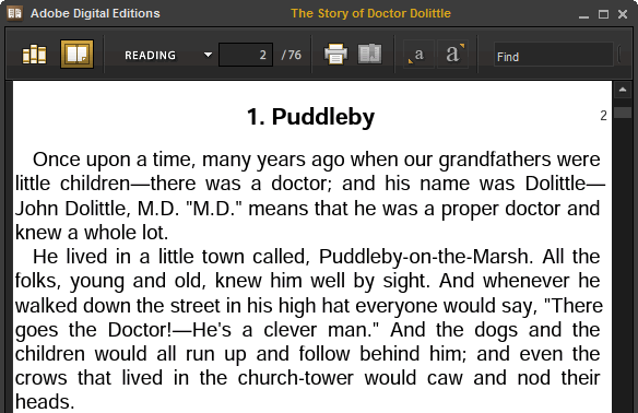

Your assumption is very wrong. You do not get 1.2em on ADE based readers. Most are actually 1.0em and the Kobo is 1.3em. There are no ADE based readers that give a default of 1.2em that I know of. Desktop ADE is 1.0em. So if you do want a specific line height, you have to specify it. But please don't make it 1.2em or higher. Too big. 1.1em might be OK for most people.
This isn't an assumption, it's based on actual results using ADE. Attached pics show a couple of paragraphs in Desktop ADE with paragraph line-heights of: 1.0em, (LH10em.gif), 1.1em, (LH11em.gif) and 1.2em, (LH12em.gif). The final picture, (LHDEF.gif), is that obtained using default line-height, (i.e. not specified) and this is closest to 1.2em.
ID:	105538   Click image for larger version
ID:	105539   Click image for larger version
ID:	105540   Click image for larger version

Unfortunately, that's very much font-dependent (meaning that for some fonts 1.2 will be "too much" and for others it will be "not enough"). It depends on how the different glyphs (letters) are drawn in the containing block. Some fonts have containing block very well adjusted to the glyph shapes, some fonts have lots of white space in the containing block, some fonts have large parts of the glyphs outside the containing block... There's no fixed solution for every font.
(see Figure 5-9 here)
Interesting. Perhaps this shows why there is some difference in opinion in this thread as to what makes a reasonable line-height. My font testing has been limited to those displayed on my PRS-300.
