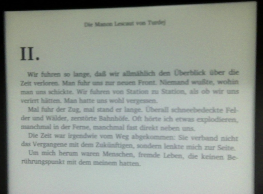

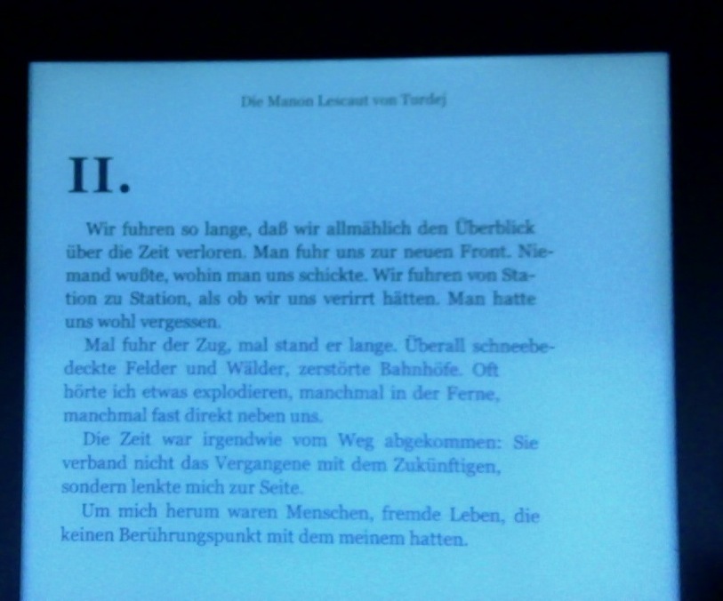

My normal language code should be de_DE. I used that file from your attachement and went back to 1.2.7. That did the trick. Hyphenation is now working.
Strangely however when I add a book now and open it, it shows hyphenated but only to half the page. When I go to Aa and choose Standard and then a Font of my choosing it goes back to full line size. (Hope the attached images show, what I'm getting at.)
ID:	105234   Click image for larger version
That sounds like bug #36. I'd hoped that I could use internal calibre hyphenation, but it doesn't look like that's going to work if languages with non-Latin characters don't hyphenate.
Looks like I'm going to get to have fun figuring this one out
