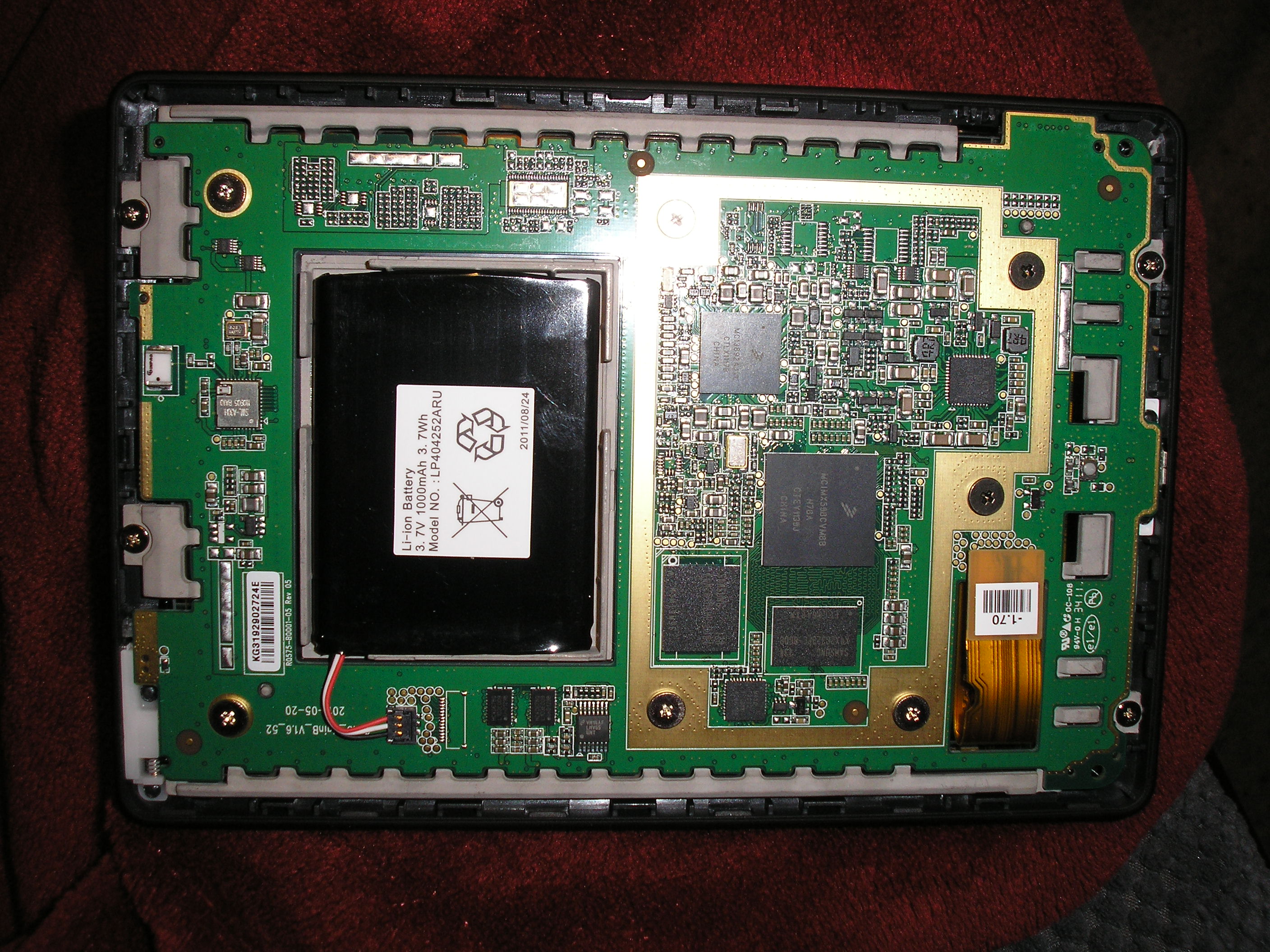

here's a picture of the offender.....not seen anything matching your description nor anything not glued ....

O.o wtf? Is That a kobo touch? Seems quite different from mine..and you don'thave sd card in there....

Look at the date on the battery: 2011/08/24.

Looks like a 1st gen kobo touch...looking on internet seems that the first touch use a memory chip and not sd cards...
